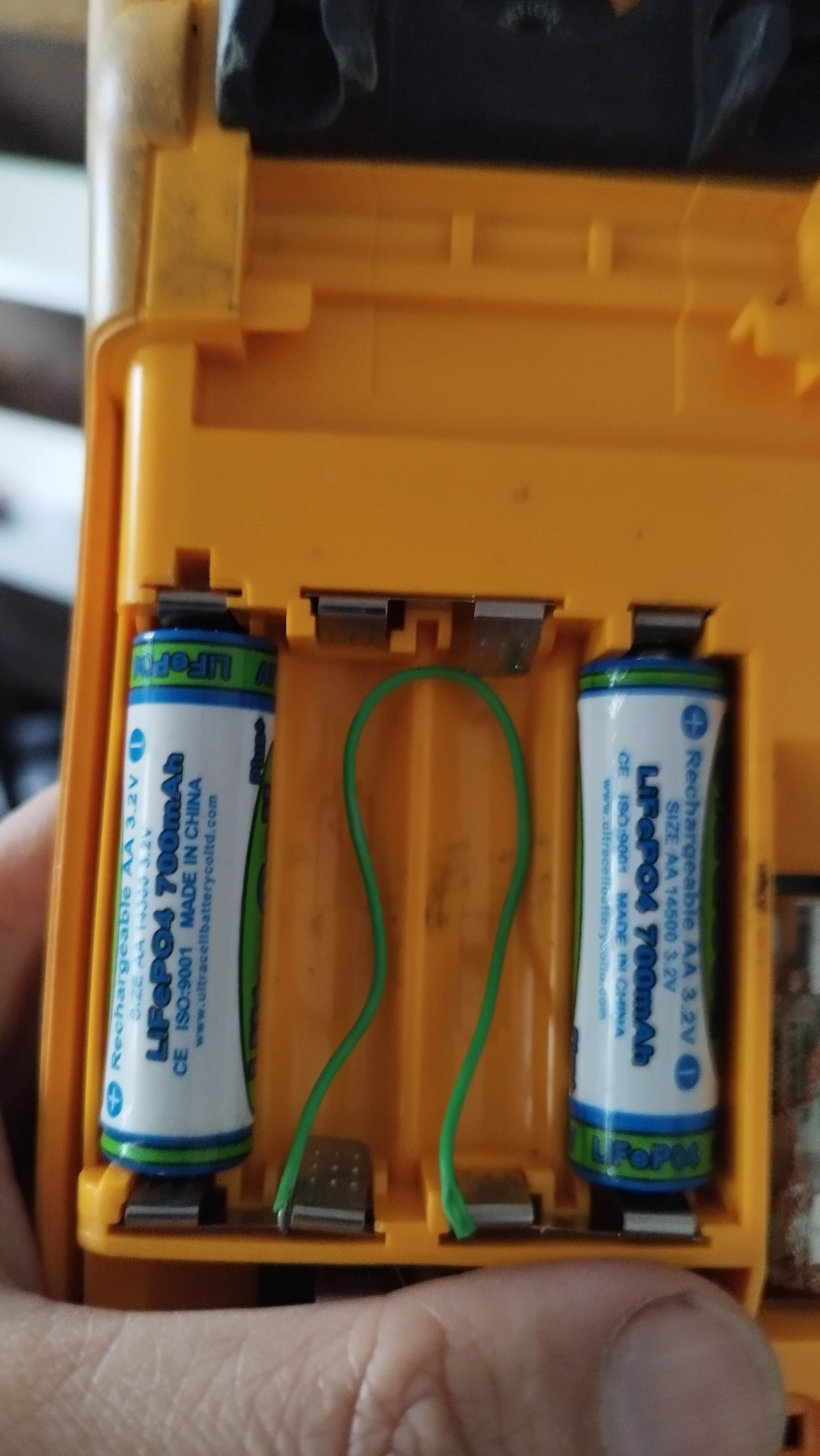

    I've replaced a bunch of AA with rechargeable LiFePo4 cells. These are 3.3V nominal and can replace any pair of AA with a jumper wire. The mAh is not that great on them but they don't self discharge like NiMh.
