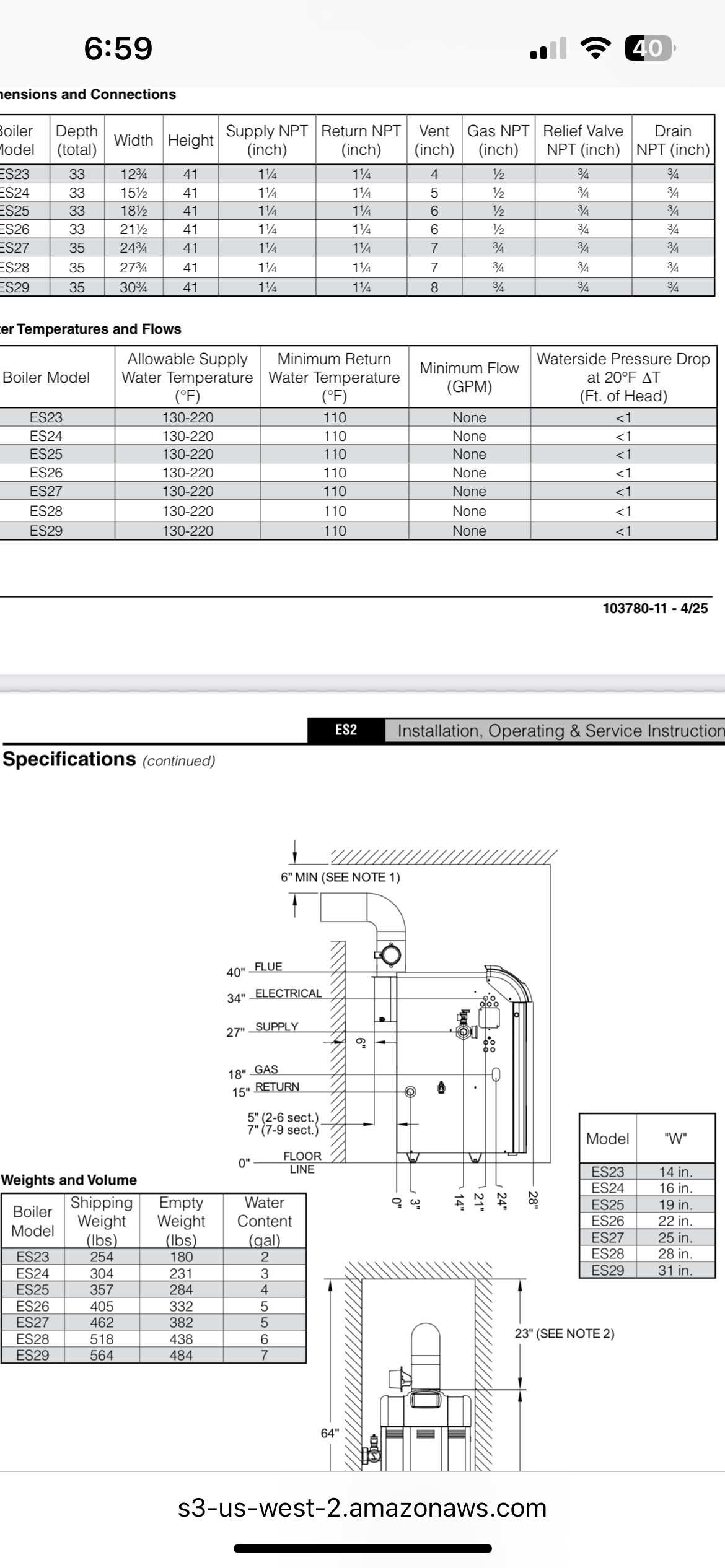

    hot_rod Member Posts: 28,011
    What flow rate or delta did gravity systems operate around?
    This US Boiler ES2 is a low water content, it indicates minimum flow as none?
