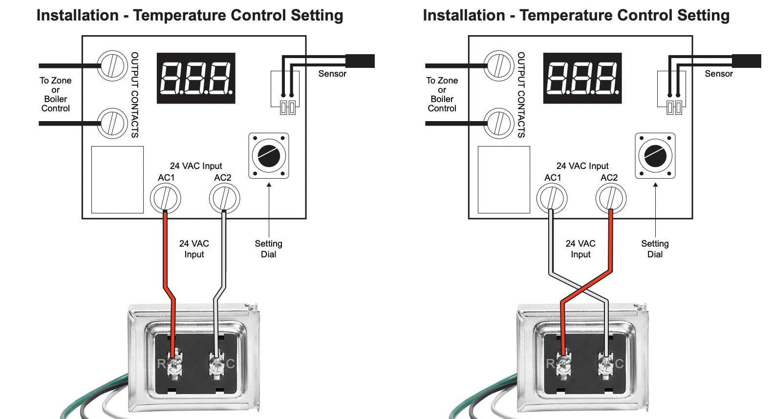

WM CG-6a boiler just replaced BoilerMate (again) and had follow up issues with wiring the new Indirex device. However when connected with TT (24v) power from the boiler and the outputs of the Indirex electronic box to TT of RS 832a relay causes the motor of the GV-6 flue damper to BUZZ.
Ok - so far I’ve replaced relay and just replaced the motor control of the GVD-6.
Indirex calls for heat by closing the TT contacts of the relay and the GVD motor starts buzzing (with damper open) . Boiler never fires although signals yo GVD input and relay output to pumps is working fine..,. just no boiler .

Is the "indirect electronic box" just a 2 wire control, or does it need constant 24 volt power? What is the model of the indirect control.
If the indirect control is just a 2 wire, that goes to TT on the RA832A. XX in the RA832A goes to the DHW or thermostat connection in the boiler.

Looking further into your query, I know what a WM CG-6 boiler is and a CGa-6 boiler is. The CG-6a boiler might be a typo with transposed characters, so I'm not sure of the exact boiler you have, however both have a control transformer. WM part No. 381-356-578 on the CGa boilers and WM part No. 510-312-166 on the CG boilers. both are 40 VA transformers. The GVD-6 is a 6" automatic vent damper made by field controls today but may have been made by Effikal before it was purchased by Field controls. The Indirex® may be referring to an indirect water heater that is made by Amtrol. it is equipped with an electronic aquastat that requires 24 VAC to power the circuit board, and has a set of dry contacts to operate the burner/circulator/zone valve/boiler control to send the heated boiler water to the indirect tank to heat the potable water in the tank.
This electronic control requires a minimum of three 24 VAC control wires but is easier to understand it there are 4 thermostat wires. Two wires to provide 24 VAC to the control and two wires to operate the boiler zone.
When replacing a standard two wire analog aquastat with the new electronic aquastat, there is often times the ability to cross connect the 24 VAC input wires that will cause the Humming noise. Often reversing the wires from the transformer to the aquastat 24VAC Input will reduce or eliminate the Humming noise.
I hope this helps.
