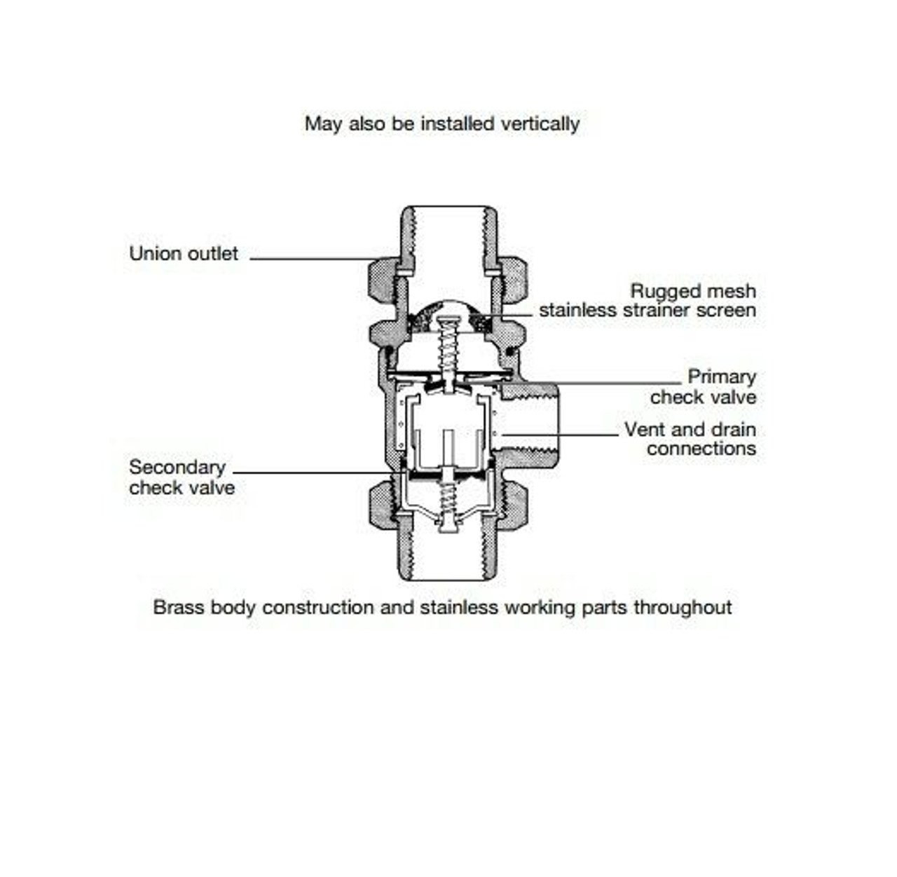

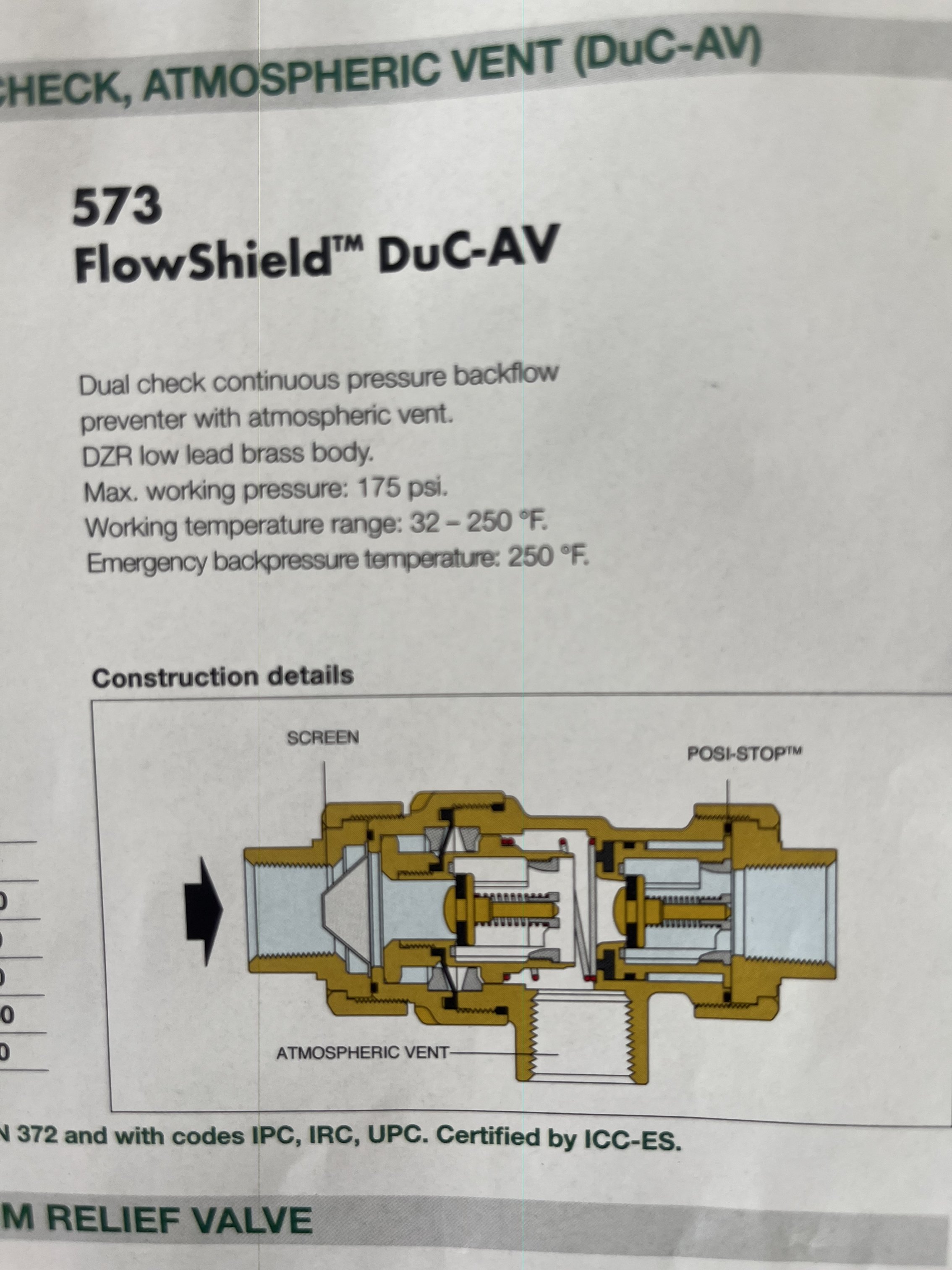

Mainly, I'm just trying to figure if the backflow preventer is bad. However, I'm also just curious on how these dual check valve preventers work. In the video, as far as I can surmise, the leak is coming from the inlet side, which means the main shutoff valve isn't fully sealing when closed. But what I'm really curious about is why the backflow preventer would allow a small amount of water at basically no PSI to pass through the inlet check valve and out the vent, then STOP leaking immediately after I open the main inlet valve and pressurize the line. I have included a diagram for the exact backflow valve that I have, been staring at it for a while and cant totally figure it out. Do the primary and secondary check valves move in tandem or are they independent?

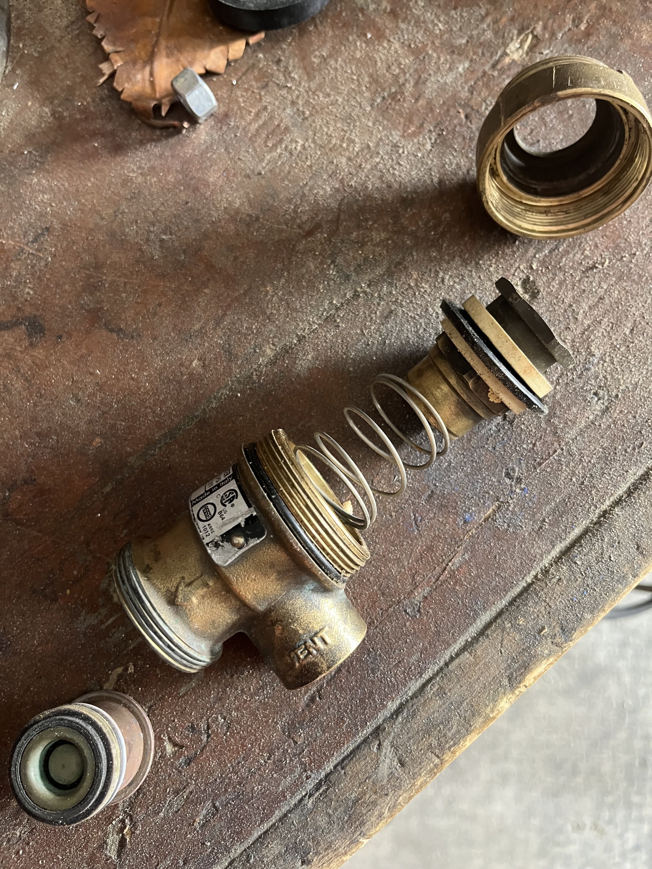

    3 things happen inside that type of check , 3 different springs, snd tensions. incoming water pressure first slides a spool closing off the vent port, this is the weakest spring, next the inlet check is opened, next spring tension, then the second check
    If water drips out the port while pressure is on, probably debris in the spool seat
    The black shows where seals are located in this cutaway, notice the 3 springs
  • AH thank you so much! So in my situation, it leaks out of the vent when i have NO water pressure. So if I turn off the main valve leading into the boiler BEFORE the check valve, and bleed all the pressure out of the line, before and after the check valve, I end up with a small leak coming out of the vent line. This leak is coming from the main valve. There's about 4 feet of line between the inlet side of the check valve and the main shutoff, so initially I just figured it was residual water in that line that would drain out and the leak would stop after a minute or two, but it kept going and filled a one gallon bucket. The boiler itself is fully drained, and I have the shutoffs closed on both the inlet and return sides of the zone valves so I don't have any water coming back down from the system. So the only place it could be coming from is the main shutoff, so it must be 99% closed, but not 100%. No big deal there, easy fix. But I'm just puzzled as to why that tiny bit of water would leak out of the vent.
    Based on your description and the diagram, if the first thing that happens is incoming water pressure slides the spool to close off the vent port, then that should mean the vent port in its static state is open when there's no pressure, correct? If so, then I guess a tiny leak that has basically zero pressure wouldn't be enough to slide the spool and close the vent port, therefore would just end up leaking out of the vent. But as soon as I add pressure, the spool closes and no more leak.
    If that's correct, then I guess the check valve is operating fine, just need to fix or replace the main valve so that it fully closes and eliminate the small leak leading into the check valve and ultimately out of the vent port.

    If the main shutoff up stream is not sealing 100% and there is not enough flow or pressure to slide the spool over the vent, AND something is stuck in the first check, then you would see a drip coming out the vent. It's actually doing it's job protecting the system against a failed check.
    Rust, sand, teflon tape, etc in a check valve can cause a check to not seal.
    Generally there is a small strainer in those small dual checks, but it does not catch all the small particles.
    They are fairly simple to disassemble and check/ clean, to large nuts remove all the guts.
    However if it is old, 10 years or more the o-rings and seals could be deteriorated or nicked. Time to replace it, it is an inexpensive safety device that protects you homes water supply.
