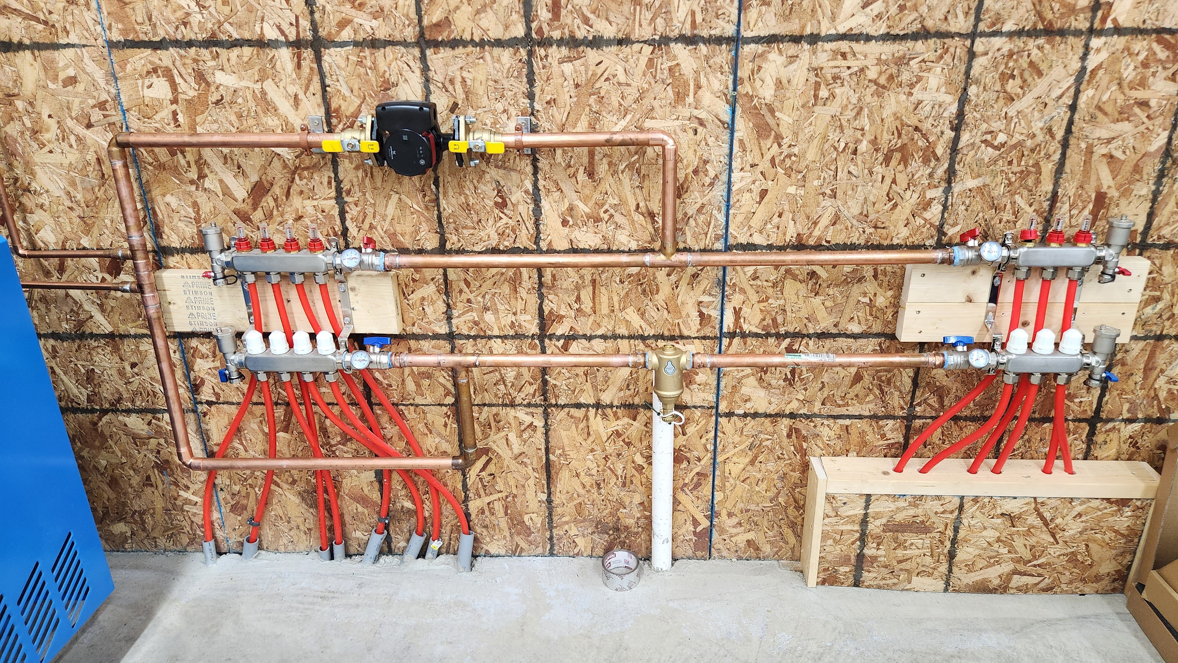

Help setting up variable speed injection mixing
I had an earlier thread about hooking radiant up to a Buderus cast iron boiler. I want to thank all that contributed the wealth of information and options. I knew exactly zero about boilers or hydronics a few weeks ago and have come along way.
I figured I would start a new thread since I've picked a direction and got started building the system.
After weighing all options and comparing costs vs functionality and efficiency I decided that the variable speed injection mixing would be the best way to go, and I think I ended up pulling it off for well within my budget range. I sort of combined several ideas together and some of my own.

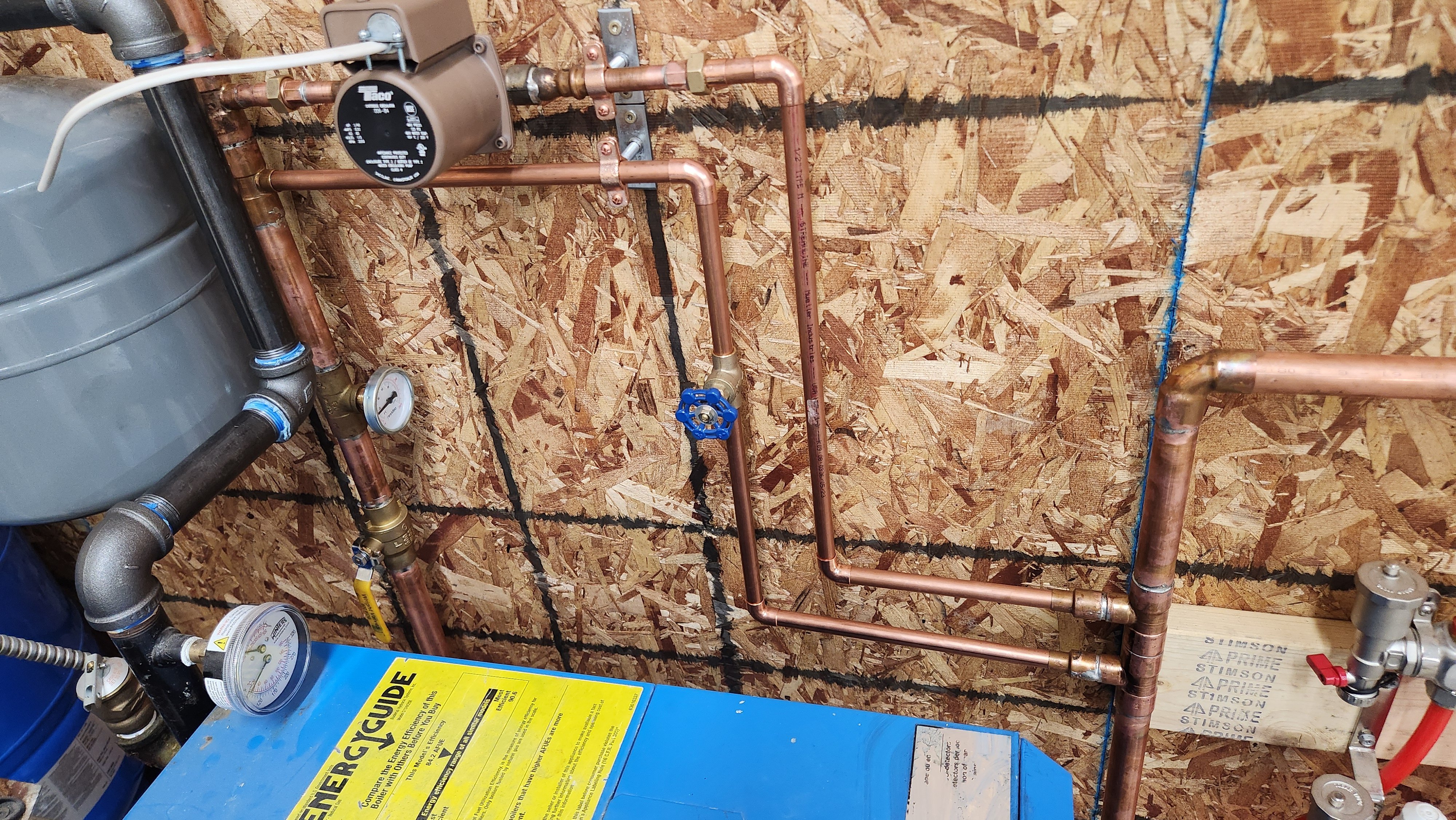

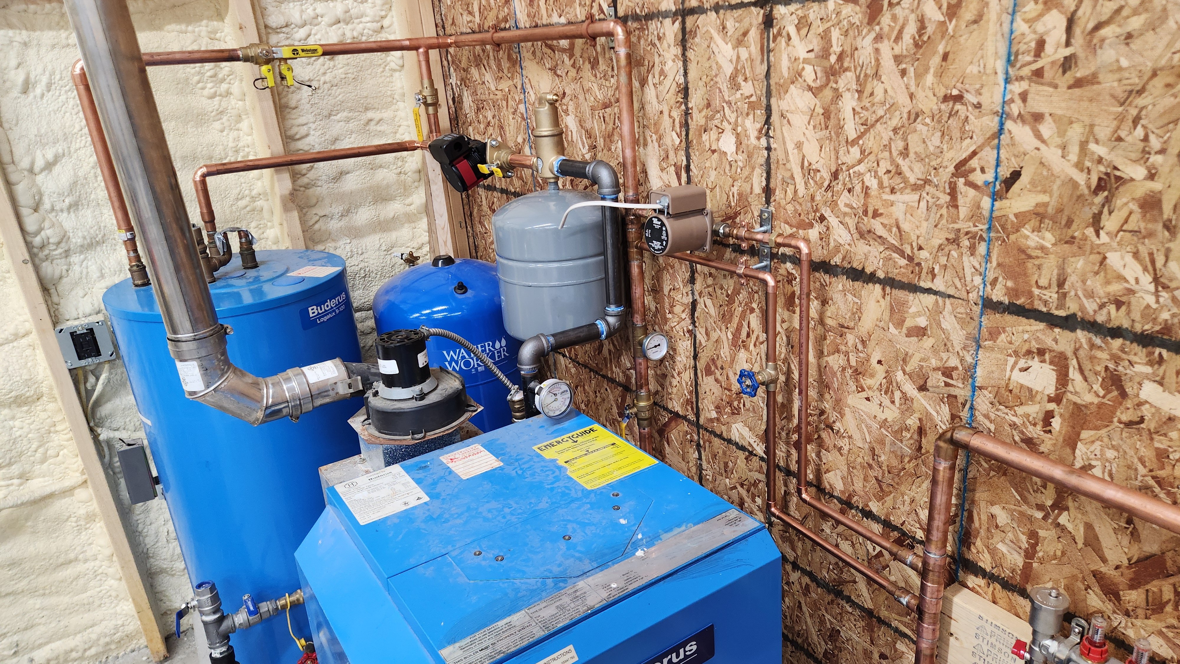

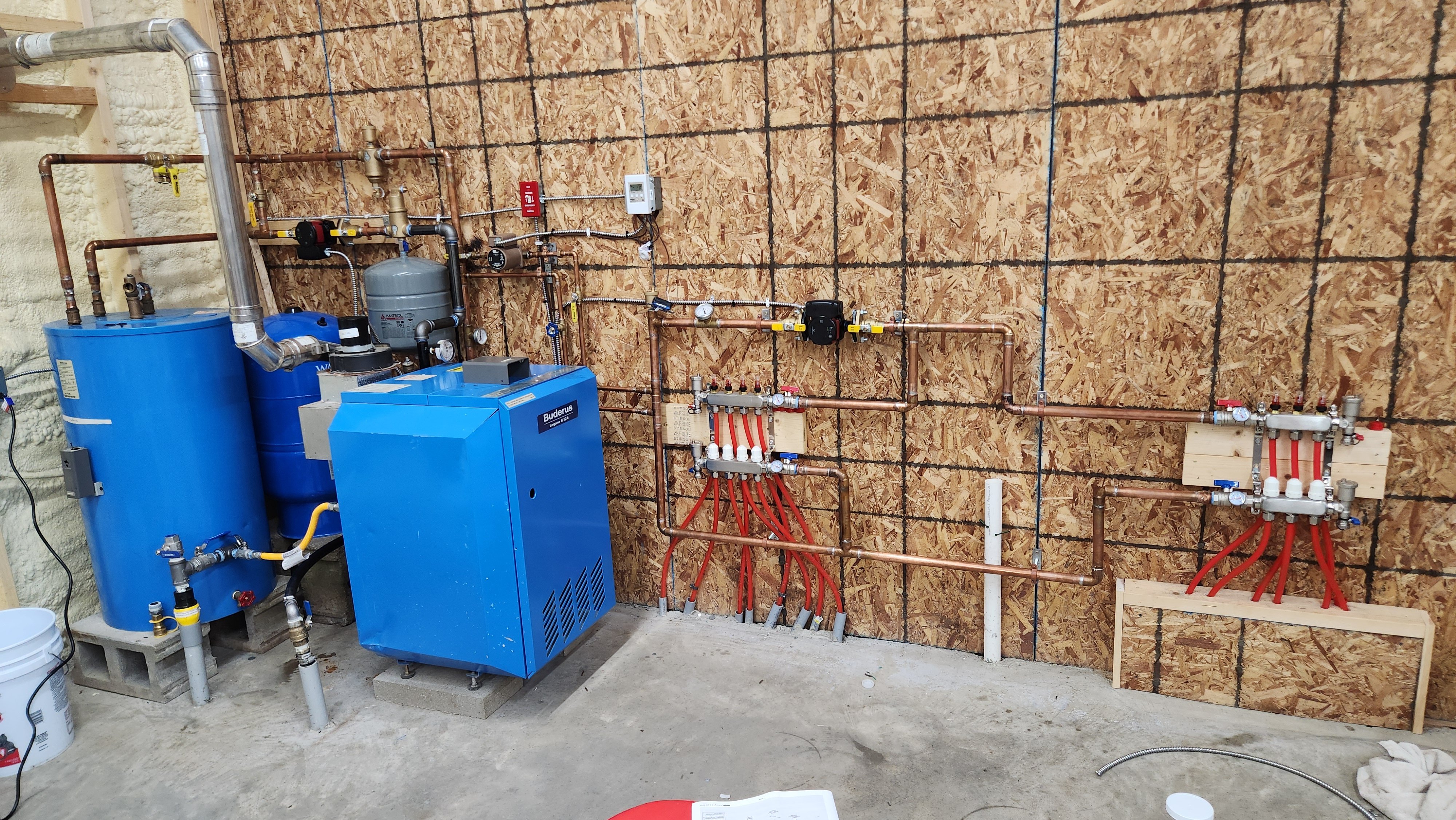

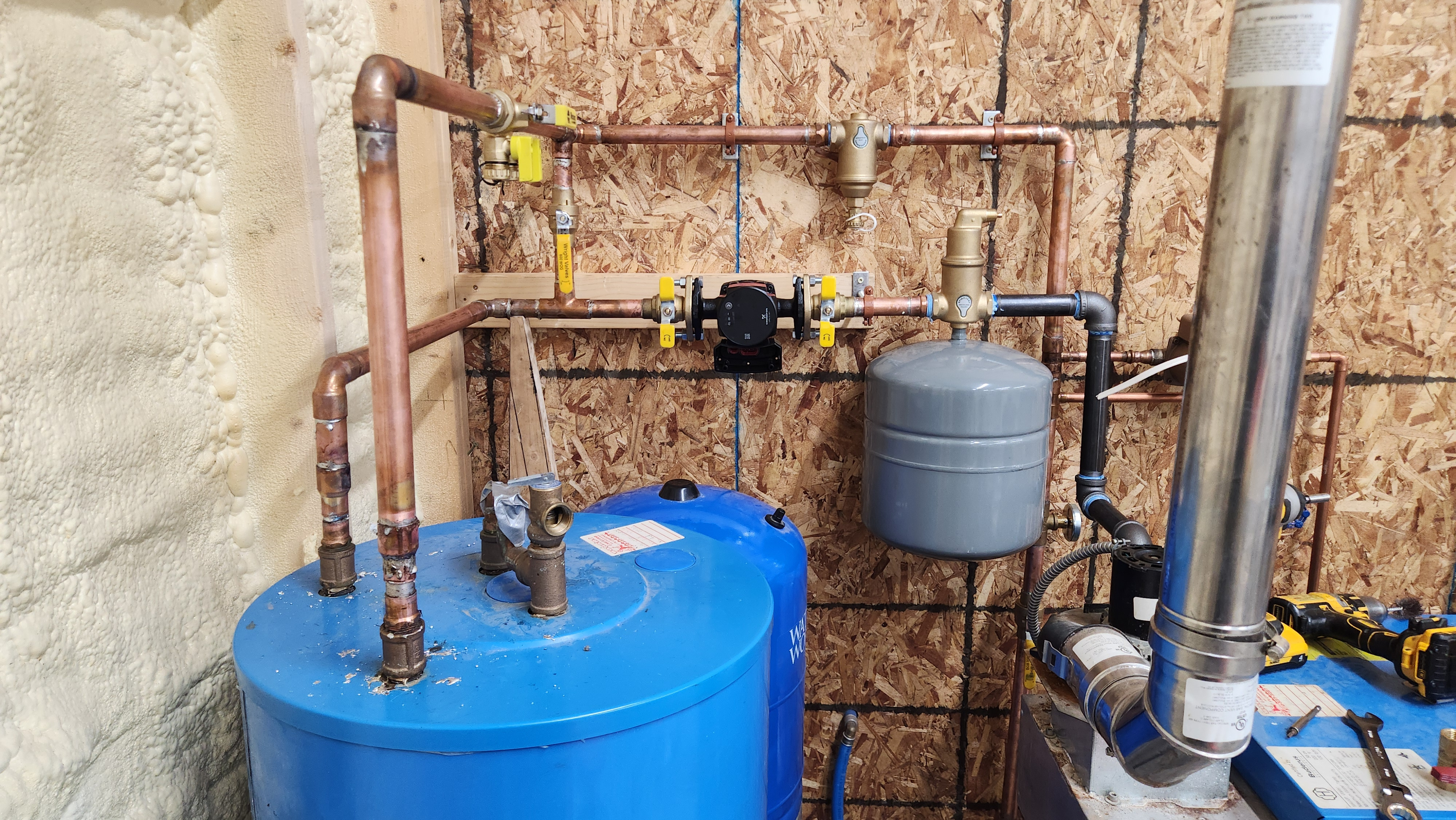

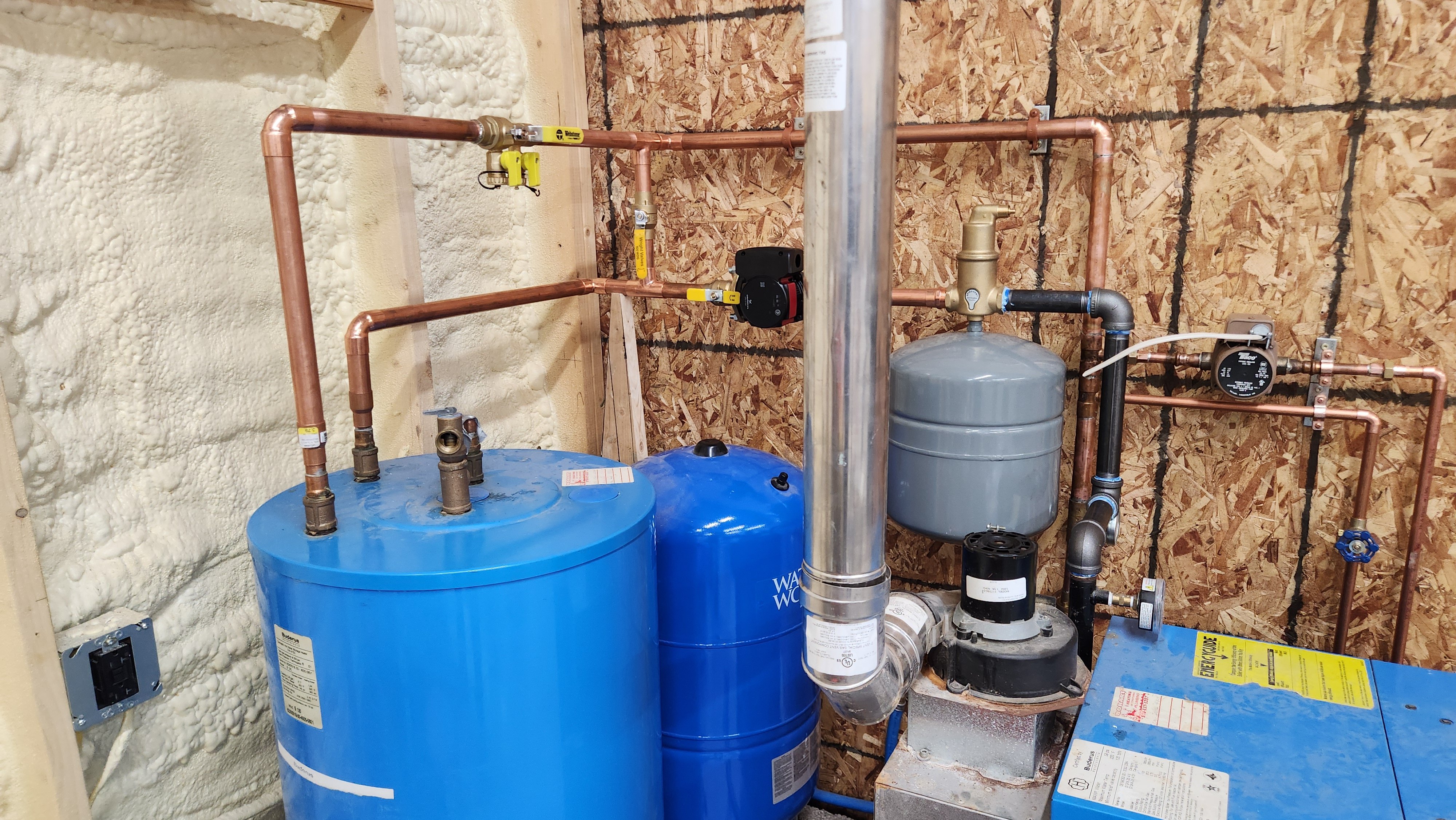

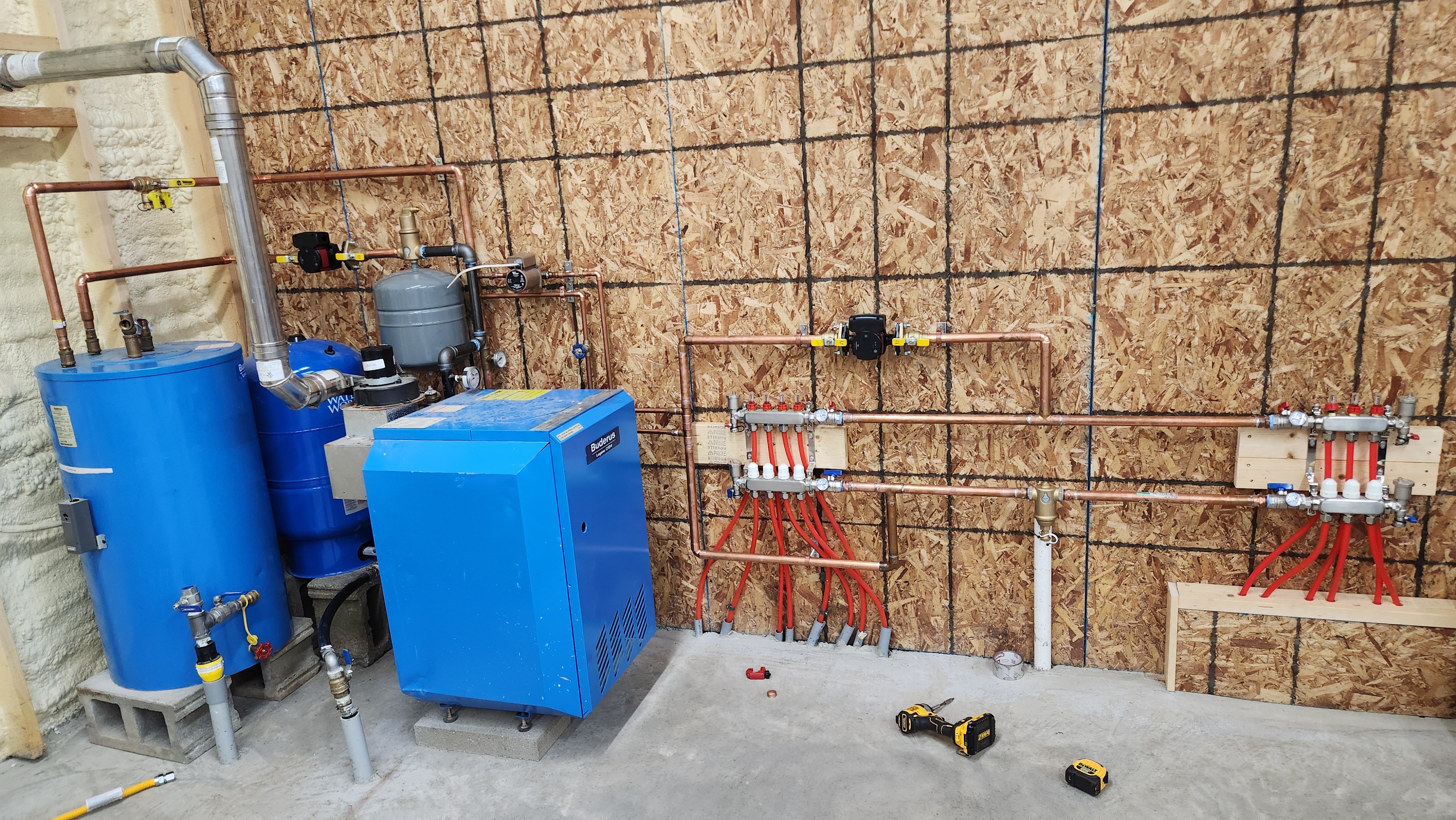

Here are some pictures of where I'm at. I've only soldered the structural parts to be able to dry fit everything together so at this point so it could be reconfigured a bit if anything looks way off.
I have the indirect in the primary loop to act as a buffer, and also put in a bypass that I can either completely bypass it or mix incase there is not enough flow through the indirect.
Both the shop and living area are on one zone and I figure I can just throttle with ball valves to see how things go for now.
My biggest question this point is about the injection pump. Tekmar has a table of specific pumps and how to set the required flow rate with globe valve position. @hot_rod brought up the issue of finding a small enough pump that could operate at a low flow rate. I found this Taco 006 pump locally for cheap which I think should work if I can get things tuned correctly. It's not in Tekmars table. How do I go about that?
1000005811.jpg 1000005808.jpg 1000005806.jpg 1000005803.jpg 1000005804.jpg 1000005807.jpg
  • I would use the settings for a 007 and you’ll be close enough, unless you can dial it in with a flow meter.
    You should use isolation valves on the injection circ.
    Whatever you have between the two manifolds is wrong. It’s only going to see flow from one manifold.
    How are you controlling the injection circ? With the right control you’ll be able to monitor the performance of the injection circ. IOW if you see it ramp up high and stop, quickly short cycling your flow/speed is too high. If your circ is running full speed, and your temp sensor shows temperature dropping, not enough flow/speed.

    Will add some isolation valves around the injection pump.
    I wasn't entirely sure on the manifold piping. My thought was I could use the ball valves on the manifolds to balance the flow between the two. Would that not work? In the middle of the bottome pipe is a dirt separator, the picture may look like it's connected to the PVC drain pipe behind it but it's not.
  • You don't need the separator in that location, and it's only seeing return water from one manifold. You'd want it in the boiler loop after the water feed.
    You want to balance the flow on the injection loop circ to account for total btu's needed in both manifolds. You really want enough flow/heat transfer to keep up with the manifold requirements on design day. The control pretty much will come on/off/ramp up and down, based on the connected temperature sensor strapped to the pipe.
    You use the valves on each manifold loop to balance the flow/btu's for each loop.

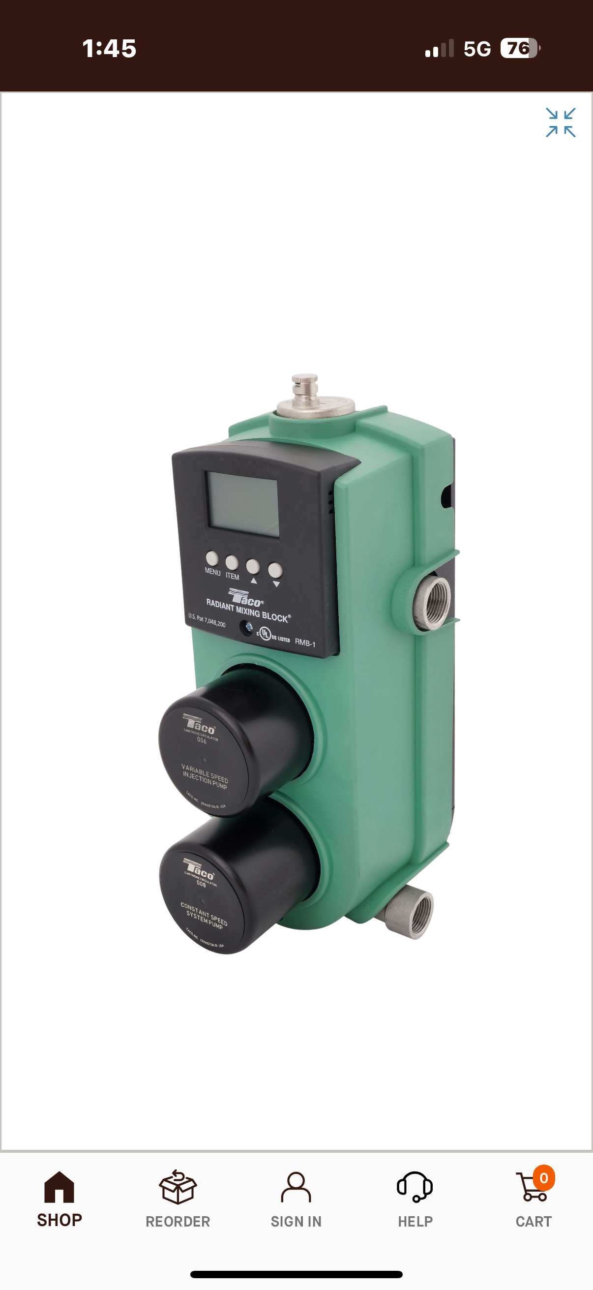

  • It may be too late, but I’m impressed with the Taco Radiant Mixing Block for injection mixing. Expensive, but so easy to pipe and program.

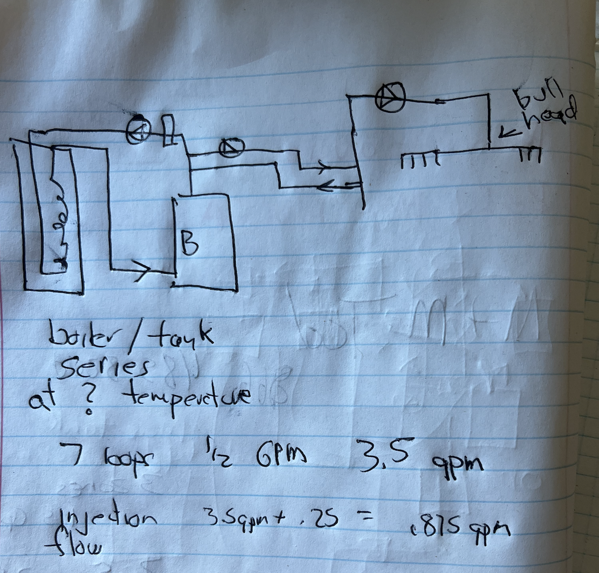

    As I see it you have the boiler piped in series with the indirect, correct?

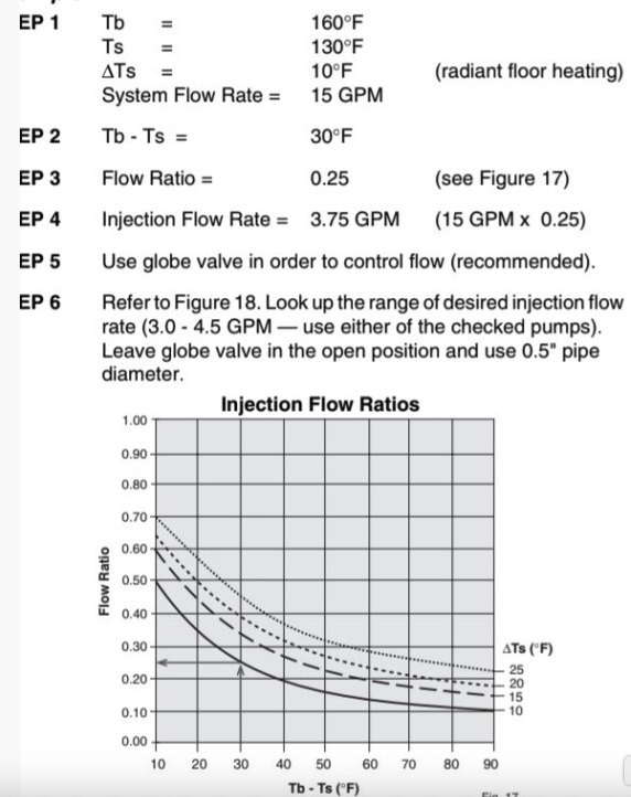

    So that tank needs to be maintained at a temperature to provide the injection mix.
    Use the tekmar example showing the boiler running 130/ 160°
    So the tank will reach @ 160°, correct. Protect the DHW from leaving the tank at those temperatures!
    Now on a call for heat the boiler pump needs to run, as it supplies the needed temperature across the close tees for injection. There may be times that boiler pump is running but the boiler is off, as the tank is hot enough to supply heat. So some of the tanks heat at maybe 160° is going through the boiler.
    The radiant pump also needs to run, so 3 pumps need to be running to get heat.

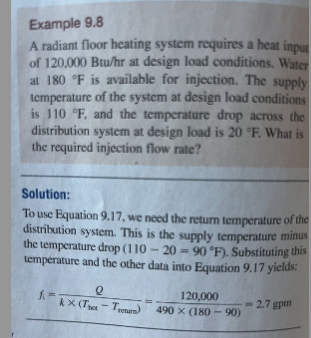

    I see 7 loops of 1/2" pex. Typically we design for 1/2 gpm per loop, so you have a 3.5 gpm required flow with all loops connected. If you close off or zone off 4 loops the gpm requirement is 1.5 gpm. (short cycling will get worse not better if you zone the system)
    Plug those numbers into the tekmar formula, looks like a .875 gpm injection flow required.
    This example is for a system with 15 gpm system flow, I think you are around 3-4 gpm?
    If you have not soldered yet, get rid of the bull head tee on the manifold piping.

    This injection formula, from Modern Hydronic Heating is a bit more precise
    you have a 40,000 load, boiler at 160? supply radiant at 110, return at 100° (10°∆)
    40,000÷ 490 (160-100) 1.3 gpm
    Without a load calc and design I'm guessing at the load and required SWT to the radiant

    Yes the boiler is piped in series with the indirect just as your sketch. There is also a bypass to either bypass the indirect entirely or do a mix. I figure I could use the same piping to zone the indirect off with a circ in the future if there's a need.
    As far as getting rid of the bullhead tee in the manifold piping, what do I put in place of that?

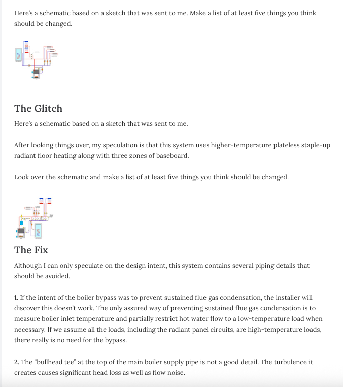

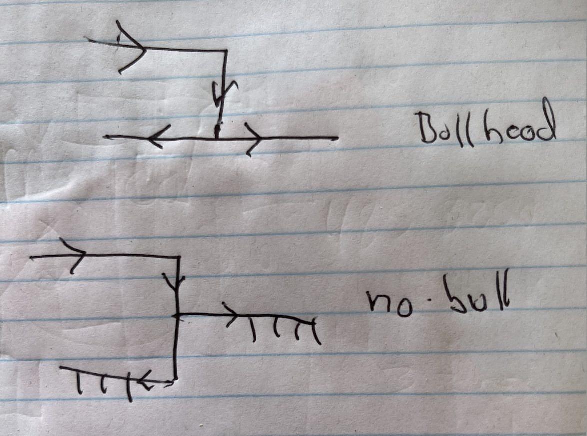

    plenty of discussions over the years regarding bullhead tee installation, some steam some hydronic. ME a former hydronics instructor explained it well here.
    Caution..... Educational Rant ahead....
    Bill, One of John Siegenthalers very first articles had to do with the use of bull head tees in a closed loop circuit.
    It causes hydraulic imbalance because the direction of flow, and subsequent pressure drop, which affects flow continually changes. Not good.
    Lets say you have 10 GPM going into a bull head tee, with each branch of the tee requiring 5 GPM. As the water starts flowing initial, it seeks the path of least resistance. As more water starts flowing through branch A, the pressure drop in branch B becomes less, and it becomes MORE in branch A, so the flow slows in branch A and increases in branch B, until it's pressure drop increases, then it starts all over again.
    Remember, water is wet lazy and stupid, and has a really hard time making up its liquid mind. If you had balance cocks on each branch, you MIGHT be able to somewhat stabilize the flow, but it would be tricky. The code use to disallow the use of bull head tees in hydronic systems, but due to inspector confusion over primary secondary piping, and pumped priority, they abandoned that clause of the code completely 2 code changes ago.
    The ideal way is to split flow to two branches by drawing from the run and the bull. This way, the hydraulics "lock in" and flow remains stable, until interrupted by a zone control device. I've actually felt the back and forth surging associated with bull head tees using the OHHhhh AHHHhhh method. If you had flow meters in each branch you'd be able to physically see it.

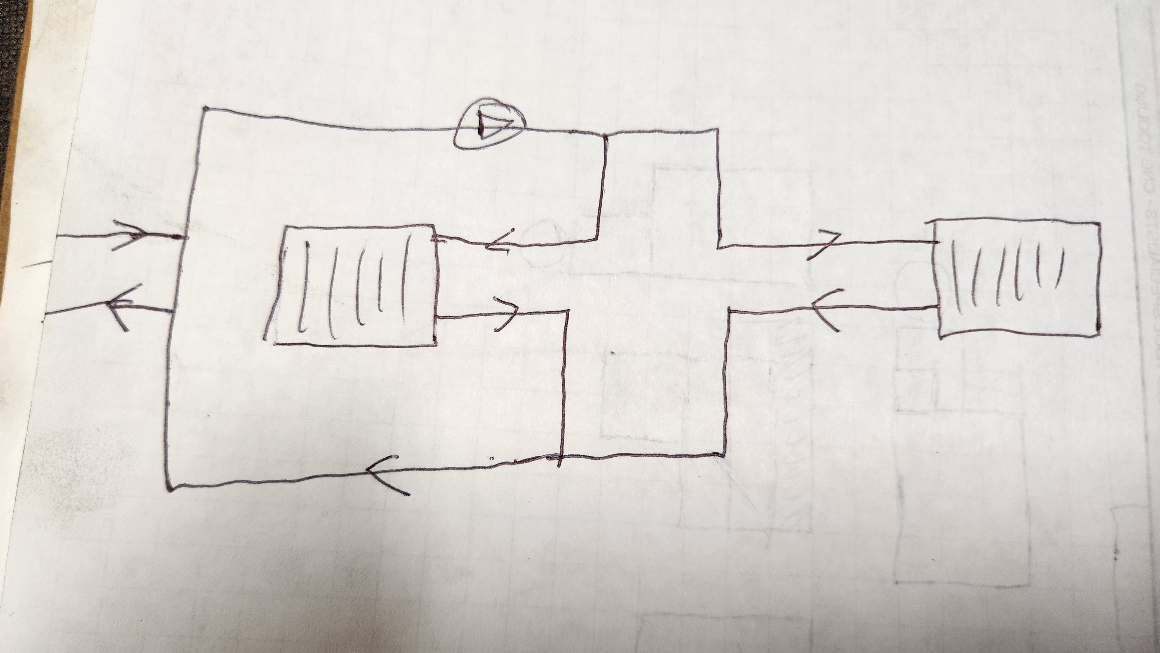

    Got it. Makes sense now. I guess I was piping with the thought process of an electrical circuit which is more up my alley.
    Is it ok for the manifolds returns to both be running into the runs on the tee or should I try to configure that similarly? Sort of a reverse bullhead if that's a thing...
  • Maybe like this?
    hot_rod Posts: 28,699
    There are places where a bullheaded tee piping cannot be avoided, like the injection mixing tees. But to avoid them when possible on other piping.

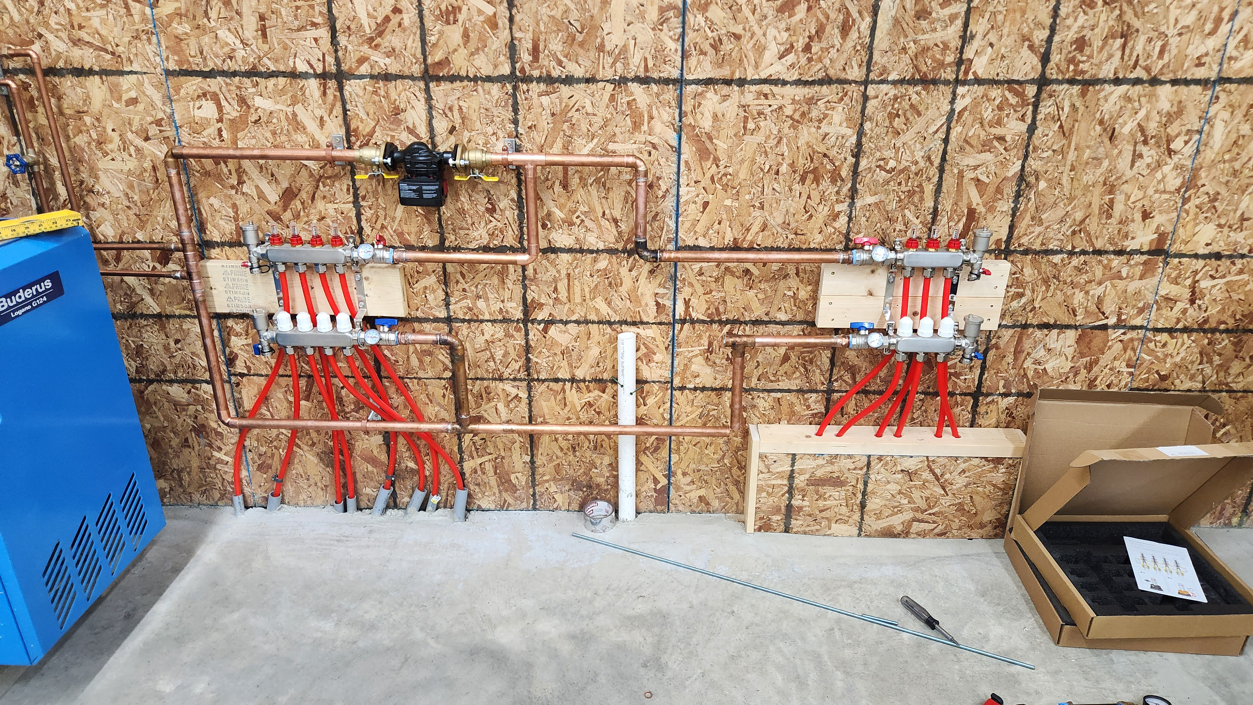

    Ok I did some rearranging to get rid of the bullheads and relocated the dirt separator to the boiler loop and have that side all soldered up. Need to pickup a couple more elbows, I plan to finish the plumbing and soldering on the system side tonight and pressure test. I have some automatic air vents to put at the high points.
    What can I use to flush out the system from flux and and other junk before filling with glycol? It looked like the boiler itself could also use a cleaning there was some bright orange/brownish looking mud in the return when I pulled off the old pipe that was on it.
  • Kaos
    Kaos Posts: 1,003
    Looks much better. I would still put something like a Taco airscoop right before the floor heat pump to allow for simple bleeding of the setup. The floor heat pump should also not point down, you want the motor shaft always to be horizontal.

    Oh yeah thats just a dry fit the circulator turned down on me when I was rearranging the pipes, shaft will be horizontal when it gets soldered.
    My plan was to put a tee where the elbow is before the floor pump with one run pointing vertically with an auto air vent on it. Would that work or do I need the scoop?

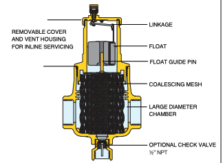

    Caleffi air and dirt seps use a composite screen to deal with glycols best. Very easy to disassemble and service.

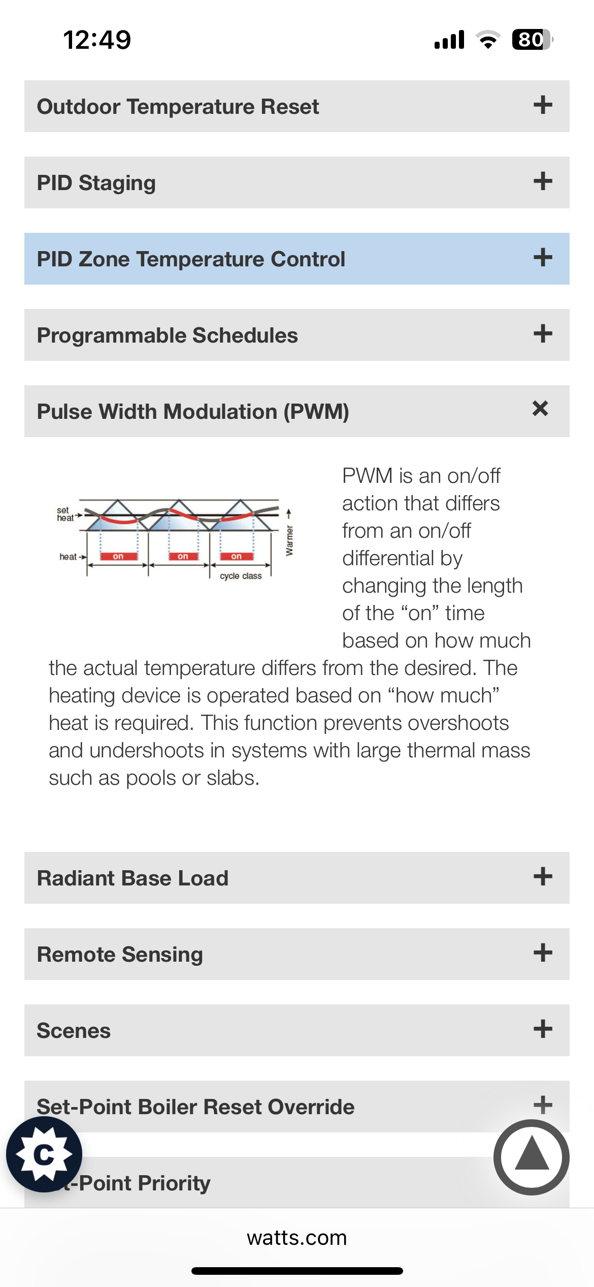

  • I haven't purchased a thermostat yet, from what I gather with the slow response of a radiant slab it's basically a "set it and forget it" system rather than trying to program up and down for day/night.
    I do see Tekmar has a thermostat with a slab sensor. What would the benefits of this be? And could you accomplish the same thing by just putting a regular thermostat on the floor? Tekmar is touting that it uses pulse width modulation, I understand what PWM is from an electronics standpoint but I don't see how it would even apply to switching a boiler on and off, PWM is usually a very high frequency.
  • Kaos
    Kaos Posts: 1,003
    Slab temp is only needed if you need something like min slab temp for freeze protection or max temp for flooring like hardwood. You don't have either issue, so slab temp won't help.
    Any standard thermostat that can be configured for high mass will work. I use a couple of Honeywell th115 that can do either air or air and floor. They are programmable, but I just run them on fix temp.
    the 519 is my favorite stat for slabs, if you don’t want WiFi
    The tekmar website has all sorts of info on the how and whys of their controls
    Ideally you would have a sensor well poured into the slab to best apply the slab sensor function
    The pwm is a good feature for slabs especially if you don’t have ODR capability
    It takes the stat beyond a basic on/ off switch

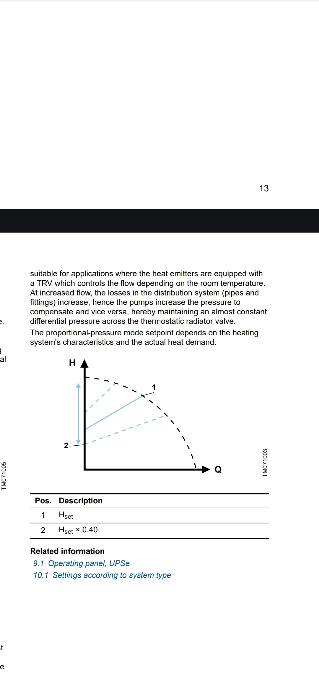

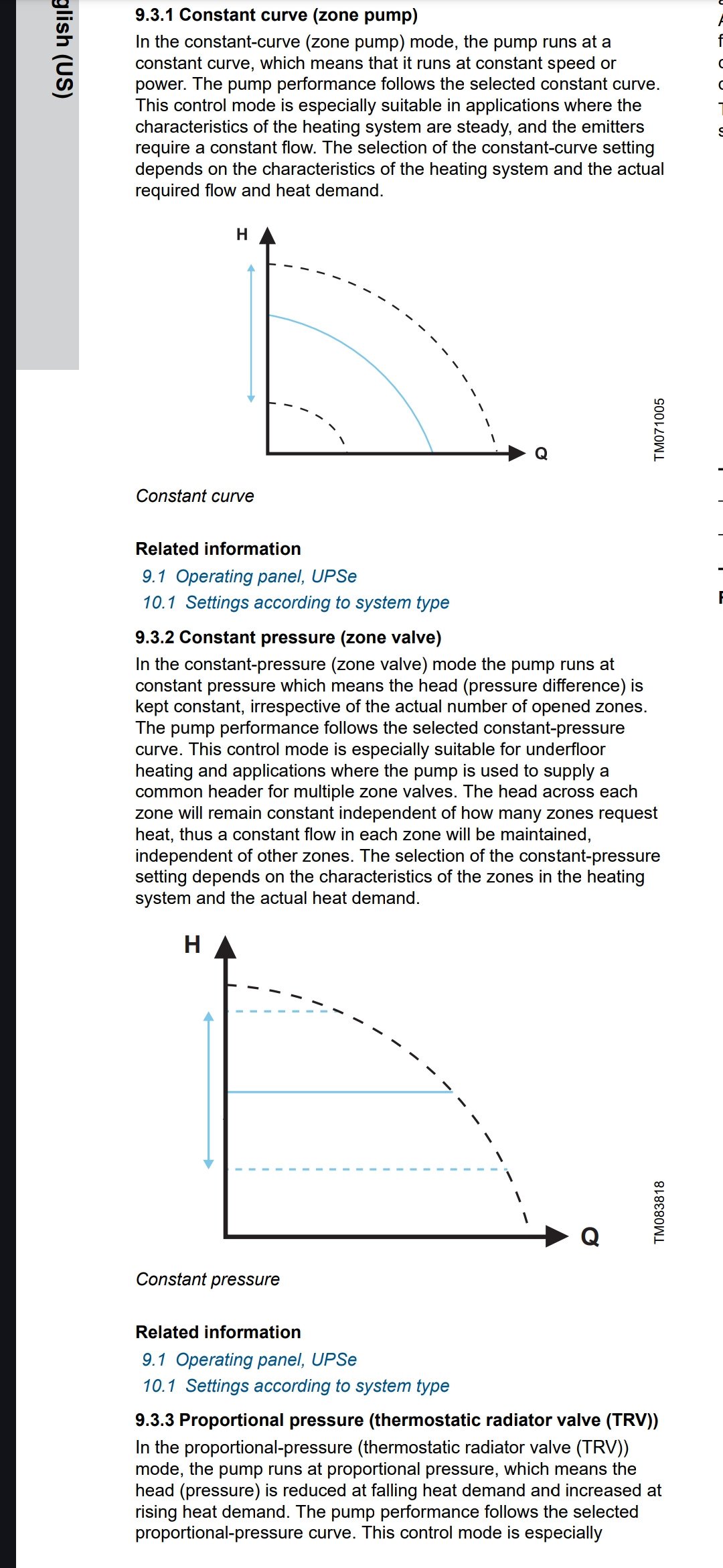

    I have the Grundfos 3 speed ECM pumps on both primary and secondary. They have 3 modes, constant curve, constant pressure and proportional pressure.
    Which mode would be best for my application and how do I know what speed to use?

    General rule of thumb is you want to pump as little water as needed. On the boiler loop run the Alpha in fixed speed. Adjust the speed to get about a 20deg delta across the boiler when firing in steady state. More flow (lower delta T) doesn't hurt, less can create issues.
    On the floor heat site, set the pump to delta P mode. Open all the loop adjusters, turn on the pump and adjust the delta P setpoint until you have above design flow on all your loops. From there, adjust each loop to get the design flow, don't adjust the pump setting.
    This way when you do zone in the future, the pump will then automatically adjust to keep design flow rate through the loops regardless of which zones are calling for heat.
