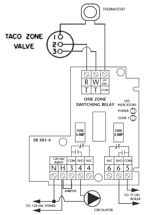

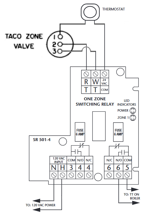

I need help! I am trying to add the taco sr501 one zone switching relay to my system to control my in floor radiant heat. The problem I am having is my in floor has a zone valve and the wiring diagram from SR501 does not show how to wire in the zone valve. The In floor system has its own T-stat, zone valve, and circ pump, using a common boiler. I am using the ZVC404-4 for the other 4 zones in the house with hot water being my primary.

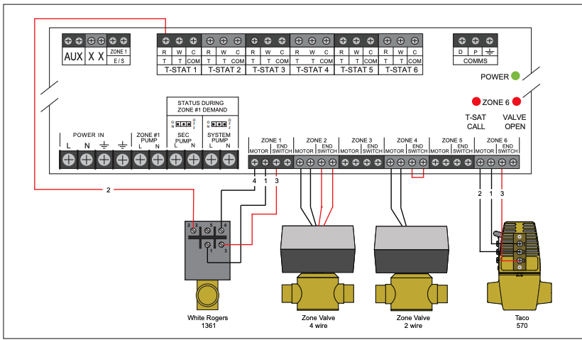

    You want a ZVR, zone valve relay, not a ZSR zone switching relay ,pump relay. The zone valve relay has a easily accessible 24V supply, and a larger transformer, for the zone valve.
    Generally a zone valve relay box will be at least 2 or 3 valve connection. So you have a spare or two.
    A 6 valve ZVR as example.

    Once you wired the relay to the radiant circulator . Wire the end switch of the zone valve to the thermostat TT terminals of the 501 . From a fused 24V transformer wire through the thermostat the zone valve . With a call of heat from the thermostat , it will power up the zone valve . When the zone valve fully opens it will close the end switch and the 501 will pull in to turn on the circulator …
    That is the basic

    One method to do it.
  • I have solved the problem and system is working. Thanks to those who actually tried to help.
    109A_5 Posts: 4,759
    OK, good you have it working. I missed that you stated you have a circulator too. Updated drawing if anyone needs it.
  • couple of techs already mentioned it.
    Protocol, thermostat to ZV, end switch from ZV to RW on SR50, and end switch on SR501 to TT on boiler.
