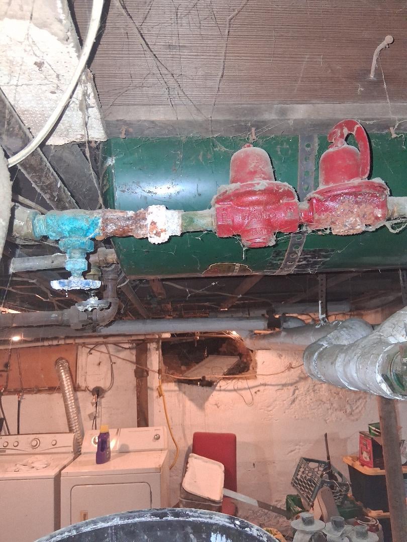

Will I have to drain my system to replace the section of leaking pipe between the supply valve and what i think is a pressure reducing valve? And what is the red gizmoe after the PRV?
    hot_rod Posts: 28,706
    is there a valve to the right if the two red valves? You need to isolate both sides.
    The red valve on the right is a pressure relief valve. If you have one on the boiler you do not need that
    You should however have a backflow preventer at the fill valve
    And if you do need to drain down, replace the relief valve on the boiler
    Buy a combination fill/ BFD
    if it is the relief valve there should not be a valve between it and the boiler.
    scatgoEdTheHeaterMan
  • Will I have to drain my whole heating system?
    YES!
