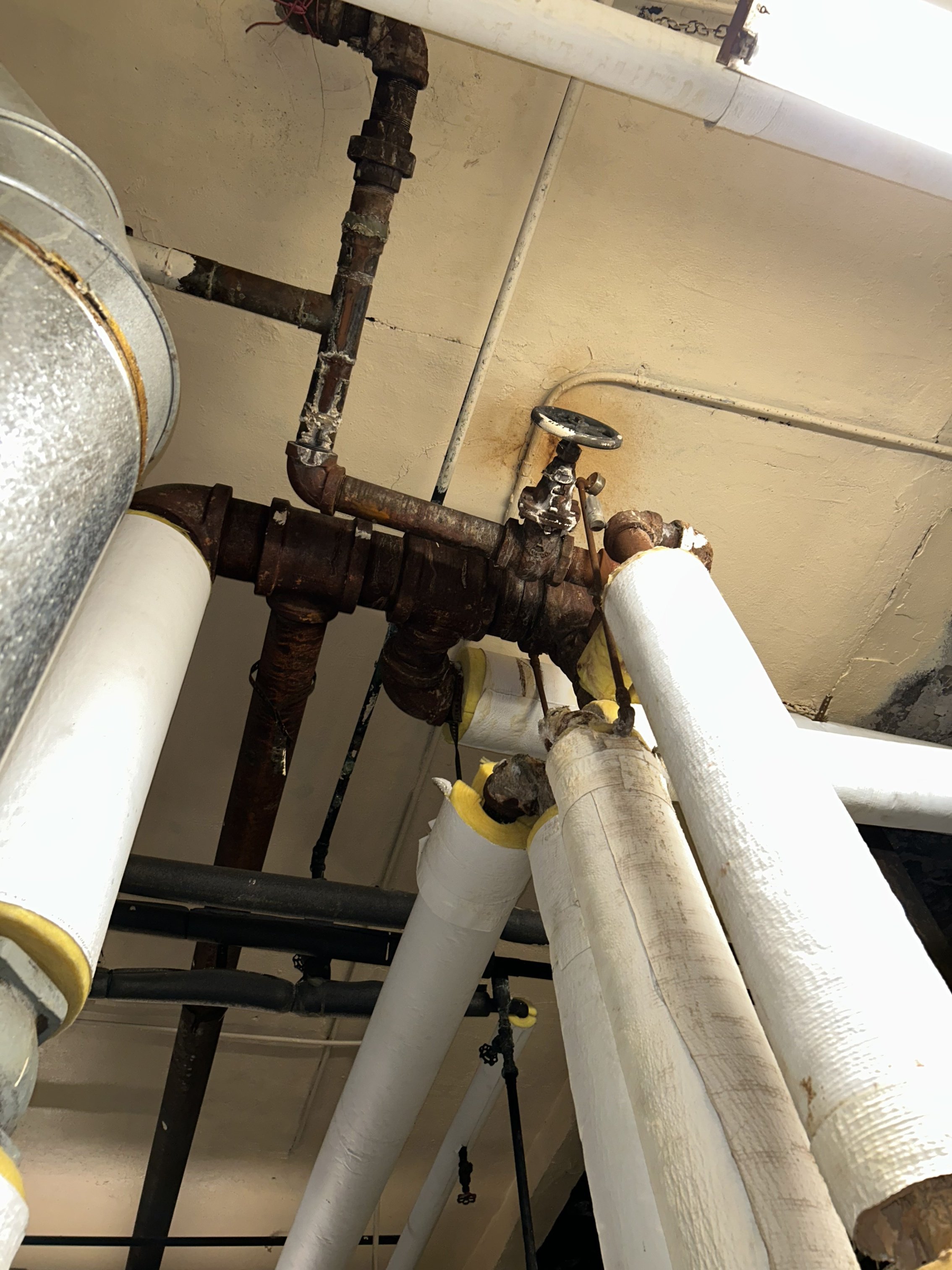

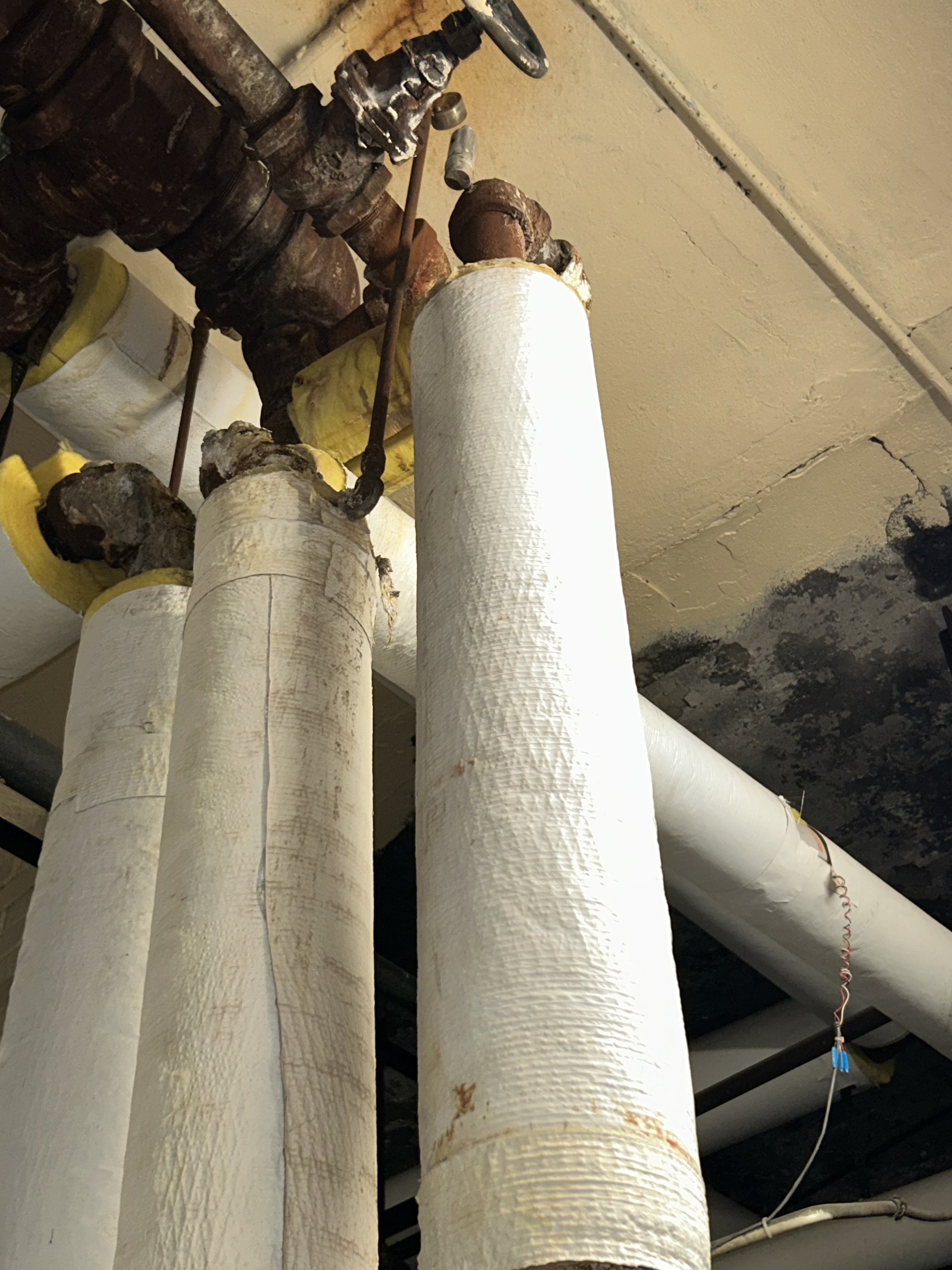

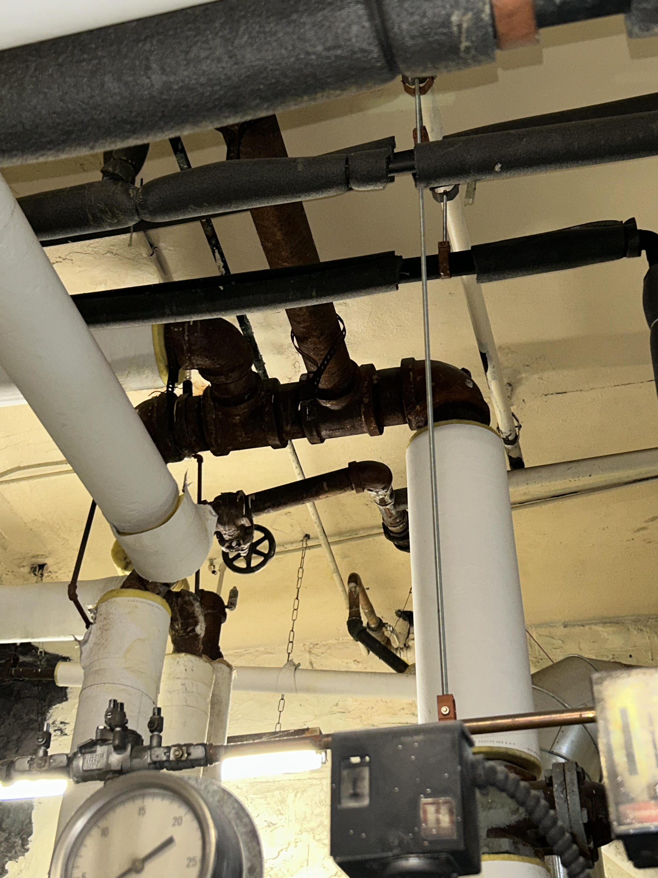

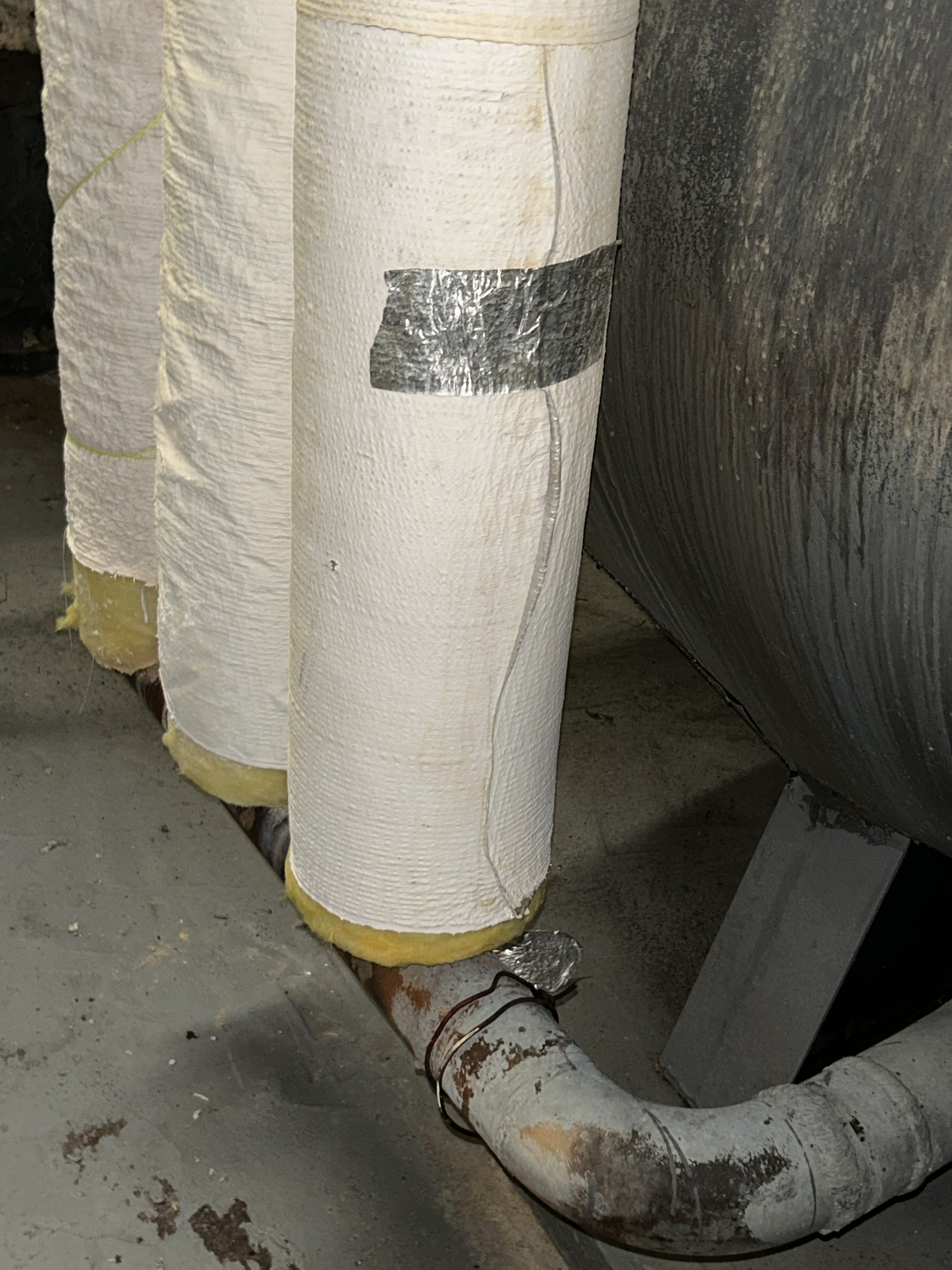

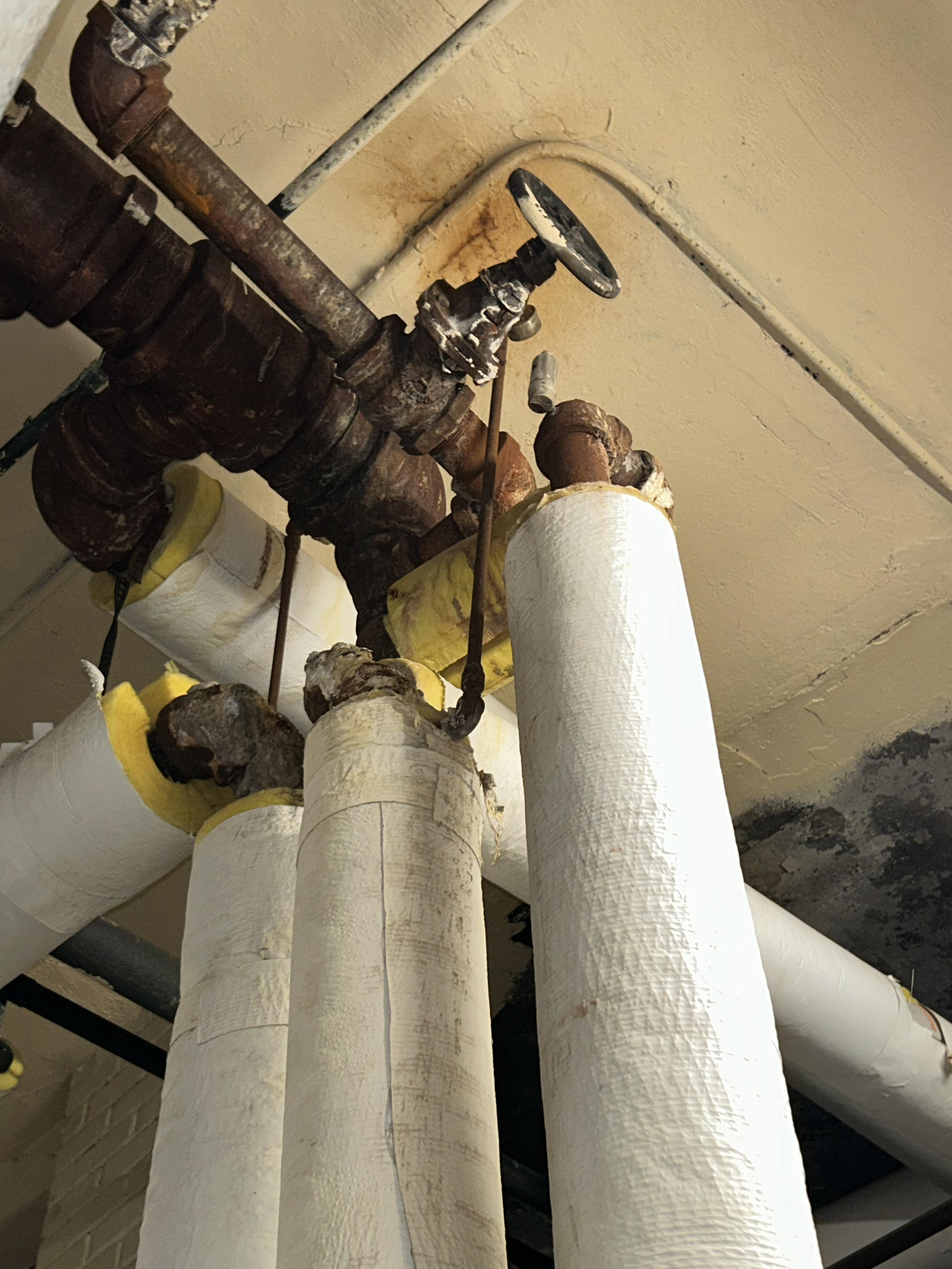

I am working on this building which has one-pipe steam system. I came across this condensate piping arrangement. The condensate return is a dry return until the very end and it drops abruptly near the boiler (have attached the photos). So would like to know if this a very common piping arrangement?
Also, how does this system performs because I couldn't see a hartford loop ?
Thank you.

    Need to take pictures from farther back so we can see the whole…..picture!
    It looks like you have a bunch of return lines that drop down below the boiler water line before they connect.

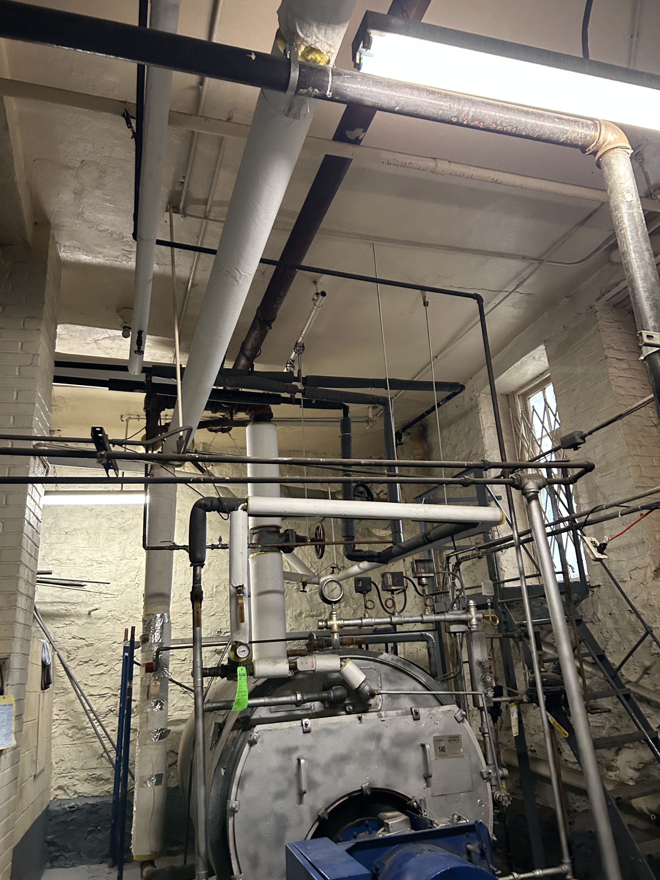

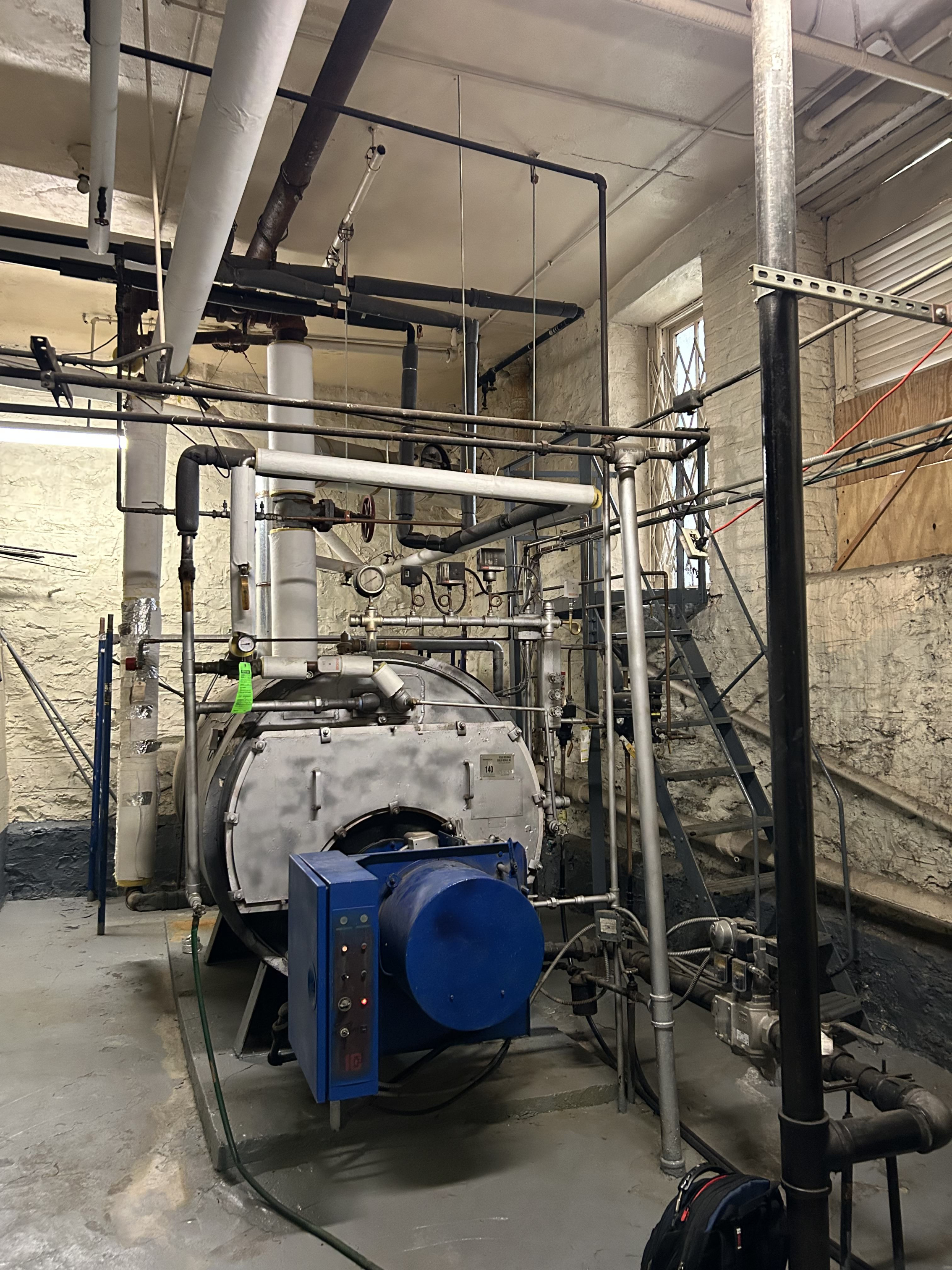

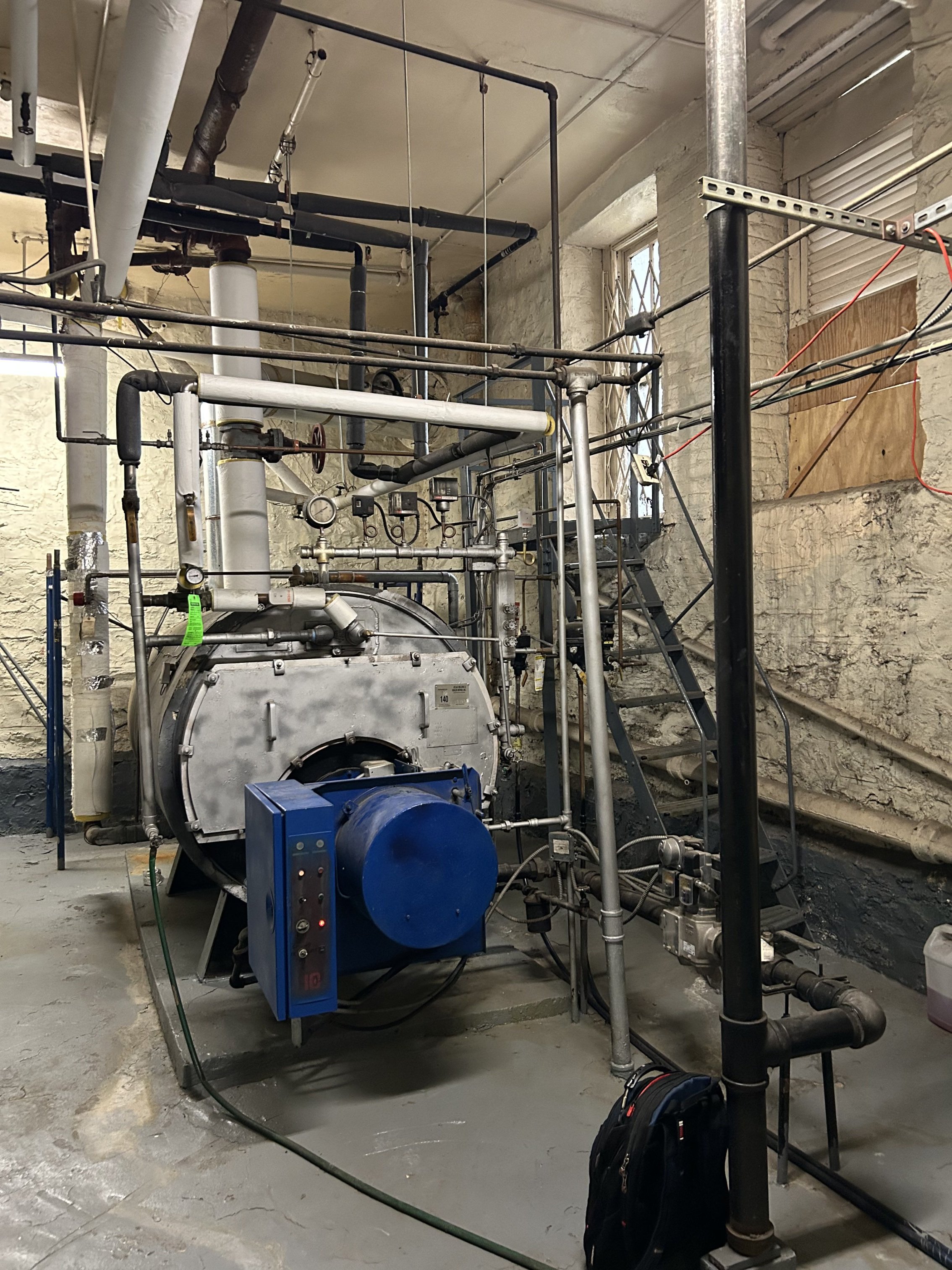

  • I have added some more photos further back from the boiler.

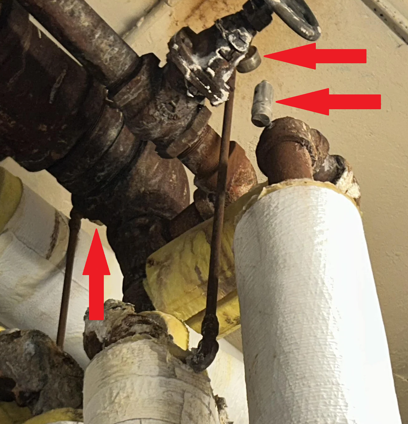

  • Yes, but they also have a steam pipe getting connected to the return header. In the below photo, the pipe furthest from the viewer is a steam pipe and the two pipe closest looks like a condensate pipe. This is getting connected to the boiler
    Cant see it but the steam to the return header is probably a drip from the steam supply. Nice ST Johnson Burner. The pipes in the air are difficult to see
    109A_5 Posts: 4,759
    I suspect in this case the wet return is so short (and completely visible) there would be no benefit in adding a Hartford loop.
    " they also have a steam pipe getting connected to the return header " This may be the Equalizer pipe.
    The system may benefit from better main venting.
    Intplm.
  • Is there any benefit of piping this way than the conventional way of dropping pipe and having long wet returns and Hartford loop?
    Depends more on where you have space for returns. The high returns won't rust out unless your boiler is throwing water in the mains. You can locate the vents centrally at the boiler.

    109A_5 Posts: 4,759
    Much less wet return pipe to fail and maintain. It may have just fit into the buildings structure better, without having to bury the wet return and make it hard to maintain and find leaks.
