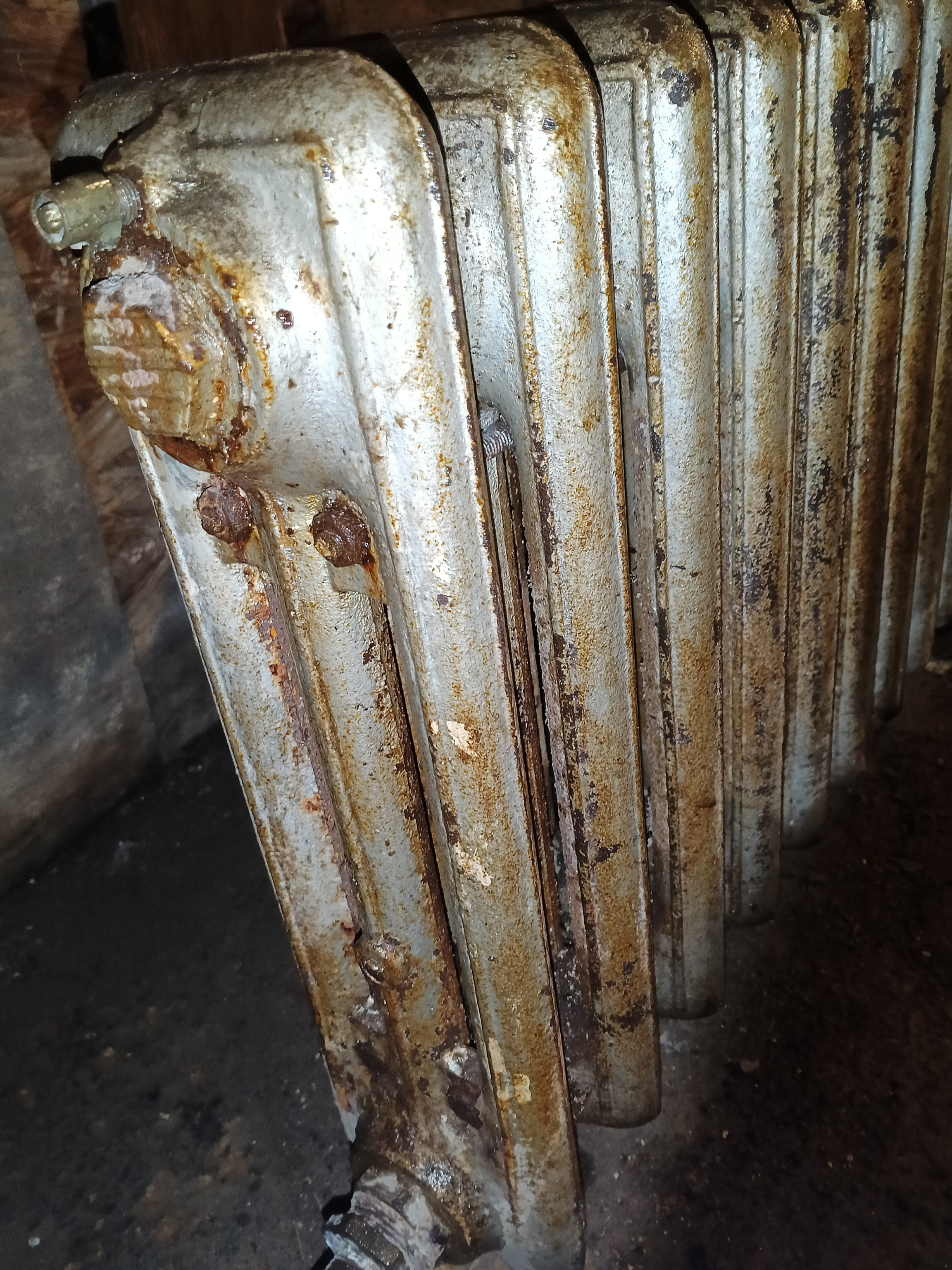

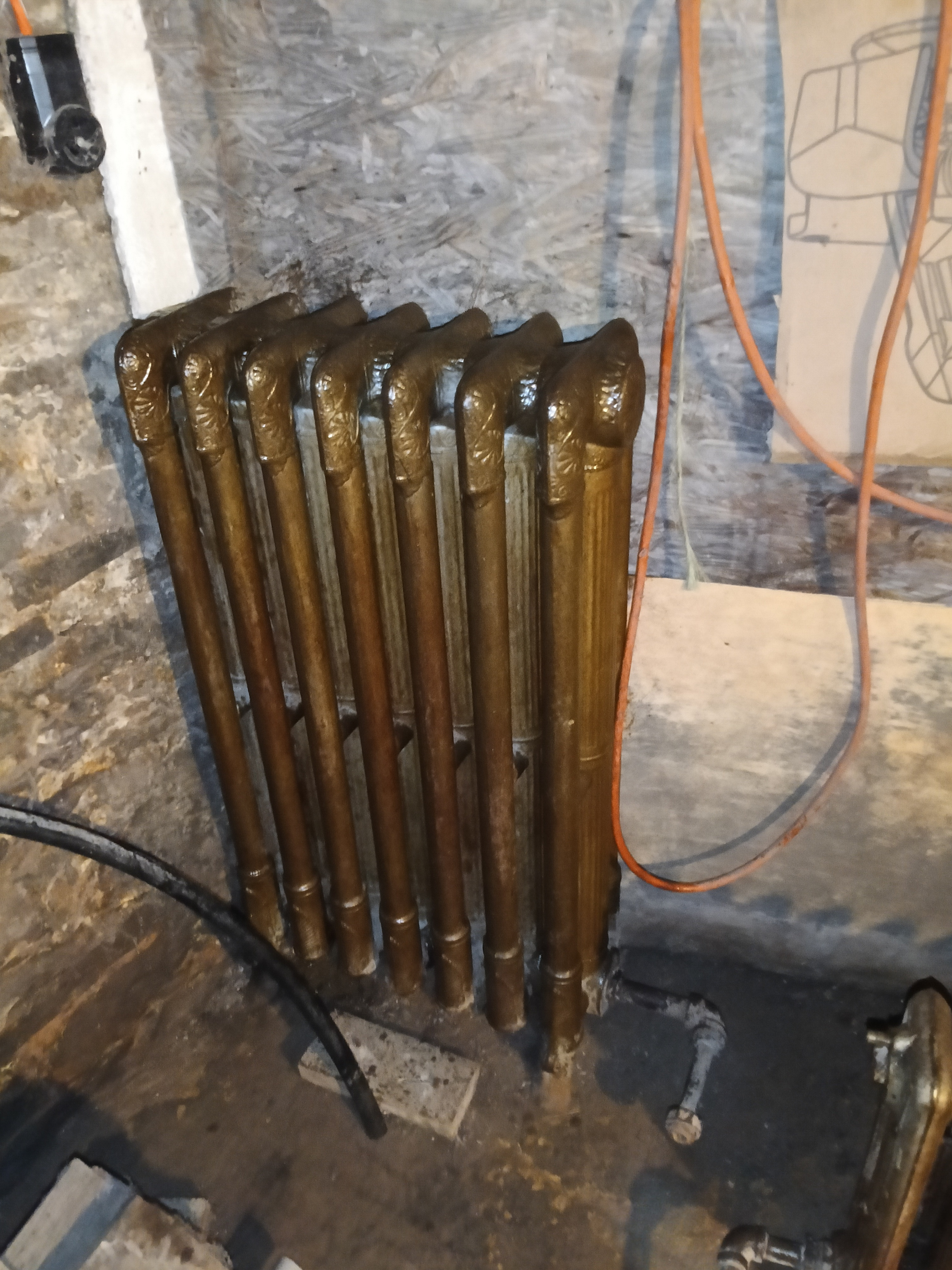

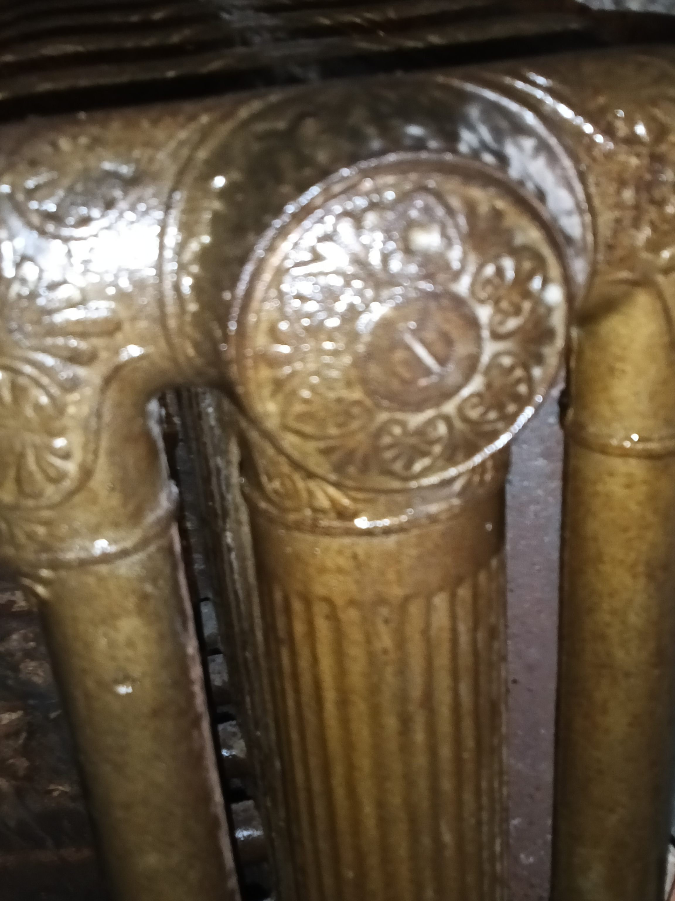

    The ornate one was made by H.B. Smith, and looks like their Royal Union model. It's definitely the oldest of the three- these decorative units were last made around 1920.
    The silver one is a large-tube type, which was made between about 1925-1938.

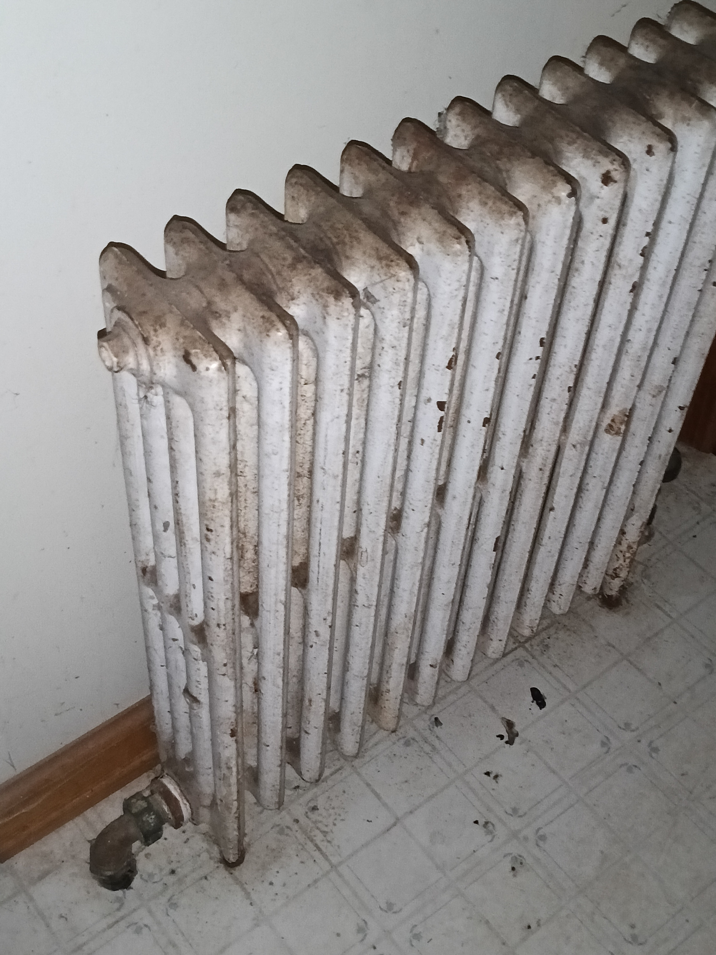

    The white one is a small-tube type, possibly an Arco which was made by American Radiator Co. This type of radiator came out around 1938, and some companies are still making them.
    If we know how tall these rads are, we can tell their heating capacity.
