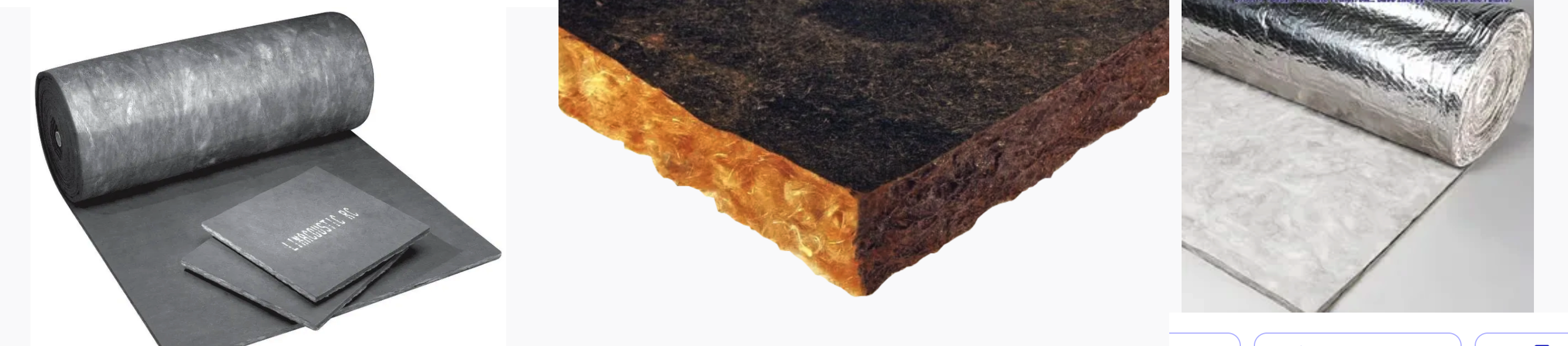

This might be similar to the material that is inside the furnace:
The stuff on the left and the center is usually glued and clipped to the furnace walls. The one on the left has a foil face and is often located inside the heat exchanger compartment where you can not see it without disassembly.
