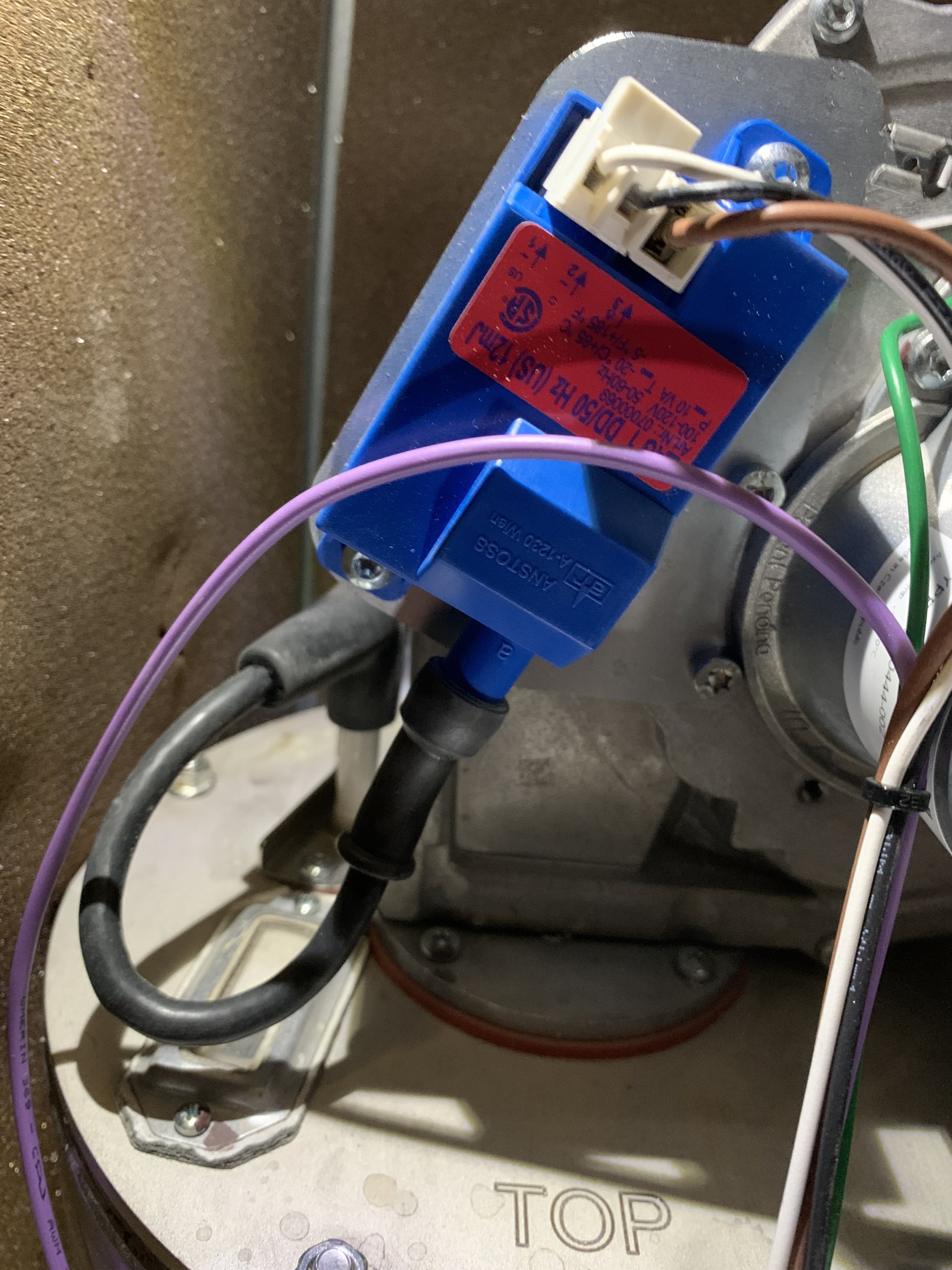

Apparently TT doesn’t make the PTRKit313 igniter and I have to get the upgrade kit just to change out the igniter PSRkit15 to the new design. Does anyone have the part number for the kit for LP prestige solo 110? TIA

    PTRKIT301
    they did a recall quite a few years ago now. There were issues with delayed ignition with the old design. Honeywell had altered the ignition parameters on the board without telling anyone. the updated ignition kit should include the new igniter, transformer, control board, and usually either a vent pipe piece for in the cabinet and sometimes a burner plate and insulation depending on the model. you will still need to do the conversion to LP. it is possible that this boiler is under the new recall they announced I would check with TT before anything else in case you can get the parts or work done for free.
  • Call (877)574-5036 to find out if your boiler falls under the recall. Like Mr. Gross said, they will send you the parts for free.

    Thanks guys. I’m under the recall.
