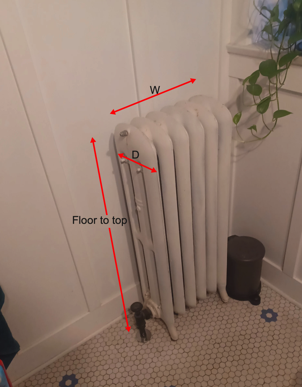

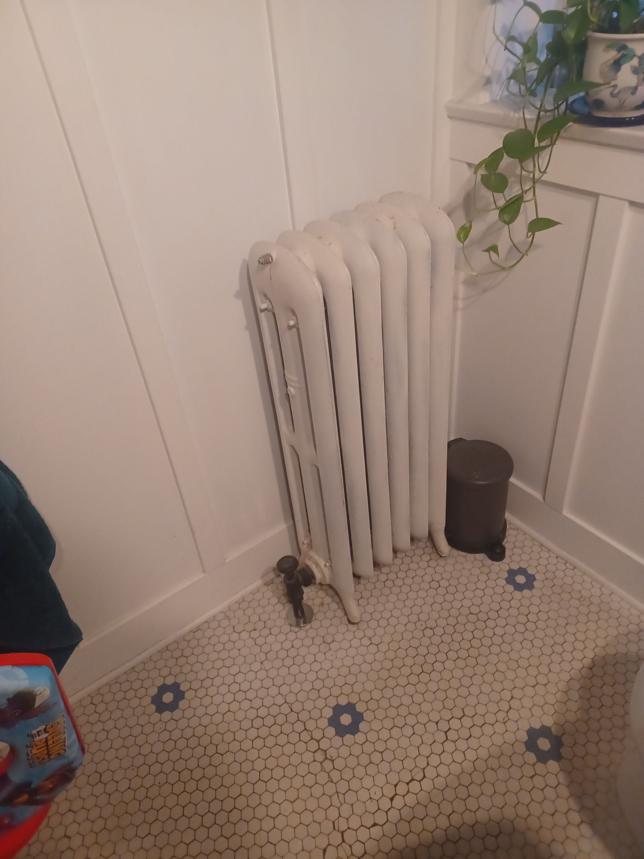

  • This radiator is 9x14x35" and fed by 3/4 pipe. I assume the piping was originally installed as a gravity system but now has a single circulator. There are separate supply and return lines that hit each radiator

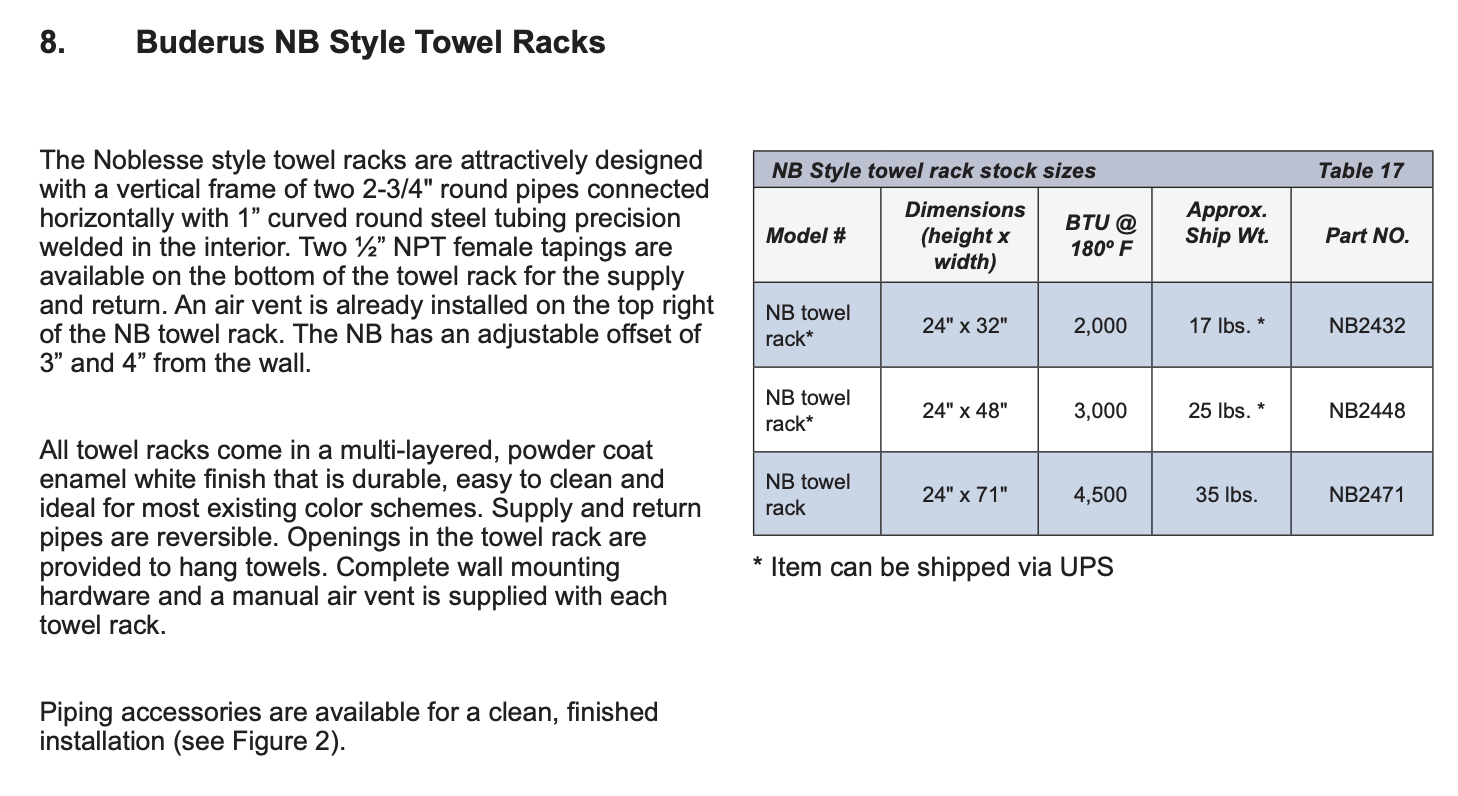

    @Dielectricunion, By my calculation your radiator will have an output of about 3000 BTU/hr with 180° water in it. The Buderus Towel warmer that I pictured in my mock-up photo is the Model Number NB2448 which is 24" wide and 48" tall. It should be hung on the wall at least 3" above the floor but you can go higher to accommodate the necessary piping. That item may be hard to find in USA but it should be available somewhere, and it happens the have a BTU output of 3000 BTU/hr with 180° water in it…. Go figure!
    Call around to some suppliers that handle Bosch and/or Buderus equipment to see if they can order one for you.
