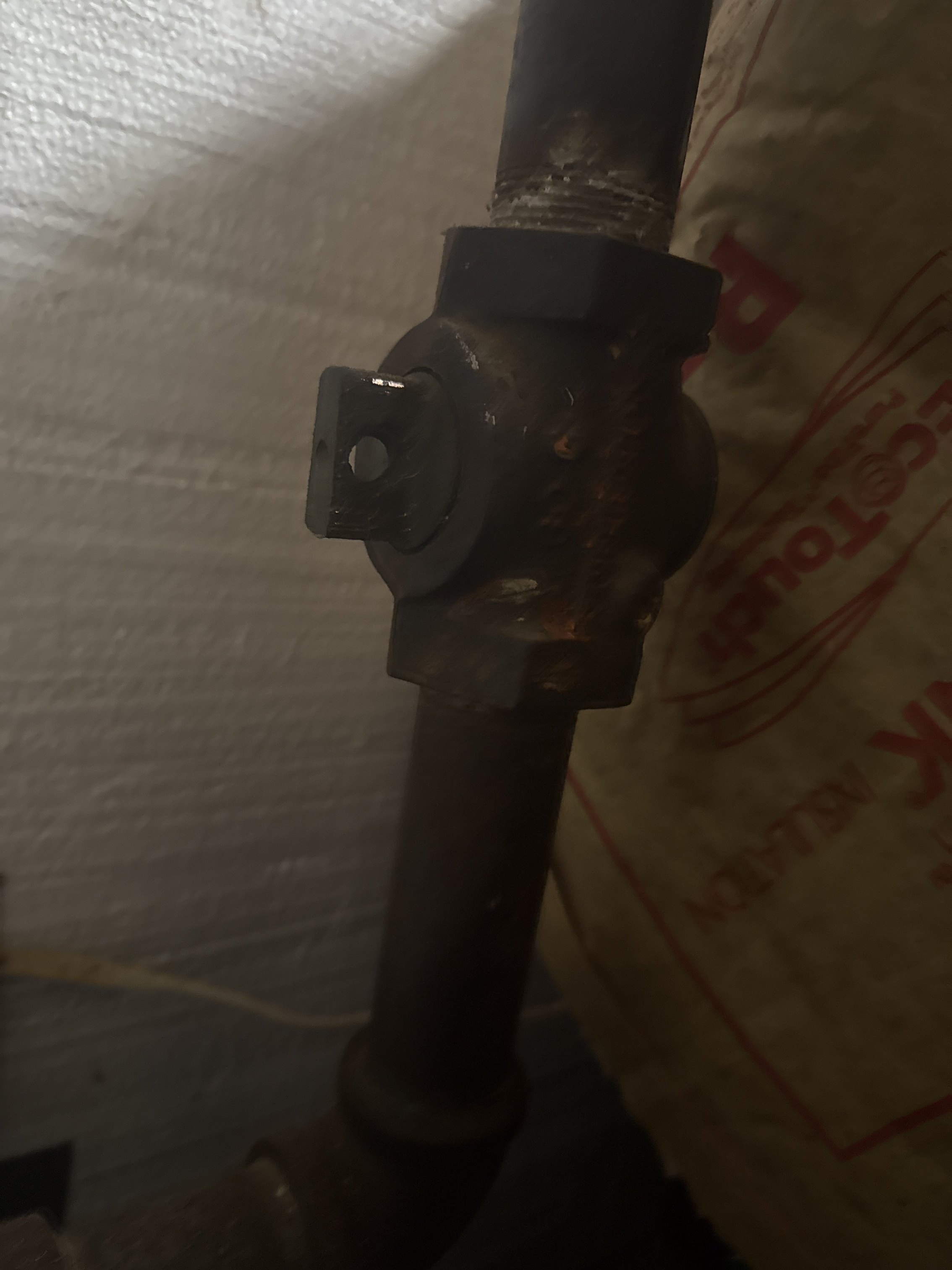

can anyone tell me if this appears to be the main gas shut off valve?

    That is the type of quarter-turn valve used to turn off gas. You will need a wrench to operate it.
    As to whether it is the main or not, we cannot tell from the photo. Trace it back toward the meter; if there are no other branches that is the main shutoff.

    it is right before the meter.

    Then it should shut off all the gas fed from that meter. Some buildings have more than one meter.

    Use caution if the valve hasn't been used in a while. You may want to loosen the nut on the other end to get it to move easier. This may cause a slight leak but will stop when you retighten the nut

    Also, be aware of the new rules touching any piping or valves before and at the meter. Mad Dog

    That appears to be a cast brass ground key valve. They are obsolete and not approved in new work. They seize up, leak or both. Often, when you try to shut it off that cast brass wing will shear off rendering the valve stuck in that position. If you have the opportunity to have other gas piping done in the house, I suggest you have a pro cut that garbage out and replace it with a fully ported ball valve listed to ANSI Z21.15 .Ball valves almost never seize up or leak and, being fully ported means you have the full diameter of the pipe, unlike ground key valves.
    FYI, the emergency shutoff for any building is at the meter. Learn where this is so you can direct responding personnel if there is need. Most utilities strongly chastise even pros to shut off, and on their meters. That's because we have this invasive species called "lawyers". In the event of a suspected indoor leak the code does not expect the lay public to enter a space flooding with combustible gas and attempt to shut it off. Exit the building taking the pets and kids if you're attached to them, do NOT turn off any switches or anything that could spark, such as light switches. Just get out and away from the building, THEN call 911. Let the cavalry deal with it.
