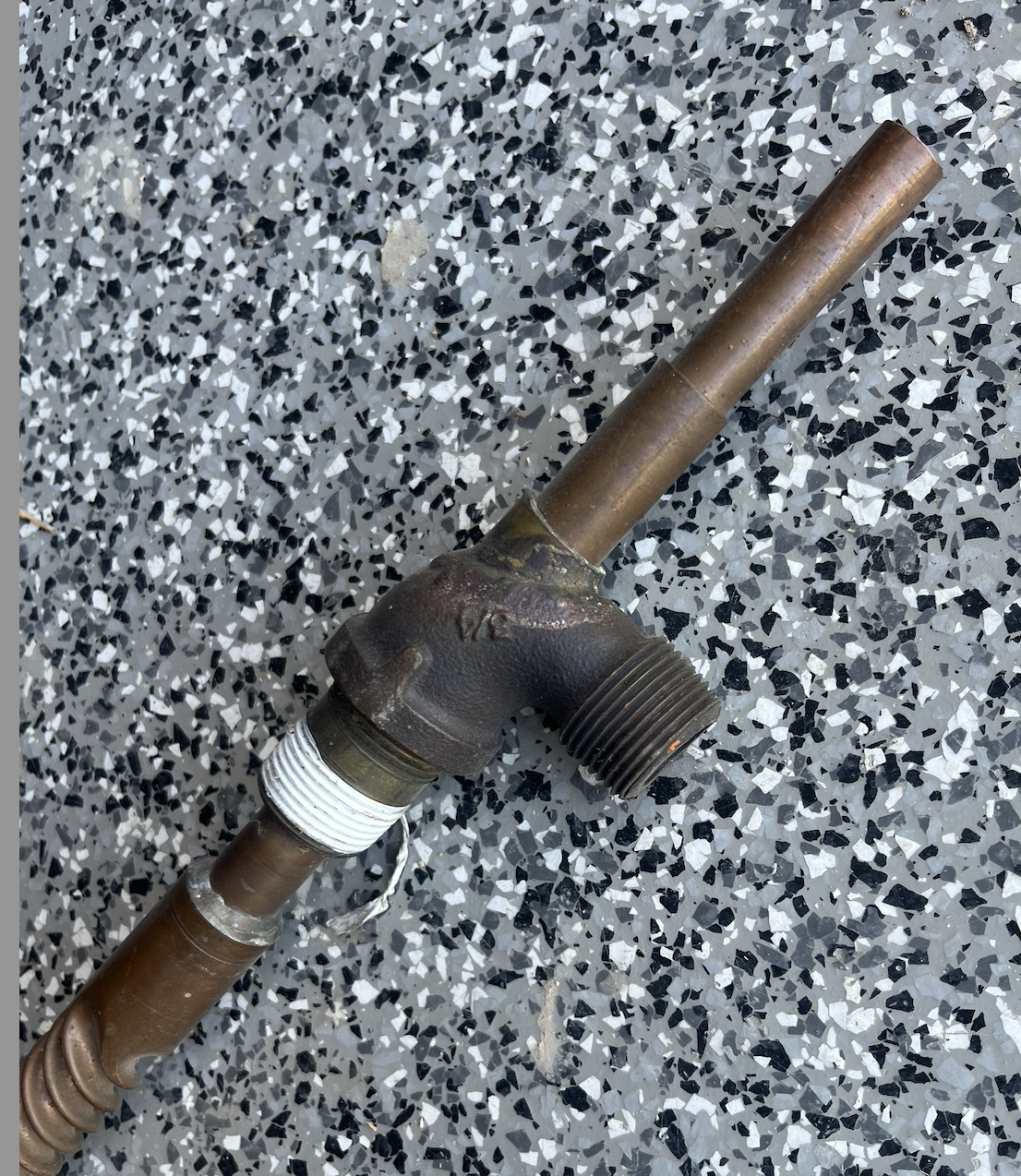

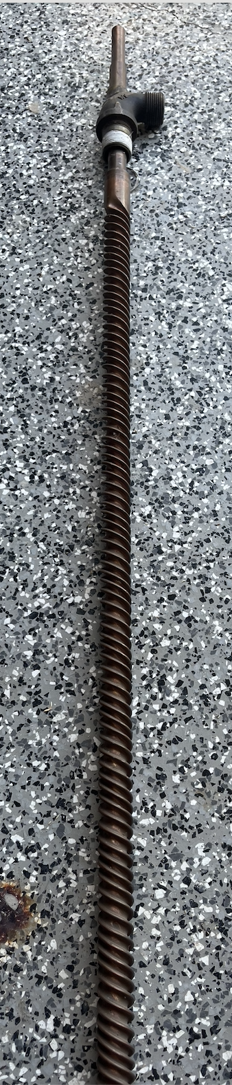

    hot_rod Posts: 28,706
    I have used the Butler Solar Wand for a few micro radiant systems. Like a single bathroom.
    You drop this double walled heat exchanger tube into any HW tank to pull some heat out.
    Screenshot 2025-08-04 at 8.54.12 AM.png Screenshot 2025-08-04 at 8.53.58 AM.png
