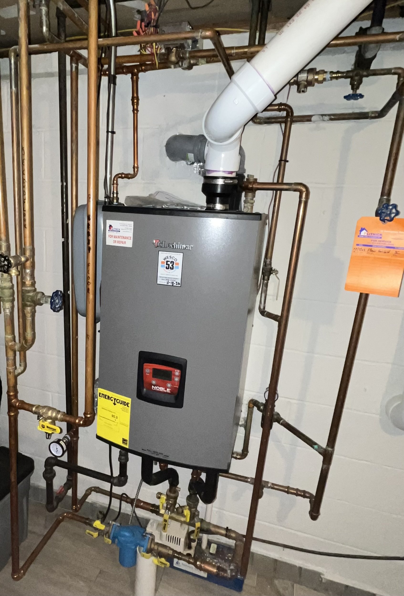

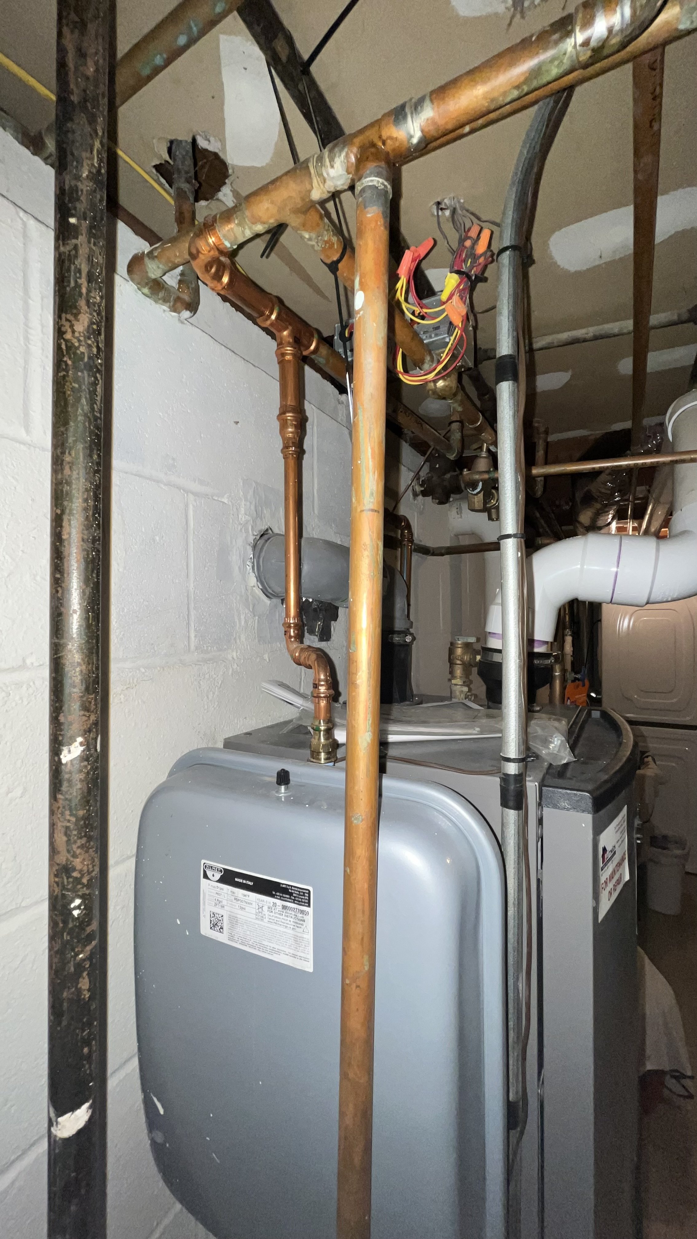

How about pictures of the boiler piping, floor to ceiling all sides.

It may be a compression tank system. The noise in the video sounds like expansion noise from improperly installed pipe.
Thanks, no there are no bleeder valves, I end up needing to flush the pipes a couple times per year from the basement to bleed air. Here are a couple boiler photos if that helps. Seems like there should be an air eliminator above the expansion tank but I don’t have one.
There should be a microbubble air separator with an automatic air separator between the boiler and the circulator.
you may be able to eliminate most of the noise by setting a reset curve that makes the boiler run long cycles at a low temp at warm outdoor temps so the expansion happens more slowly and it always stays warm.
or set a reset curve that keeps it matching the loss so it only changes temp gradually and is constantly heated.
