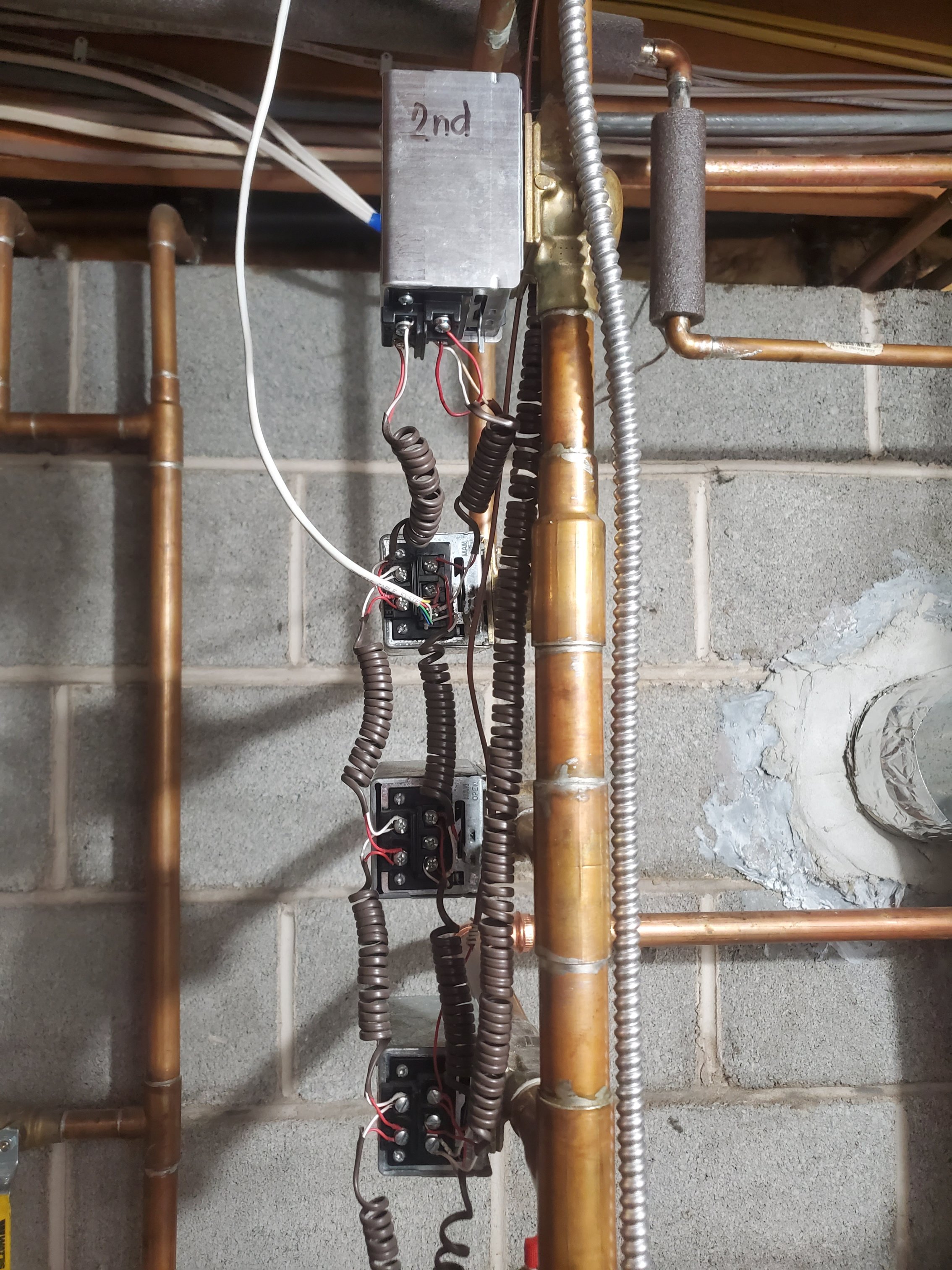

I was in our bedroom and heard the baseboard element make the expansion noise w air conditioning on. Felt the pipe and it was warm. Checked the thermostat and it was set at 60. In the basement I felt pipe above Honeywell zone valve, and it was hot for at least 4ft before it starts its rise to 2nd fl. Temp on pipe on outlet side of 1st floor zone valve was slighty warm. Move lever on zone valve and it functions against spring to off position. I am trying to figure how water is getting passed a closed vave. I have an indirect water heater so circulator does come on and it seems this is when it happened. Is it possible that water is passing around a pitted or broken ball inside the valve? Thank you

The stop ball inside those valves can deteriorate or get a groove worn in it. Then the slowly seep heat through

The 1st floor zone valve is directly below the 2nd floor valve in the picture. The distance from the 2nd floor valve in question to element is about 13 ft then runs horizontal along bedroom wall. Turned up thermostat on indirect to make burner fire and circulator run. Zone valve to 2nd floor does not open which correct which leads me to believe the ball in valve is slowly letting water pass since the pipe is hot about 140 degrees next to the valve but element on 2nd floor is warm enough to cause expansion of pipe. Return from 2nd floor is not warm which leads me to believe water seeps pass ball in valve enough to warm 2nd floor pipe when circulator if on but not enough to cause the remaining 50 ft of pipe to get hot. The water temp next to outlet of 1st floor valve is only room temp.
the least expensive fix it to purchase a new valve and use the part that is defective. You can use the existing motor and the existing valve body so you don't need to solder any pipes. There was a kit with just that part you need, but i don't know who might have that part in stock.
Looks like SupplyHouse com has them
https://www.supplyhouse.com/Honeywell-Home-40003918-006-2-Way-Powerhead-Conversion-Kit-Water
Thank you. I just ordered from supply house the entire head w motor and ball since I fell better having an extra motor assembly w end switch, etc.
There were 2 different versions of that valve, not sure if the new parts will fit the old body without the kit to adapt it.
