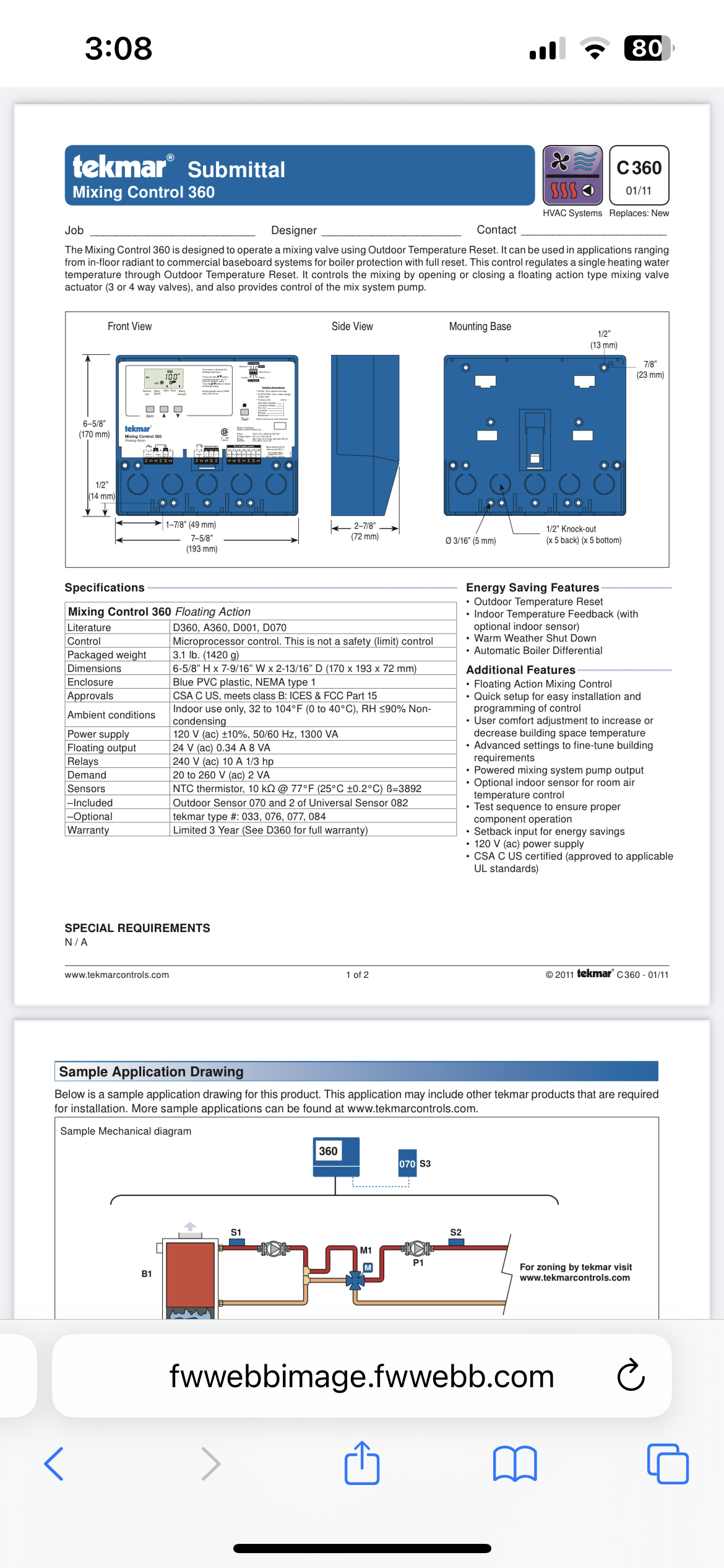

As I am starting to set up my new Weil-McClain Cga4 that w be used for radiant floor heating I would appreciate some help knowing what components are needed for the outdoor reset. I will be using a Tekmar 4 Way Mixing Valve, an Actuator motor,and an outdoor sensor. But what type of controller? I had written to Tekmar and got a response saying they replied but there was no information in their emails. So I thought I would inquire here!

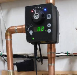

    You might check out the LK110 from LK Armature if you haven't already gotten the Tekmar. The controller mounts on top of the valve. The LED display cycles through mixed water temp, min temp, max temp, curve, offset and outdoor temp. Select the desired parameter and then adjust up/down as necessary.

    OffGridICF Posts: 22
    Not that I know of. I have an LK823 loading valve (LK181538, thermostatic 65C min return) for boiler protection on my wood fired boiler. The LK110 fits on a 3-way mixing valve (LK180855) which is used to regulate the water temp going to the radiant floor loops from storage.

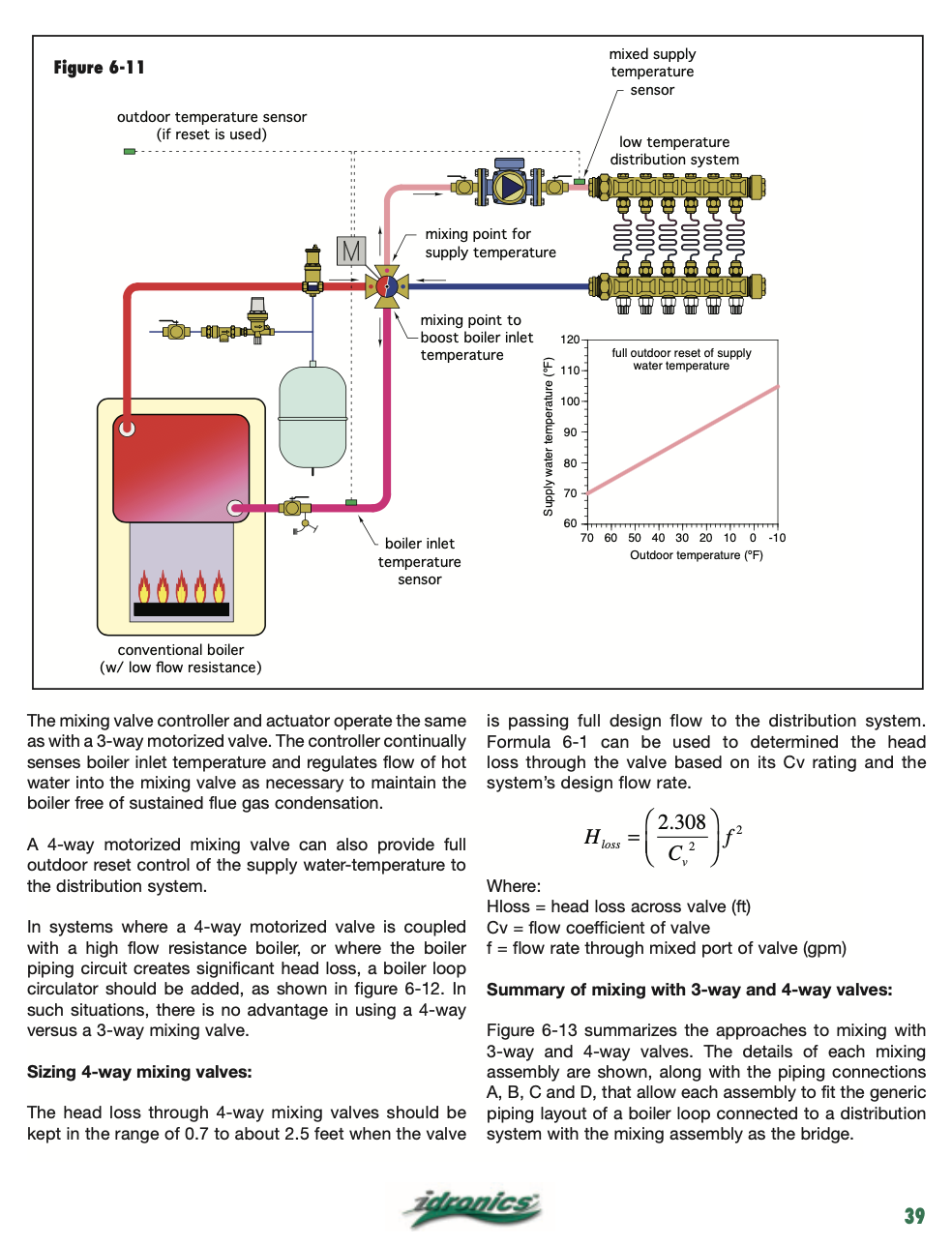

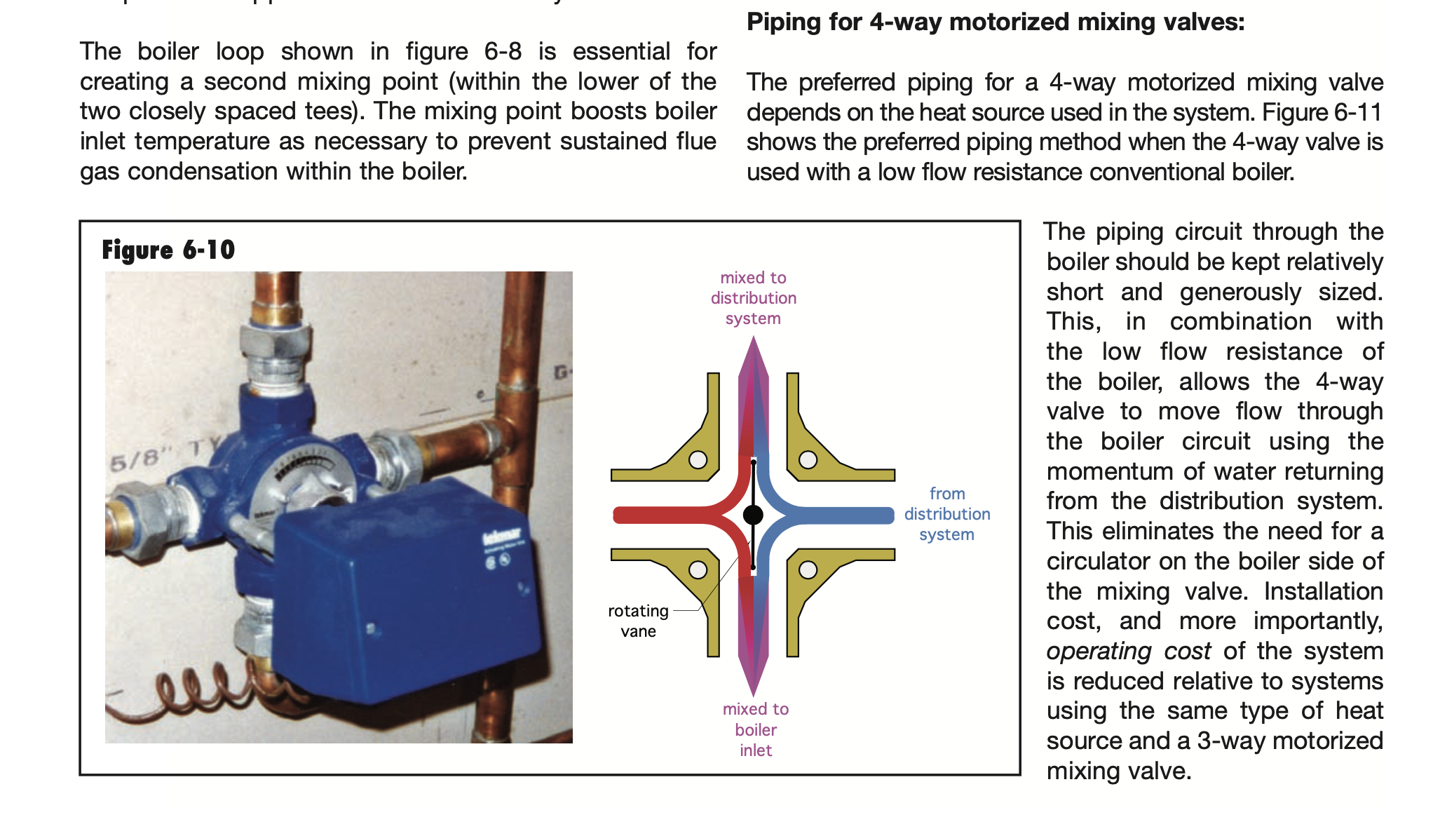

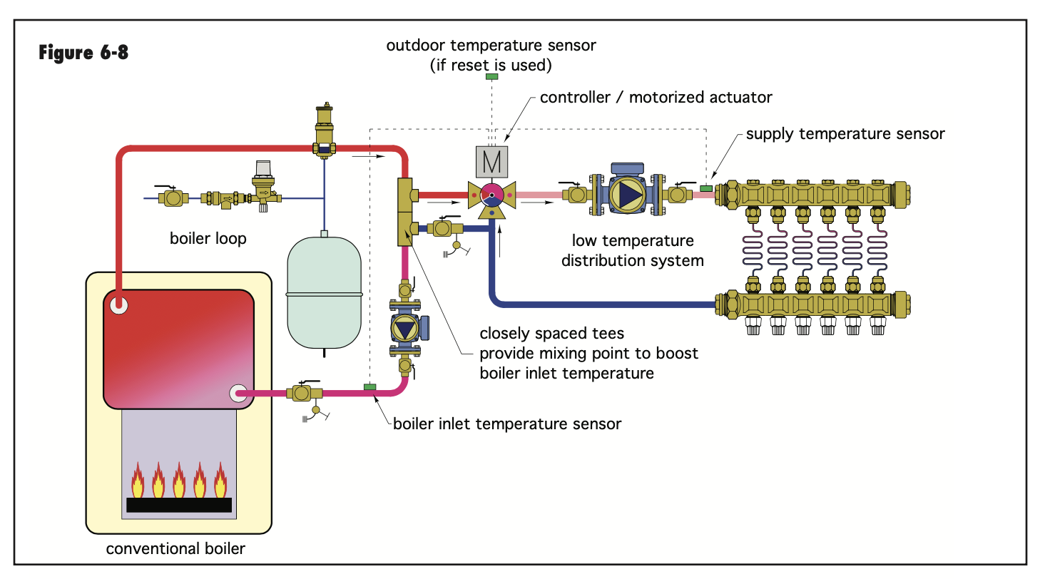

    hot_rod Posts: 28,708
    A 4 way valve has two mixing points. A 3 way only has one. So a 4 way can mix down the radiant and also protect a non condensing boiler. Plus odr. It takes 3 sensors to do this.
    A 3 way typically requires P/S piping, fig 6-8 hence two circulators.
    A 4 way would need to pipe P/S if you use a high pressure drop boiler. For some reason??
    With a low pressure drop boiler, one circ may be all you need with a 4 way. Wood or coal boilers often have a buffer tank, so the single circ works well.
    Screenshot 2025-07-31 at 12.52.02 PM.png Screenshot 2025-07-31 at 12.51.24 PM.png
