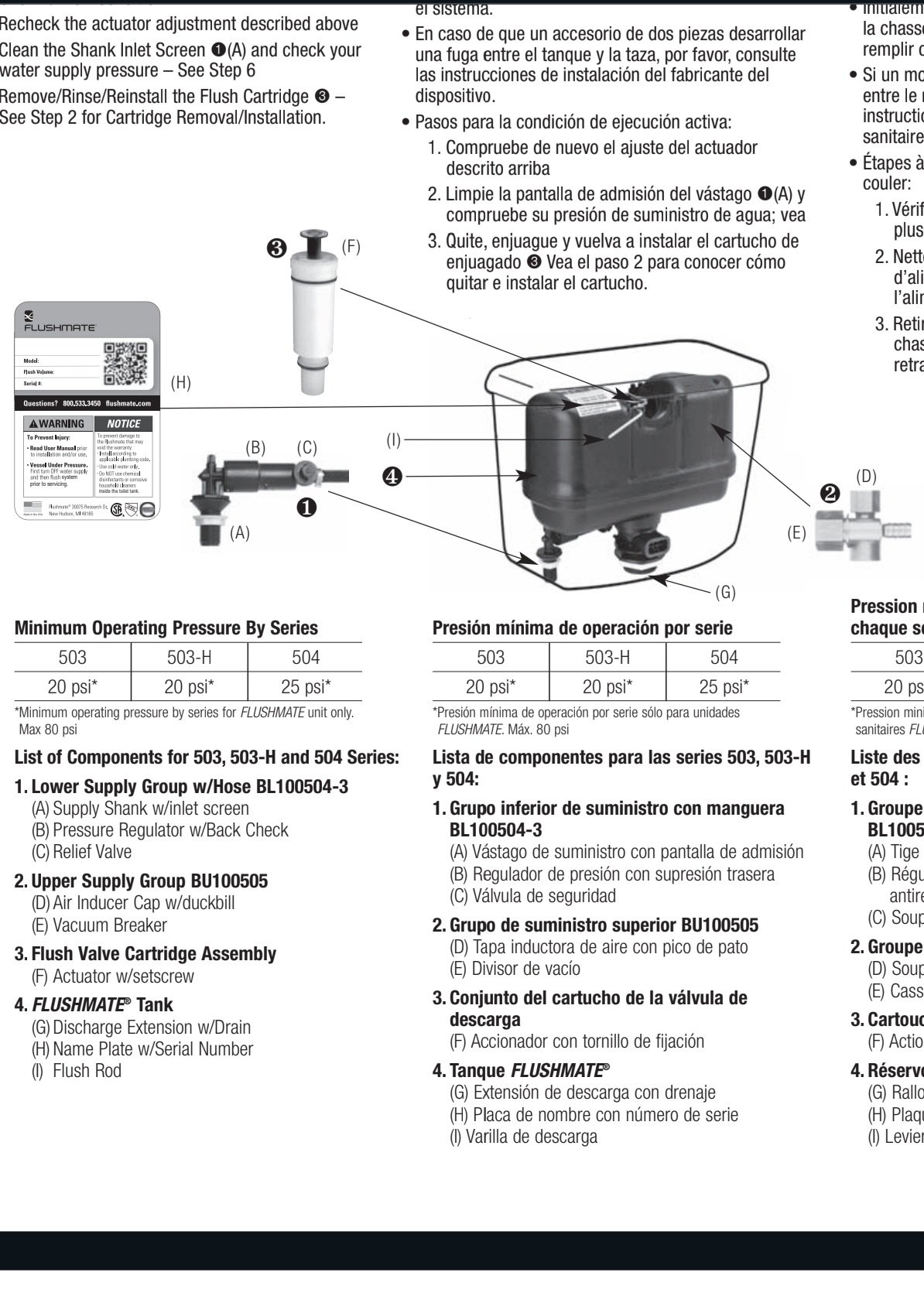

Does anyone here have experience with Flushmates?

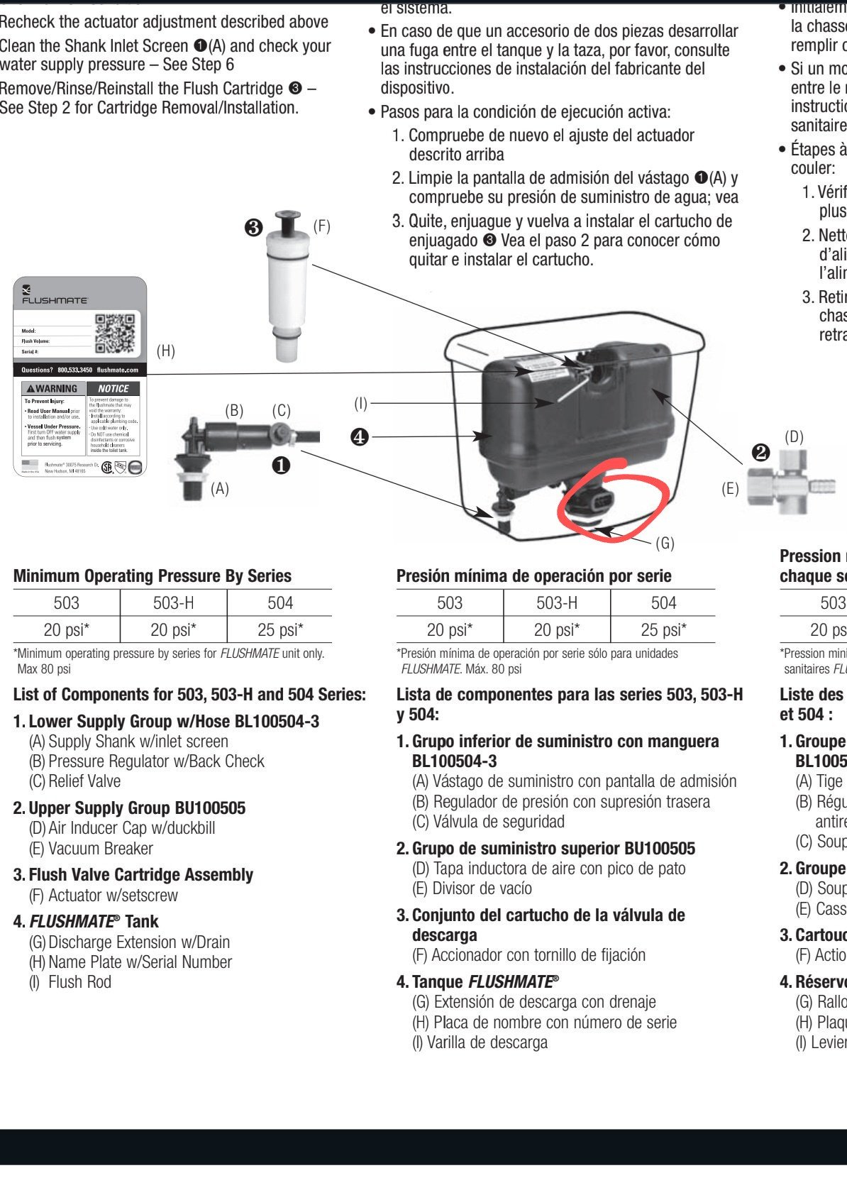

Is it normal to have a small amount of water in the bottom of the tank? I see some action down there when I flush it, but I can't tell if it's going up, or down, or both. I always thought these were 100% sealed and the tank stayed totally dry.

    Usually i will see the tank dry, the water could be leaking from the small vacuum breaker on top or condensation if the tank was constantly running that's probably why they call you out there to check, the movement you see while flushing is just the prusser of the flush

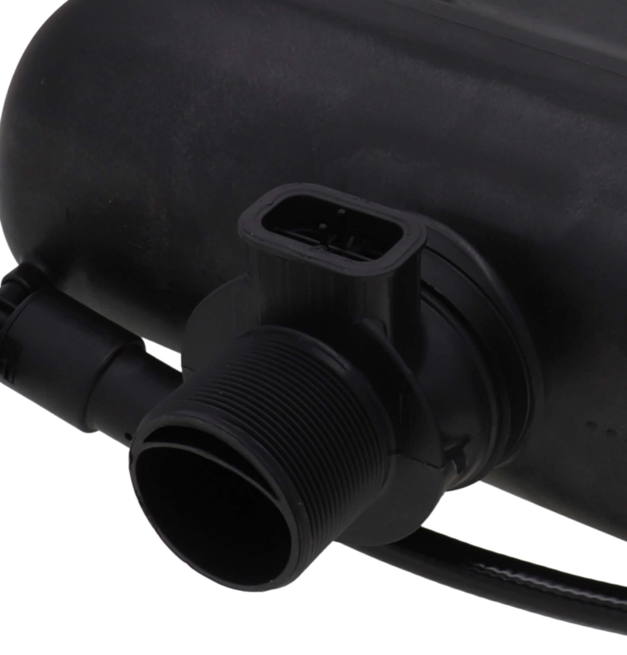

    There's some kinda thing on the side at the bottom that I see doing something. That's the problem I can't see if it's just peeing out a little each flush or if it's also draining at the end.

    I have installed 3 Sloan units they didn't work properly and my supplier stop selling them to do many complaints, the once from Gerber using Eco flush work properly
    Check this out you have a little prusser relive valve on the water inlet

    It's a Gerber 1.6 and the place I see something happening is from that square area at the bottom in your diagram.

    It looks like there is some sort of draft regulator there, maybe that is leaking

    should be dry. Water in tank is typically leaking plunger valve (#3 in IPB) on top of plastic tank.

    That's an overflow drain if water is collected in the tank, if you only see water movement while flushing it's like I said only the prusser from the flush possibly causing some water to back up to the tank

    Yes. It can be normal to see water at the bottom of the tank. If it's not leaking anywhere else and not affecting performance, I would not be concerned.
