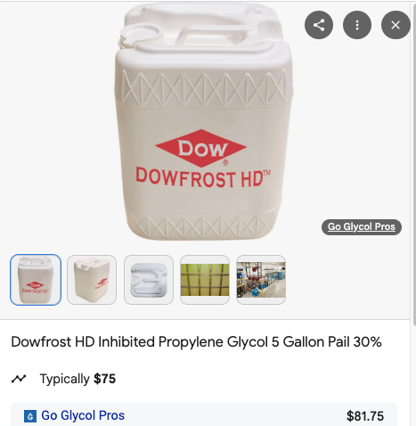

    Read the warranty, I believe glycol or a couple freeze valves are required. I'm not sure freeze valves are a good option for cold climate however. Some units have the HX too low to use a freeze valve.
    So glycol may be the safest for both freeze and warranty claims. I doubt a frozen HX would be a warranty item, and an expensive replacement.
    Regardless of the DHW option with a buffer tank the glycol can be $$. A circ, valves and HX probably less than 500 bucks.
    The newest A2WHP modulate pretty well and may not need more than 20 gallons of buffer. That makes the glycol option more reasonable.
