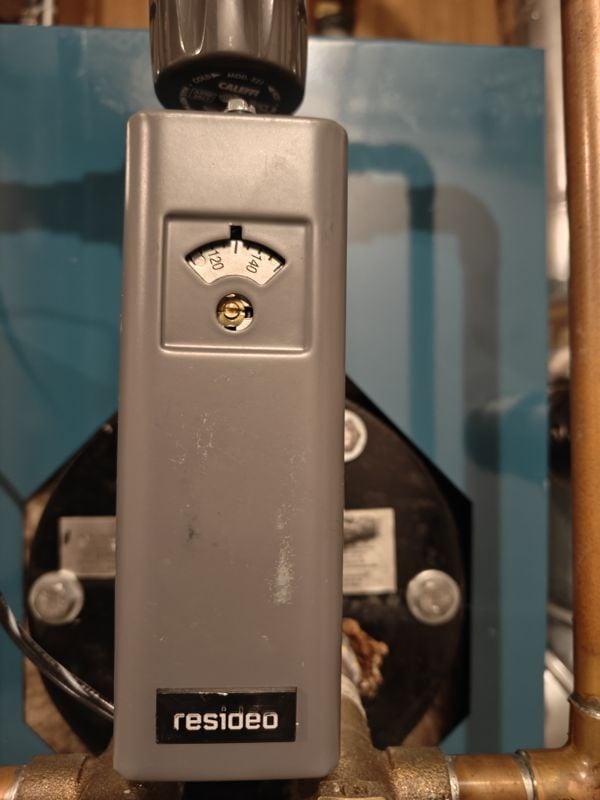

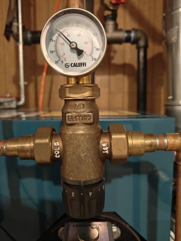

    Here's what my coil looks like. The Honeywell aquastat was set to 160-170 degrees, so I adjusted it down to 130.
    Does that look okay? I got my boiler's annual service done a couple weeks ago.
    130 is a bit low but I don't think you will get much hot H2o at that temp.
    With the mixing valve you have has a thermometer on it. Turn on the hot and cold for the shower and let it run. Then set the low limit on the boiler to maintain 120 water temp

    How do I set the low limit on the boiler? There's only this one aquastat with a temperature I can adjust that I can see. It's a Resideo L4006A2015, and when I looked it up, it says it can be set as a high or low, so I'm actually not too sure what I just did when I changed the temperature…
    I ran a hot shower tonight and the water was fine, but I don't know how much of that is the water not having cooled yet.
    The Honeywell aquastat. The same one you adjusted from 170 down to 130. That is the low limit. That aqustat keeps the boiler at the temperature you set it for 24 hours a day 7 days a week, it runs the boiler so you can get hot water weather your thermostat upstairs is calling for heat or not.

    Oh, I misunderstood your post and got mixed up with the temperature gauge and the low limit. I just turned it up from 130 to 140 and the temperature gauge shows 110.
    The hot water feels really comfortable. Do I need to turn it up more until it reaches 120? Is a lower temperature something that can harm the boiler?

    If you take the cover off the aquastat, there's a white dial to set the differential. Don't go higher than 10.

    Just opened up the aquastat and the white dial inside is set to 10. So that seems okay.
    With the new setting at 140 my boiler is no longer going on every hour. Hoping these settings are safe!
    The temperature on the Caleffi Thermometer are only accurate if a hot water tap is turned on. If there is no hot water running thru the pipe, then the thermometer is measuring the water temperature that is in the pipe when you took the picture. If that water was not moving thru any pipes, then that water may have a chance to cool off.
    The temperature setting on the RESIDEO L4006 is what the oil burner will come on to maintain. when the boiler water gets below 130° the L4006 will turn on the burner. the white dial set at 10° inside, will make the burner operate until the boiler water gets to be 140° (130° limit setting + 10° Diff = 140° cut off temperature). Since you are using cold water from your city water service or well water pump, you most likely have 52° to 62° water entering the tankless coil. That potable water will absorb heat from the boiler water as it moves thru the tankless coil.
    Depending on how fast the water is flowing thru the coil, the water exiting the tankless may absorb 50° to 80° from the boiler water. Now lets think about that process for a minute. Lets say 58° water enters the tankless coil and travels thru the boiler water going around and around the 140° boiler water, absorbing lets say 62° of temperature from the 140° boiler water. That would make the potable water exiting the tankless coil 120°. (62 + 58 = 120).
    If you don't need any hot water for some time (more than a day) then you can turn off the burner and the boiler temperature may drop to 60° over the next day (if the basement is 60°). Now when the 58° water enters the tankless coil, and the water passes thru the 60° boiler water, there is next to no heat for the potable water to absorb. You will get 60° water out of the tankless water heater. That should not present any problem with your burner, tankless coil or boiler.
