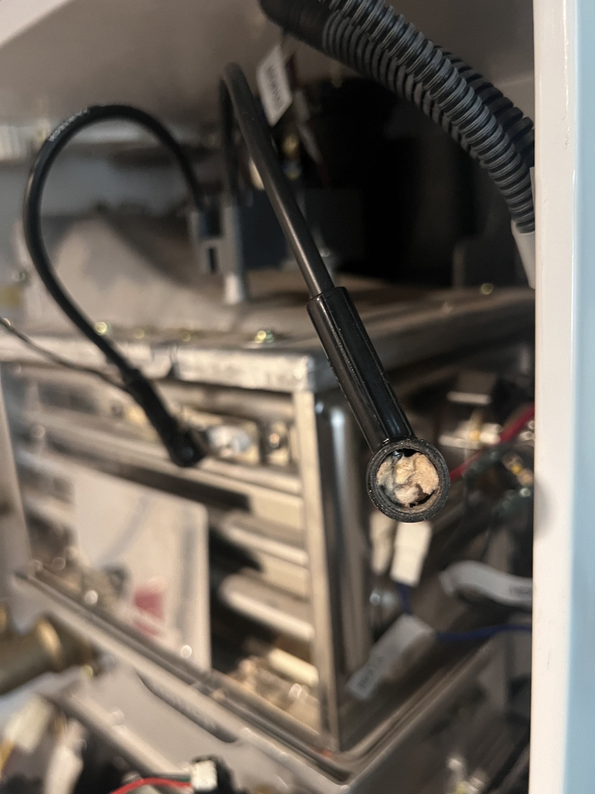

new replacement ignition transformer on a Navien NHB does not have the fibrous insulation material in the boots.
The supply house checked and none of their stock on hand has it.
Can find no info on it.
Is it no longer considered necessary?
The original stuff is rather friable and only able to reuse enough for half of one boot.
Thanks for your time

    Pictures may help. May just be a production change. Especially if the old stuff does not hold up well.
  • mikemac52

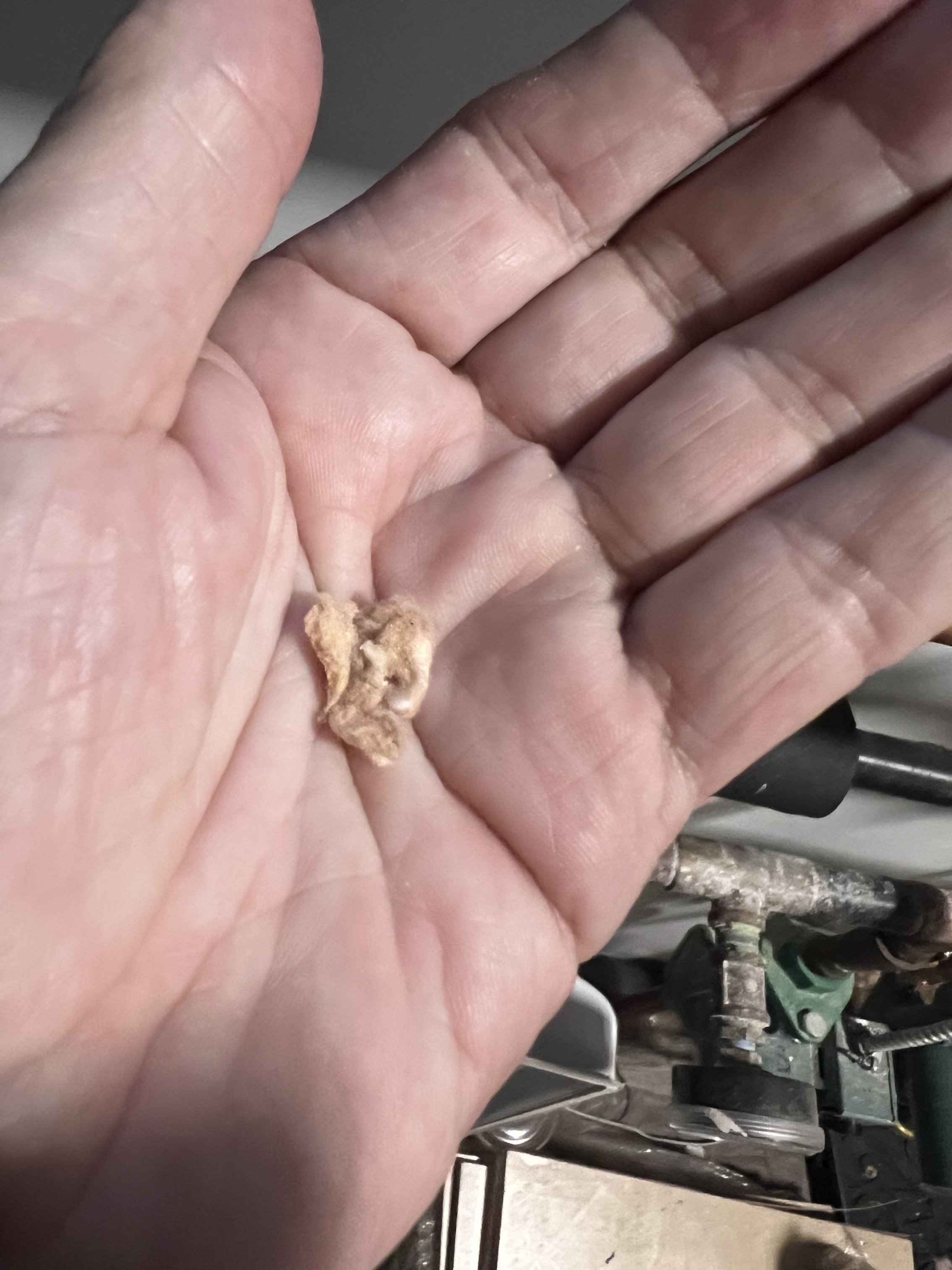

    mikemac52 Posts: 58
    Lol, taking it out again it was crushed and now makes it look like a piece of lint .
    Previously it was not flat and filled the cavity in the boot around the electrode.
    I just sort of shoved the pieces back in for the photo. Imagine fluffy lightness evenly spread out in the insulation boot.🙃
    all this compression I think it no longer will work as designed. 🤔

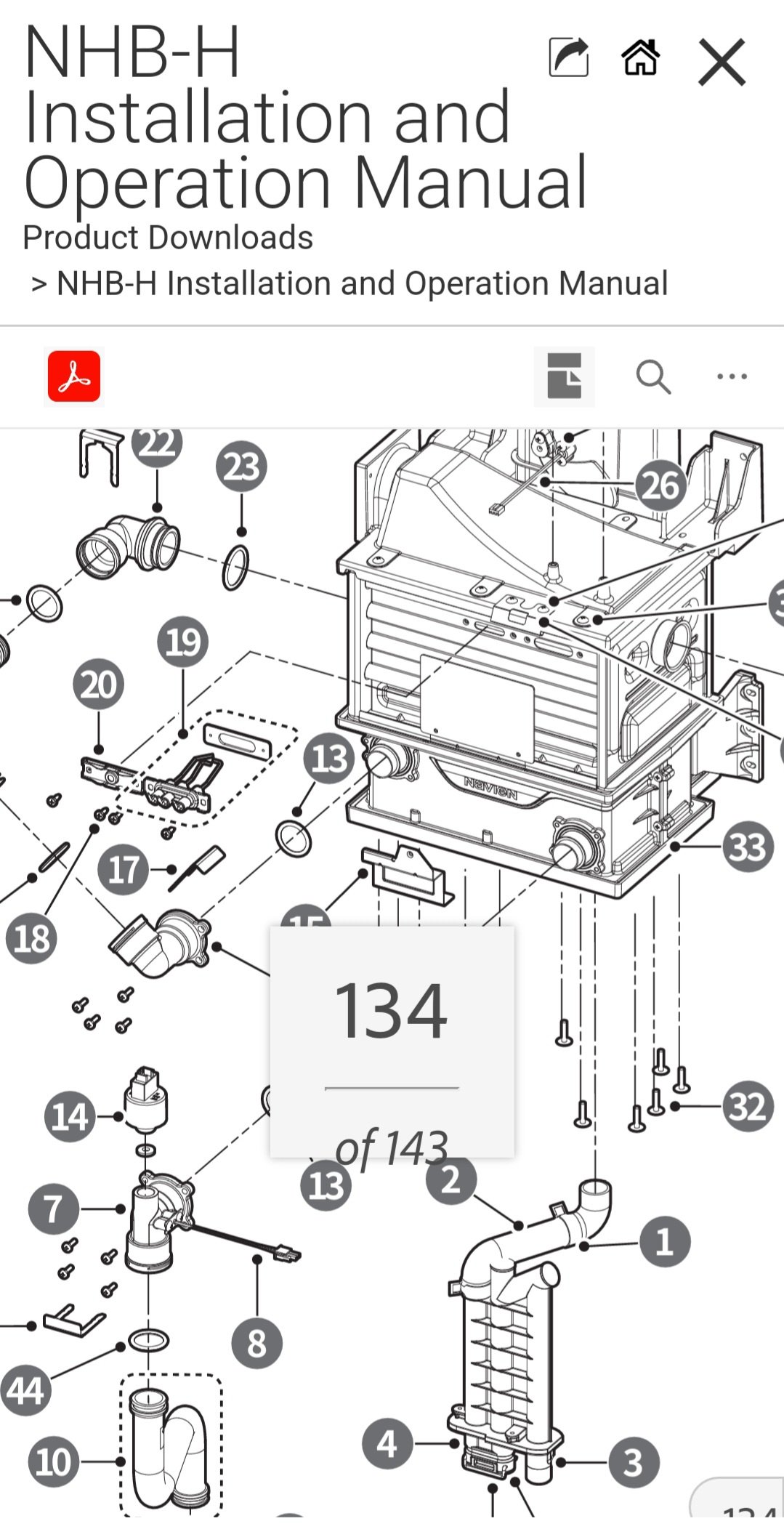

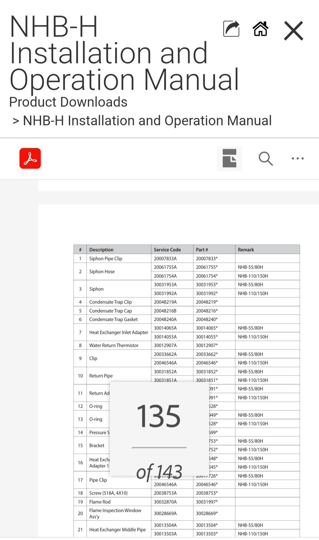

    HVACNUT Posts: 7,784
    Item 19, Flame Rod, shows it comes with the gasket. They should supply 10 with every Flame Rod because they fall apart if you breathe on them.

    Hi @HVACNUT
    Absolutely right on the flame rod gaskets, hateum. I'm asking about item 24 though, the insulation boot on the ignition transformer. Any ideas?

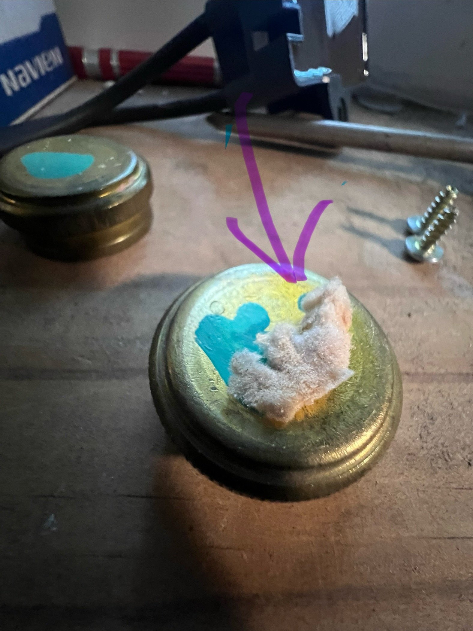

    Hi @EdTheHeaterMan
    Yes, original transformer being replaced. 6 years old about and had that material inside which mostly crumbled when removing the old transformer. Yes, the contact inside makes quite nice contact with the electrodes of the flame rod. The material seems to have been a dielectric.
    And after fooling around with neon transformers for a long time, let me tell you those big rubber boots you put over the connection don't guarantee much in protection from 15kv. So, the addition of the fibrous material makes sense to me but perhaps as @109A_5 said, it was a production change.
    If I could find the material, it would be nice to use regardless. (I hate arcs)
    Thanks for your (all) help.

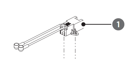

    Not seeing an item 24.
    No extra gasket in this illustration.

    At that voltage and the proper ignition rod spark gap if every thing is kept clean it may not be much of an issue.
    Still if the present boot leaves an air gap that you don't like maybe could you add some appropriately sized silicone rubber 'O' rings to seal the gap ? Or thin wall silicone tubing ?
    if you want something to pack in there you could use this which is made for the purpose, mostly used on crt anode wiring:
    https://www.gcelectronics.com/product/10-8880
    (high voltage putty)
    you could also use dielectric grease if the gap is small.

    SuperTech Posts: 2,711
    I wouldn't worry about it. Unfortunately I work on Naviens all the time. I throw that stuff away when it falls apart. The heat exchanger failing will certainly be a problem before anything happens as a result of that fluffy fibrous junk missing.

    Part 24 was from a different exploded diagram that @HVACNUT used.
