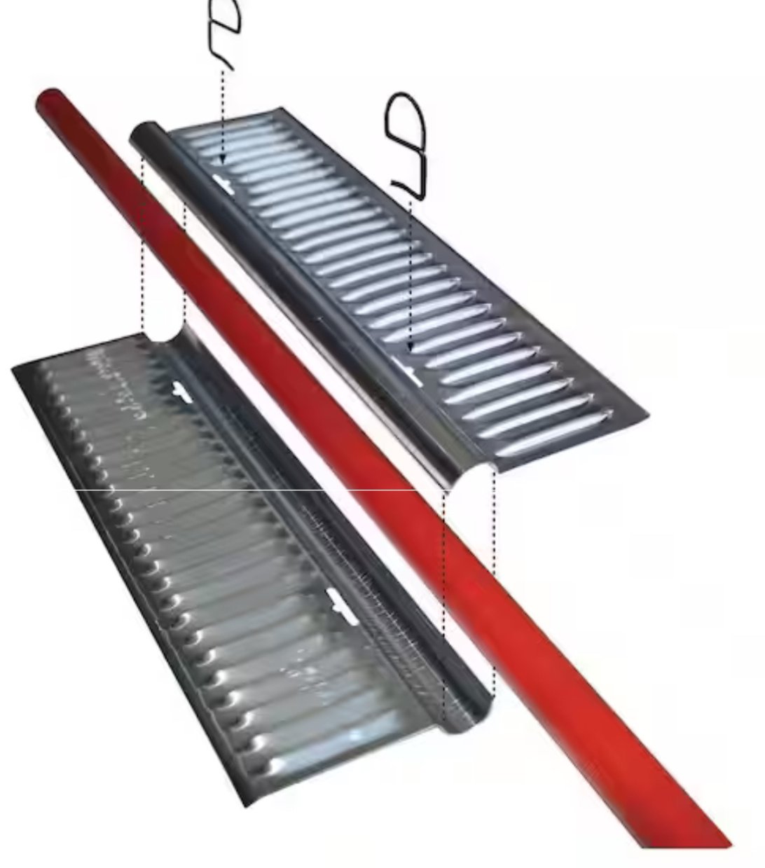

    UltraFin is an aluminum convectors that snaps on Pex tube to increase convection. Either these or the fin tube can work fine
    the fin tube is probable even better than these two options for getting the energy from the tube to the joist bay. Generally 140f and higher SWT required
