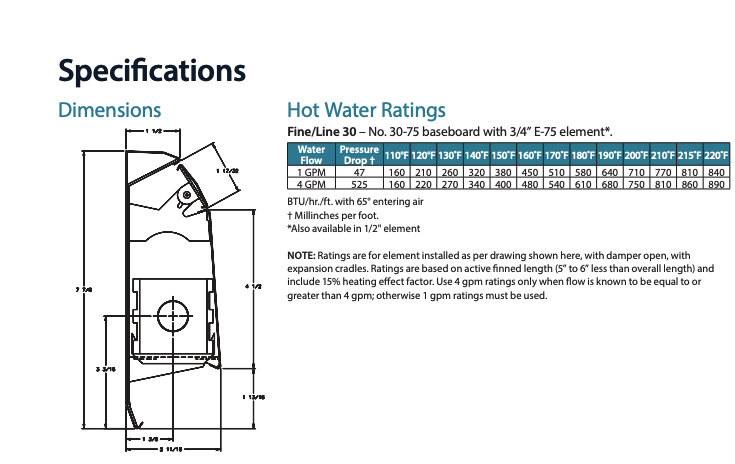

I have 1950s baseboard (75 linear feet) spaced around perimeter of house. Am trying to find charts of its output. The element is 3/4 copper, fins are ~1.5 deep, 3" tall, ~5 AL fins/inch. The casing is ~ 9"x2".
I have several "current day" SlantFin Charts. Can I use these?

The SlantFin #30 is a square element, about 2X2". Sounds like yours is taller but narrower? And the enclosure is taller.
Fin spacing has some to do with output also.
These chart might get you in the ball park, yours may be a bit higher output

If you can't find it use the standard 2 x 2 element about 550 btu/ft at 180. It will be close enough. 75 x 550=41,250.
I had found the Slant Finn 30 table/chart, 2x2. I didn't know if it would be close enough.
