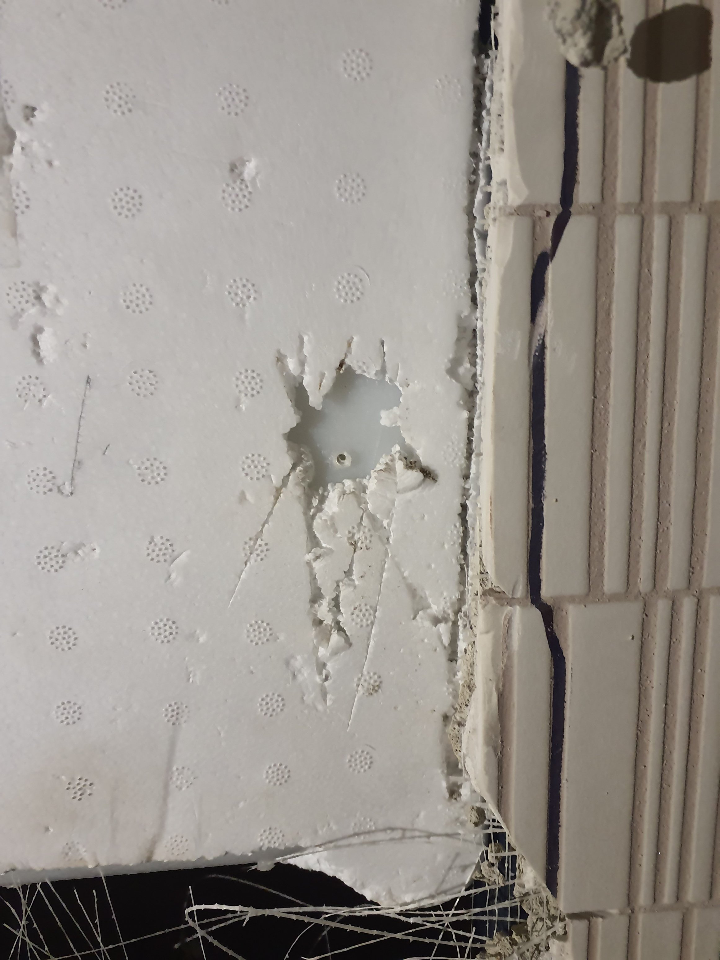

Have a little story to share hope someone will learn something
So we have this little renovation in the house remodeling the toilets the kitchen and installed 2 residential wall mount toilet carrier everything went fine we finished the copper and tested everything filled up the toilet tank and let the rest of the people come in and do their work
We came back on the job several months later and we noticed that the water is shut for the apartment was wondering who did that we started doing the installations and sure yes we open the water and the neighbor downstairs start calling up it's gushing water in my apartment
Of course the owner went crazy on us what's going on and then the searching started where it's leaking what's going on and sure there is a hole from a screw the toilet tank
So this guy absolutely saw what he did pull the screw out close the water close the walls put the tiles and now we had to rip up everything to get this repaired

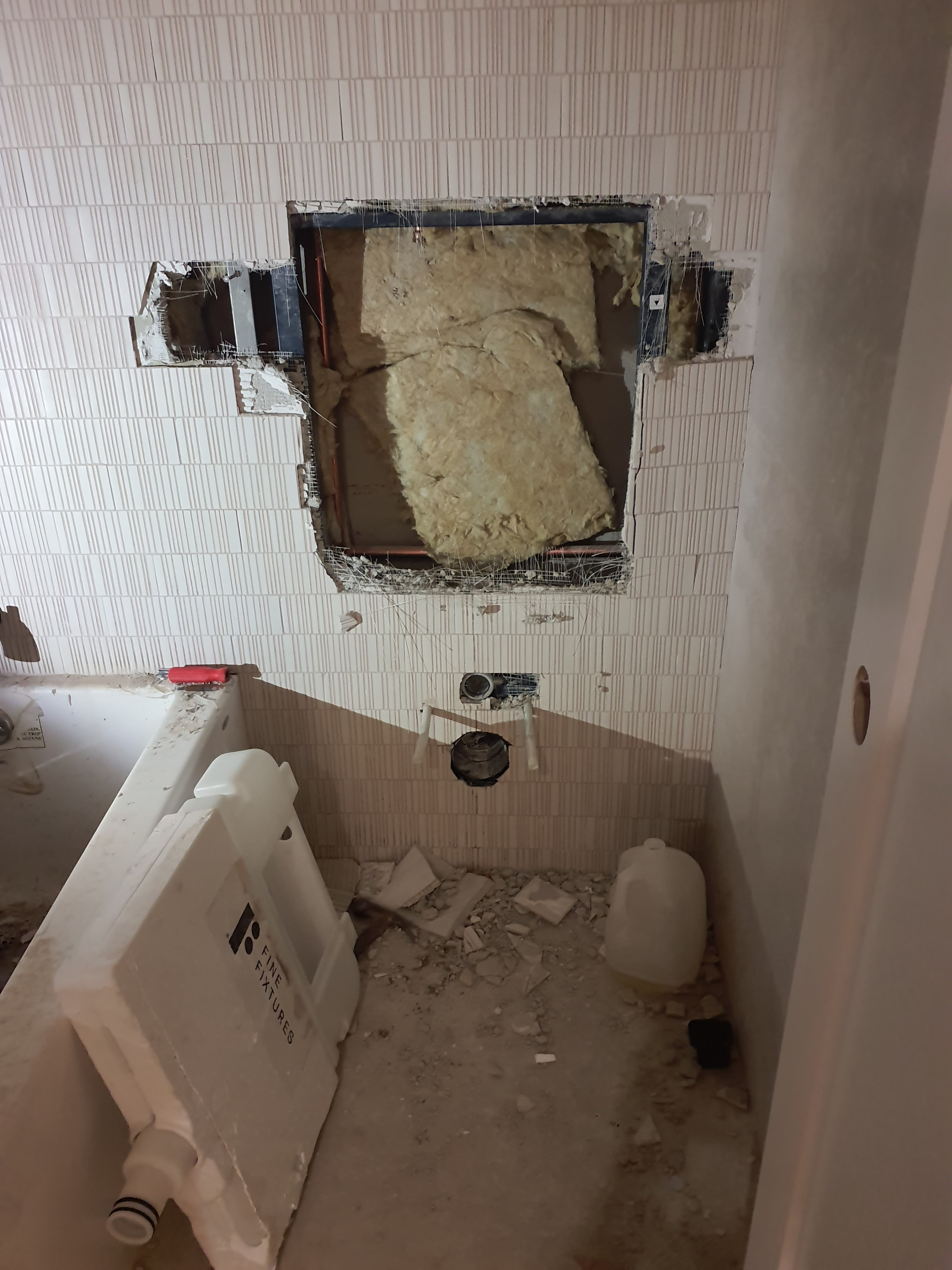

But yes we gathered the courage we did what we have to do opened tiles replace the tank and now the toilet is working b"h
One nice day of work hard to describe the pain and the sad feelings So PLEASE if you ever put a screw in a toilet tank or in any other pipe for that matter notify the people don't just close the the water and walls on it because then it's worse for everyone THANK YOU

    i think that is going to happen sooner or later where you have to rip the wall open to fix something if you bury a toiler rank in a wall.

    unless you design it with a full access cover.

    You can remove the flapper and fill valve and replace when needed through the flush cover it's though but doable (actually maybe only my hands can fit in there they skinny enough)
    The only thing I have realized now on this repair job is the O ring at the bottom of the tank connection, rubber is somthing I hate to see buried in the wall maybe that's different with certain models

    I don't think there is an issue with a toilet tank in the wall as Any water line in the wall can eventually cause you problems to rip out wall going how many floors down... I have seen damage 4 floors down from a screw in pipe behind the kitchen started leaking 3 years after house was built
    Here in Brooklyn every inch counts and it counts a lot🤑

    It's always frustrating when someone messes up and tries to hide it, leaving someone else to take the wrath of the homeowner and then fix it.

    Agreed. It's always best to come clean immediately when something like this happens.

    I could have done a flushometer probably but people don't like it in residential and also it's not that much space savings

    Kind of surprised the plumbing codes don't require a steel plate for protection of something that vulnerable hidden in a wall, like they do with many other plumbing and electrical situations.

    Kind of surprised the plumbing codes don't ….have a service panel requirement.

    I don't want the government involved in the this we have enough already…
    If Manufacturers should make them with that steel plate maybe some of us will pay the extra 💵 (recently I become among those who would 🤔)
