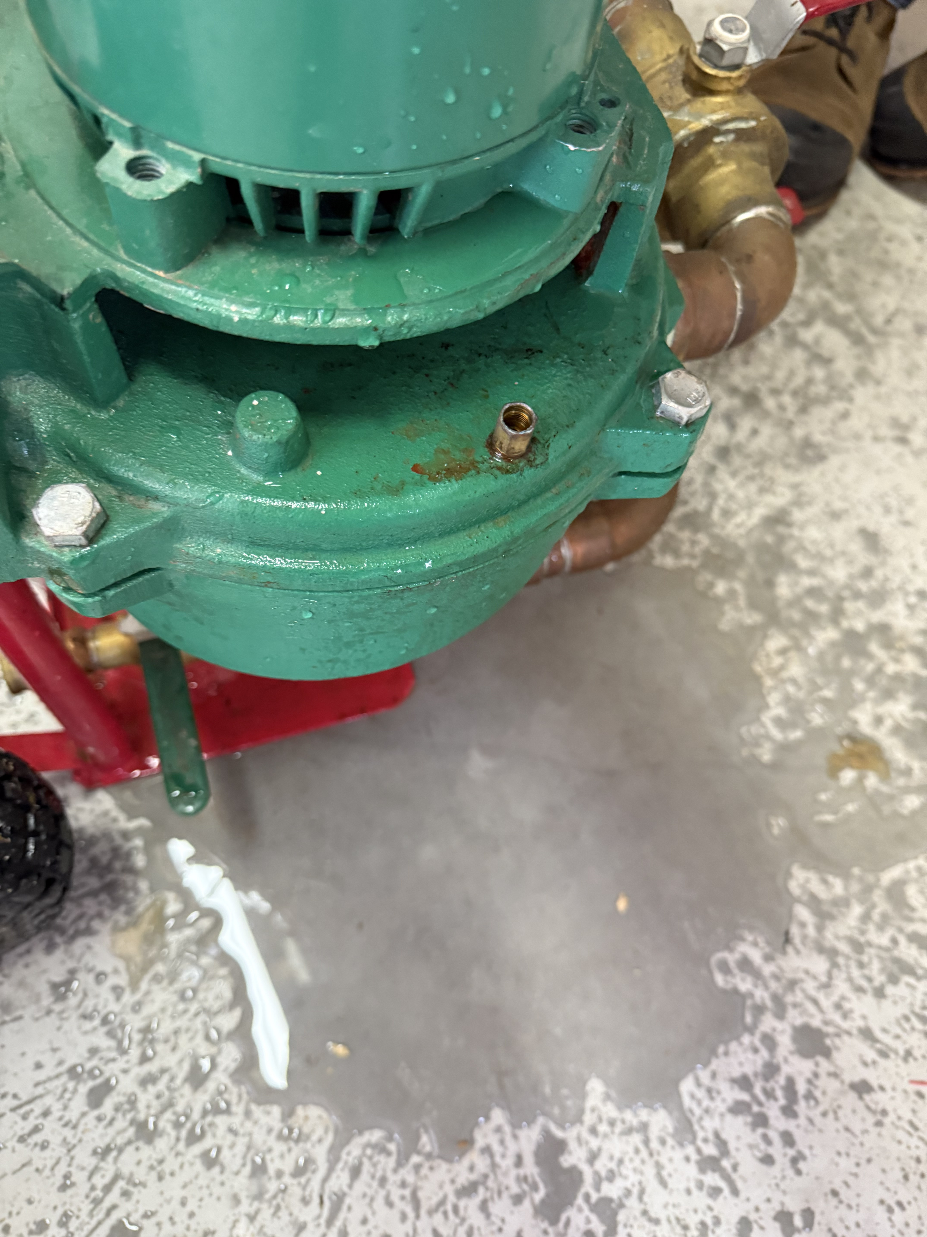

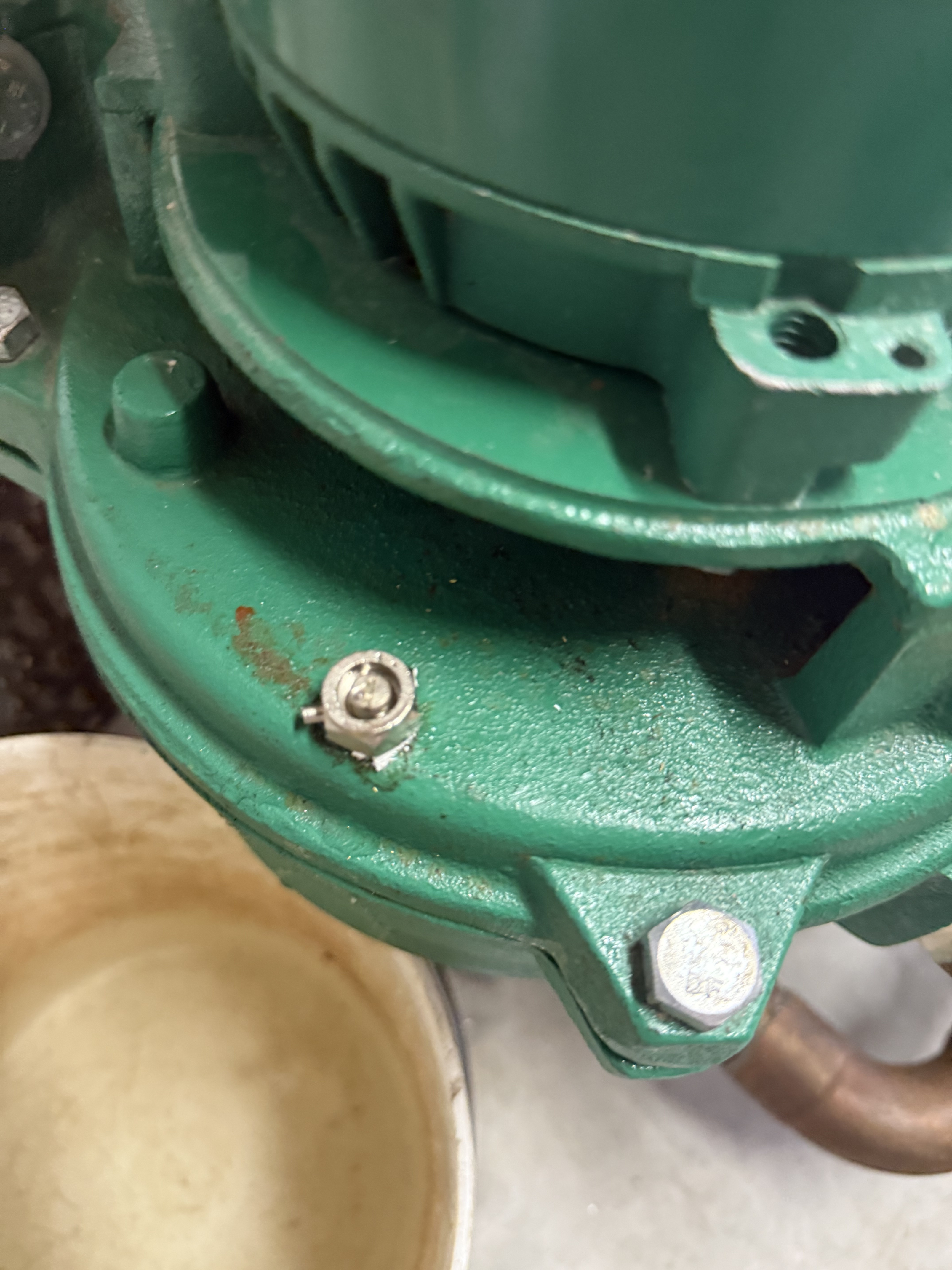

My Georhermal pump cart- somehow lost its bleeder Petcock. If there’s a better word for it, please let me know. I have no idea who to ask, should I call Myers?
I was able to stick a foam ear plug into it, made a little mess on the floor, not too bad. But I need to mix some ethanol, and don’t want to be making a mess with potent stuff.
Thanks for any advice
Edit- 1/8 inch ips is too large to fit in.

    PC7060 Posts: 1,980

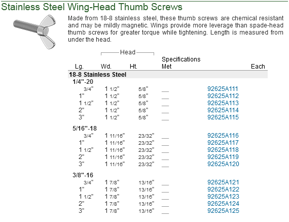

    try machine screws, maybe 3/8-24 or 5/16-24

    109A_5 Posts: 4,759
    How far could it have gone ?
    Is the bleeder Petcock thread into the casting 1/8" pipe thread ? Maybe just put another valve on it.

    GW Posts: 5,259
    It’s like a wing nut thing that allows you to bleed off the air from the impeller area of the pump. It’s not inside the threads- it’s simply gone.
    It’s somewhere between the last job we did this past winter and the shop and the job we are on now.
    Lesson learned - I’ll always tighten it from now on

    109A_5 Posts: 4,759
    Some older automotive radiator drain petcocks are a wingnut style.
    McMaster-Carr
    PC7060
    109A_5 Posts: 4,759
    Also McMaster-Carr.

    GW Posts: 5,259
    might have read just a bit too quickly—-
    the “body” didn’t want to budge when I tried to turn it out. It was egging. I’ll need to put a box end wrench on it.
    if I really strike out I can possibly pull the “body” and tap an 1/8 NPT,

    PC7060 Posts: 1,980
    if you figure out the thread size you’ll have more options.
    I don't see why you couldn't drill and tap it 1/8" IPS.
    I don't know if you do oil burners, but the bypass plug that goes in a Suntec oil pump is 1/16" national pipe thread. You could try one for size to see if that fits or get one from an old oil pump or from Webb

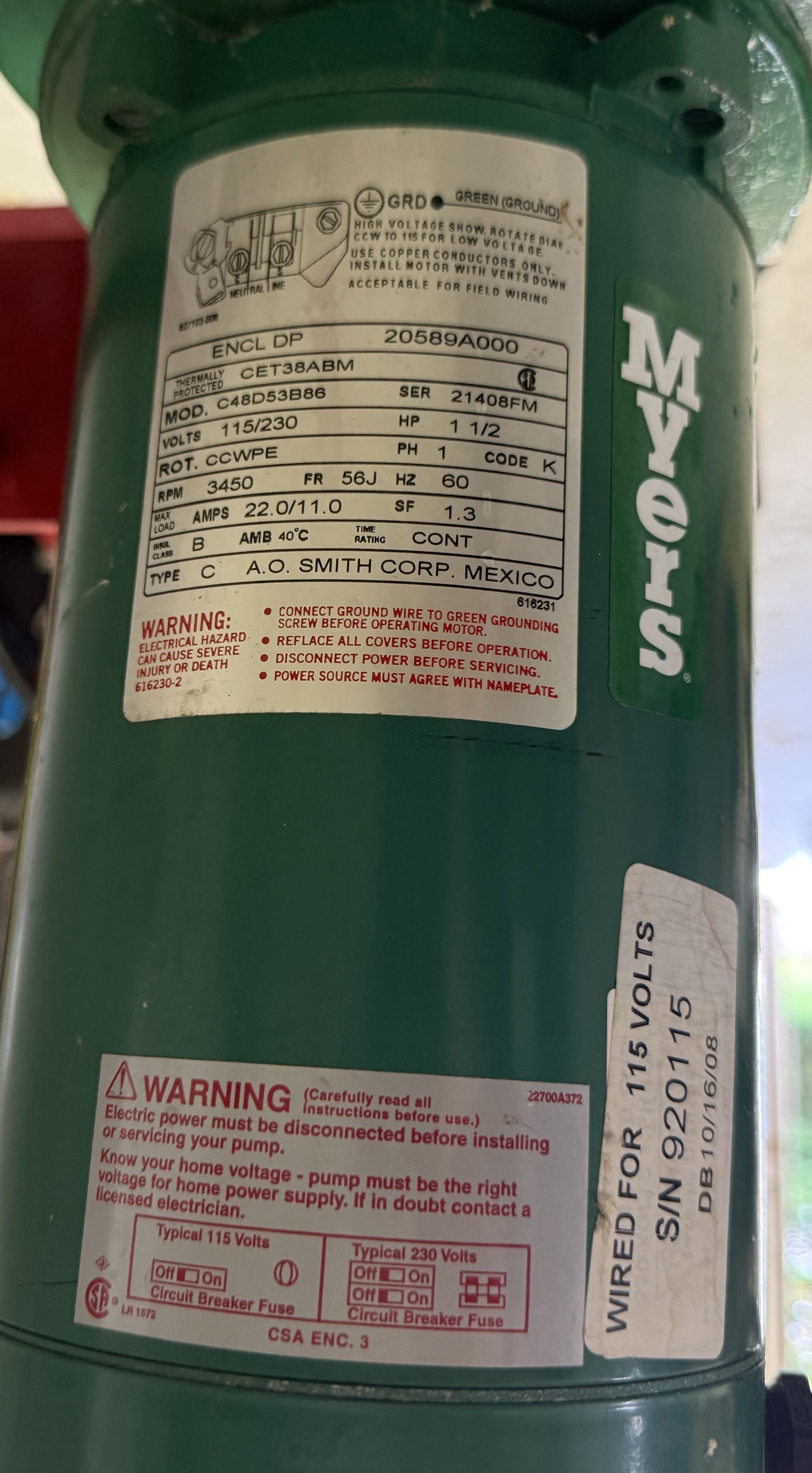

    @GW # you posted is the AO smith motor # not the pump. I found some myers pumps but could not find the bleeder and it was not listed as a separate part but I may have not had the right pump Probably could take that fitting out and silver solder something to it like a piece of copper and a valve.

    Ed cool I thought AO Smith was the motor only
    Good idea on soldering on.
    I’ll see if I can locate a bypass plug too

    I['ll bet it is an 1/8 npt if you take the brass out? A basic 1/8 radiator bleeder, ball valve, etc.

    I agree with others, very likely the tapping is standard 1/8" pipe thread.
    Intplm. Posts: 3,162
    Either one of these should get you fixed up. Those little wing nut looking valves that you sometimes see on air compressors have there place, but sure do fail a lot easier than ^^^^^^this^^^^^^^ type of ball valve.
    edited July 2025
    It looks like it is just threaded in to the pump, maybe heat it and try a 6 pt socket, might be in there with loctite. If you can put something in the middle of it that mostly fits before you try the socket so it doesn't collapse and shear off.
    It could just be pressed in but it looks a lot like it just threads in. The threads in the bleeder itself ideally would be acme thread.

    hot_rod Posts: 28,705
    that is the best option as it is hard to “bump” it open, or break off like the previous wing type
    GWIntplm.
    You just need to attach a key to the pump somewhere with a piece of wire.

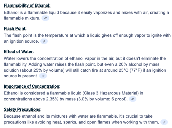

    An open frame motor and ethanol , be careful!

    We’re going to mix outside, no electricity. 50-50 should be fine I think.but I’ll do some more research and maybe lighten the mixture even more.

    Does the container have a red "flammable" diamond on it? Both E and M geo fluids are flammable. It's the vapors to be aware of.
    If there are potable water HXers, those need to be double walled.
    Stay safe!

    i believe over 50% ethanol solutions are flammable and under 50% are not. or my high school chem teacher and the moonshiners have the wrong concentration.

    the vapor is dependent on temp, right?
    The labels on the container have good, pertinent info.
    If the bucket is 100% that is the flash point number to be aware of.
    so around 50% it becomes an issue with wood alcohol. although i have never heard if the plastic tank of kleer view under the hood going up so it probably isn't that easy to get started at moderate temps.

    seems like I’ll be good at 20%
