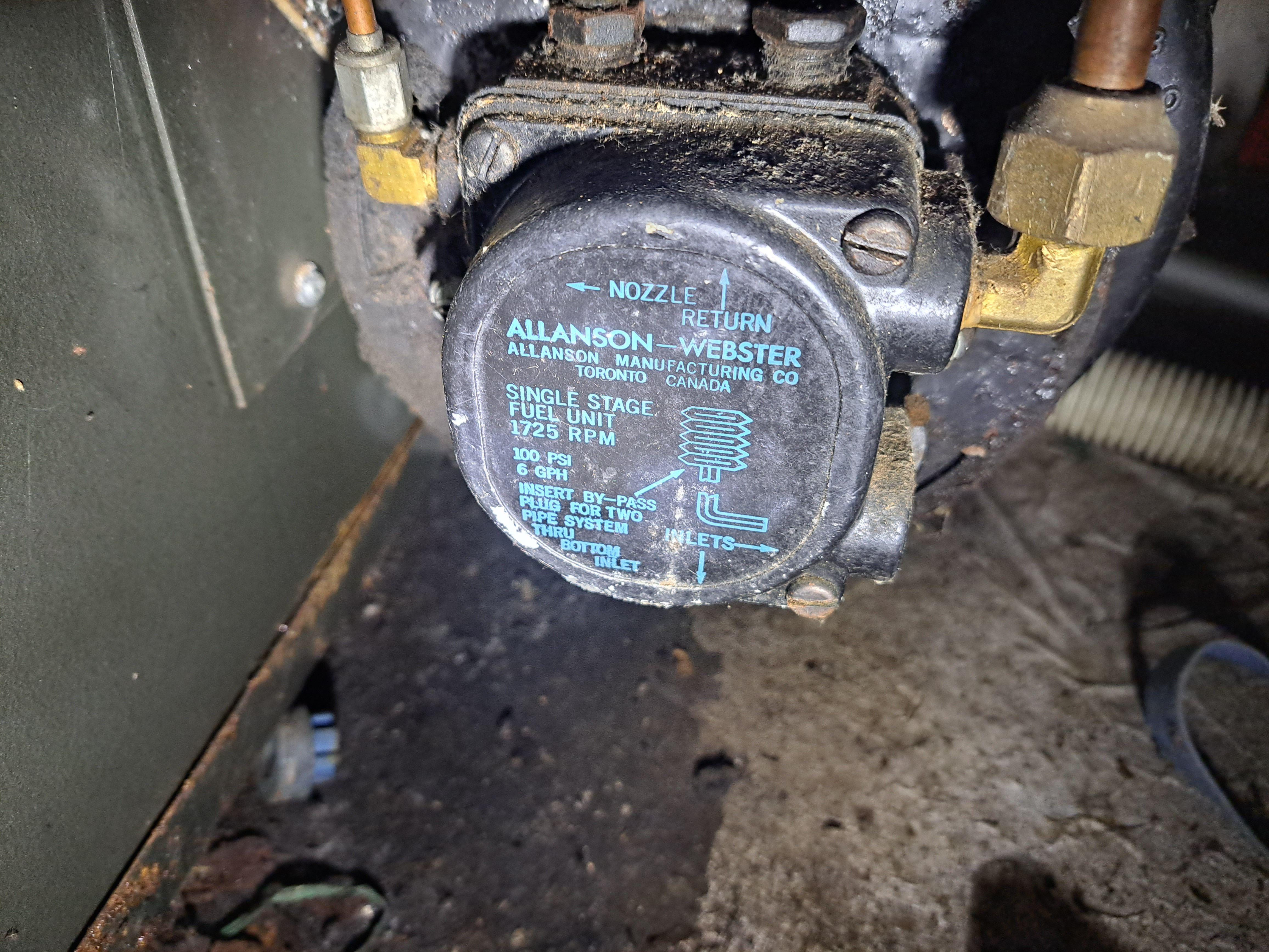

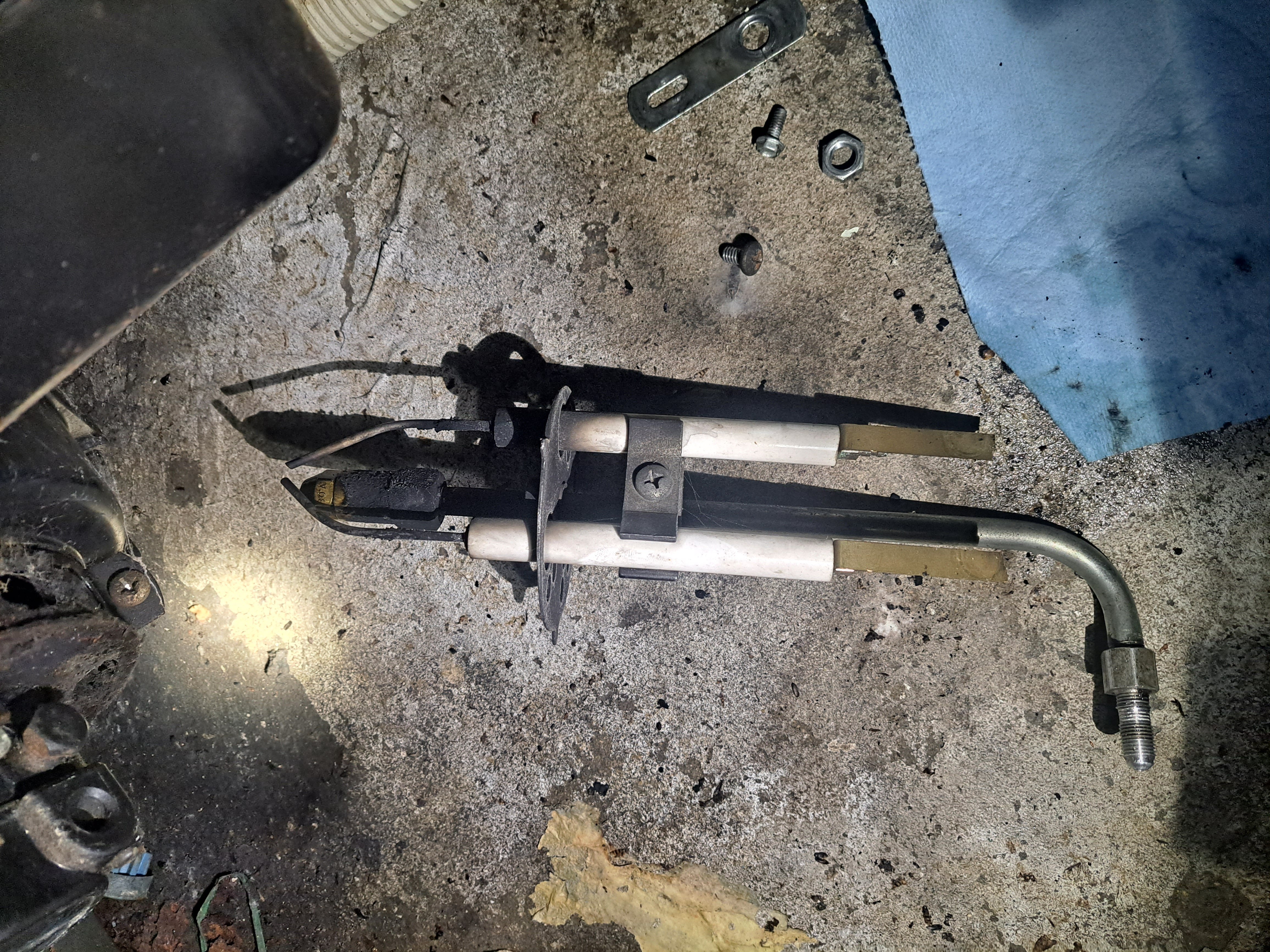

I have an old farm house with an old (80's? 90's?) Olsen oil furnace. I am looking at moving the furnace into a different (1960's) house that has just had a new basement built under it. The furnace still works and I like the simplicity and build quality of the old oil furnace. However, I want to be sure that I can still get parts for it. The fan motor is just a standard AC motor and the fire pot seems like it could easily be replaced with a universal Lynn Manufacturing Time Saver.

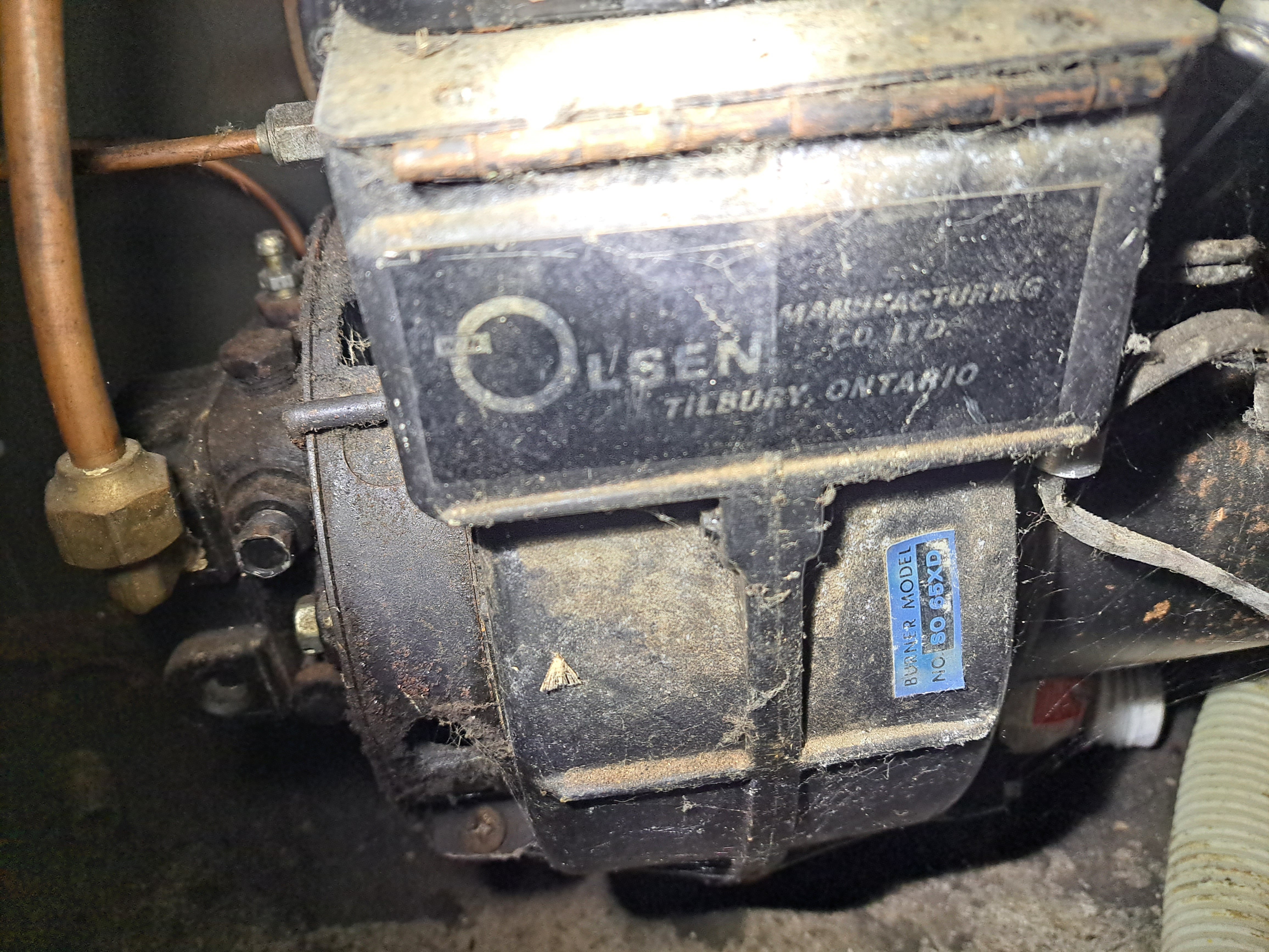

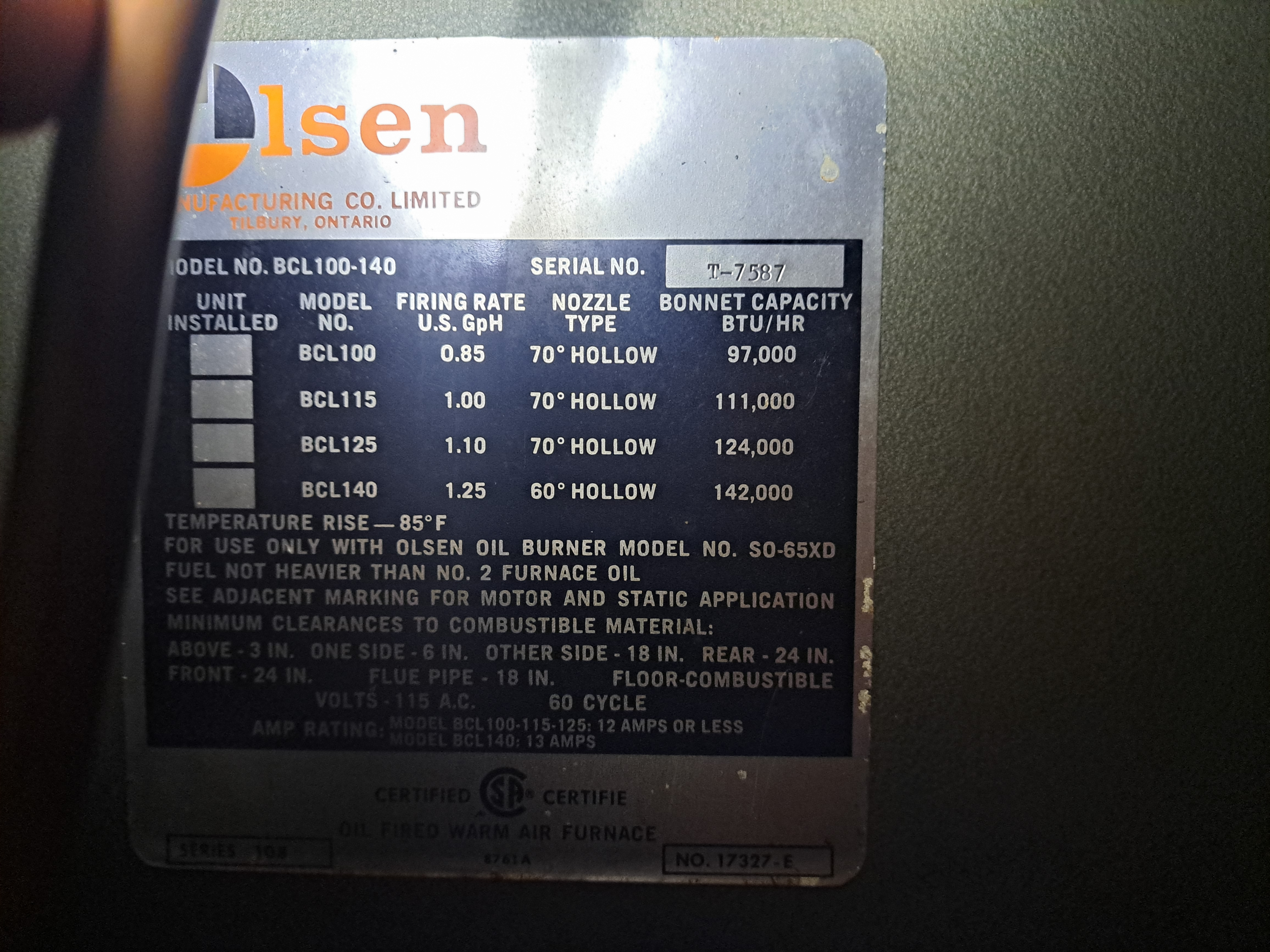

The burner is Olsen branded and everyone I've talked to says you cannot get parts for it and there is no replacement. However, it sure looks identical, or at least very similar to a Beckett burner. I am not sure if the furnace is a BCL100, 115, 125, or 140 as the name plate was never marked as you can see in the pictures. Regardless, according to Beckett's burner application guide, this furnace calls for an AF series BR200 burner with an F3 or F6 head depending on the size.
The only difference I can see is the Beckett pump runs at 3450 RPM and the Olsen pump runs at 1725 RPM. All other parts look identical as far as I can tell from online pictures.
Can anyone tell me if Beckett parts will fit this Olsen burner? And if not, would there be any issues just replacing the burner with the Beckett unit I described above?

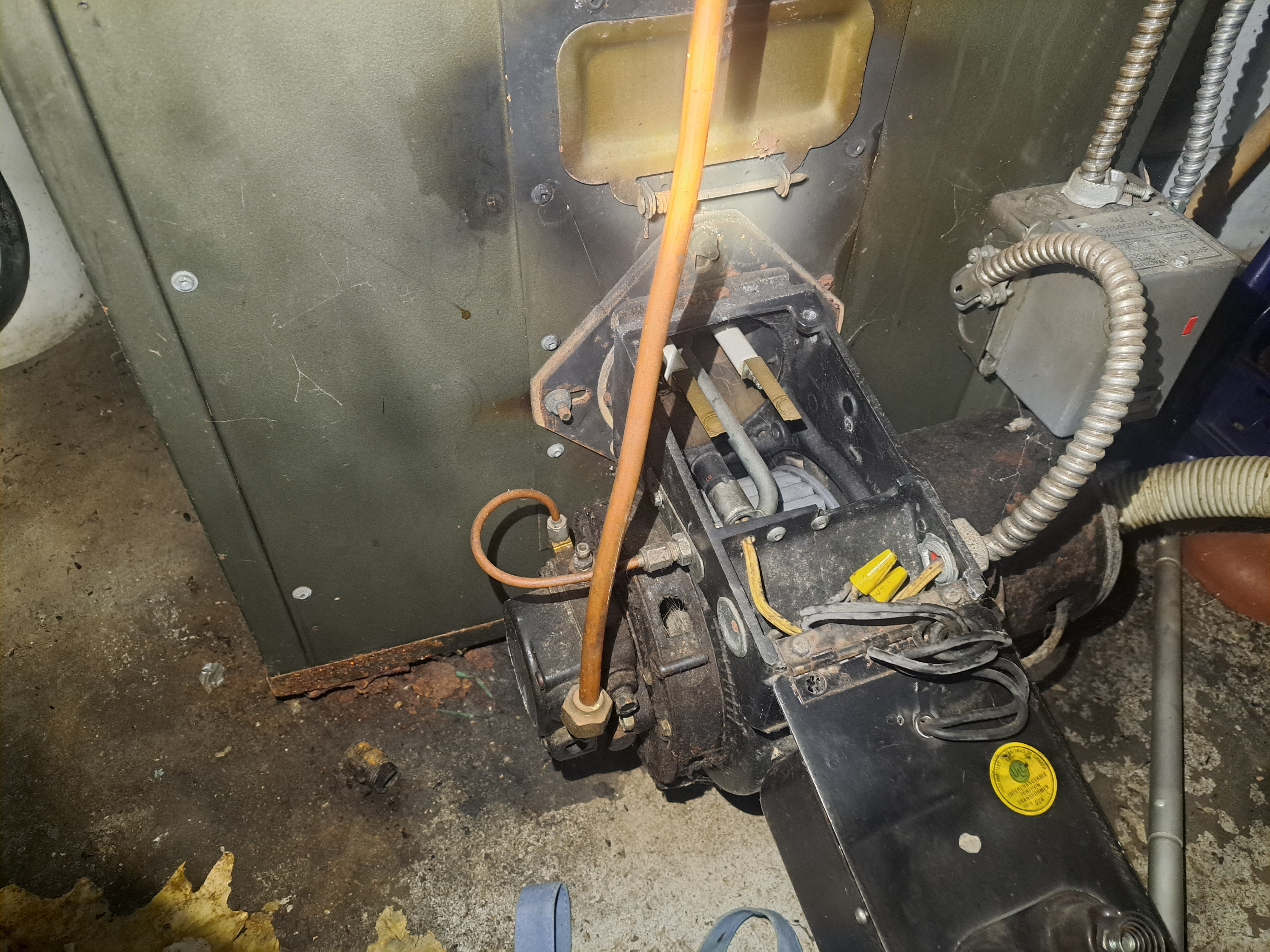

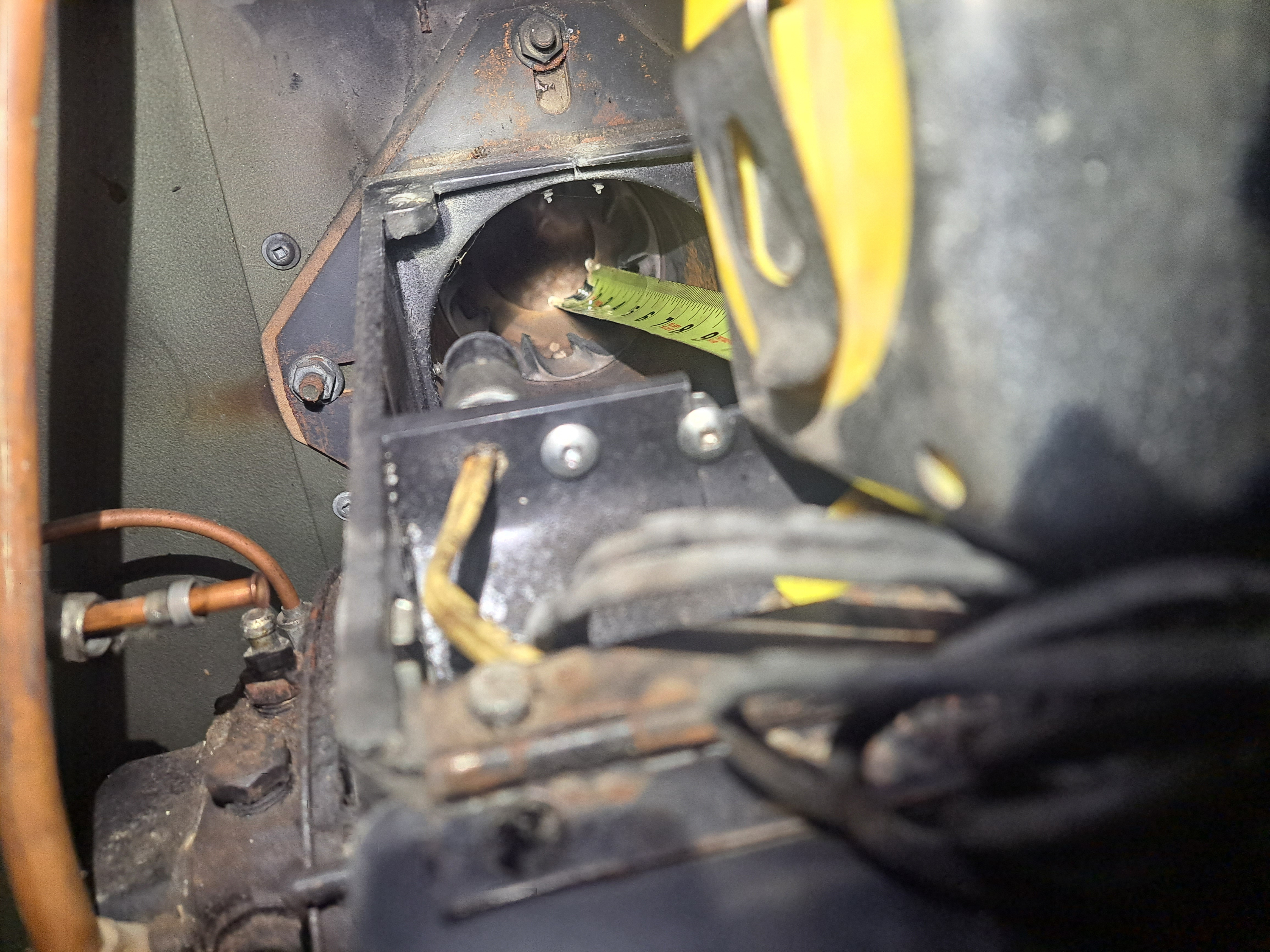

    The burner may be a Beckett AF but an AF shouldn't have a 1725 RPM pump. Can't see the burner….need pictures from farther back also look for model # on burner.

    I added another picture to the first post. The only model number is the sticker shown in the picture. SO 65XD.
    I'm not really too concerned about finding parts for the Olsen burner as long as I could have a replacement beckett burner sitting on standby.

    it’s not an AF. Look at the pic down the air tube.

    Steamhead Posts: 19,007
    The "S" refers to the chassis. The plain S was not flame-retention and the SR was. Both were 1725 RPM. We still find the SR in some older boilers. The SF was the same chassis with a 3450-RPM motor, which could move more air and had higher GPH ratings.

    As soon as you see its not a retention head burner, you take the whole thing to the scrap yard. It looks like a Beckett housing, but that's it.
    Not a Beckett. Not sure who made that one………..
    Semi-retired
  • rick in Alaska
    rick in Alaska Posts: 1,533
    I am confused. Everything about that burner says Beckett. Except the cad cell location. What am I missing?
    Rick
    EBEBRATT-Ed
    I agree @rick in Alaska looks Beckety. They was a burner made in Canada (don't know if they are still made) that some referred to as a "Canadian Beckett". I think it was called Arrow?? I don't know forgot the name.
  • rick in Alaska
    I'm thinking just rebadged Beckett. I had an old Chevron furnace with a "chevron" burner on it. It was definitely Beckett.
    Rick
    AREO not Arrow. There is one for sale on e-bay that looks similar. And the one on e-bay is 1725 rpm as well.
