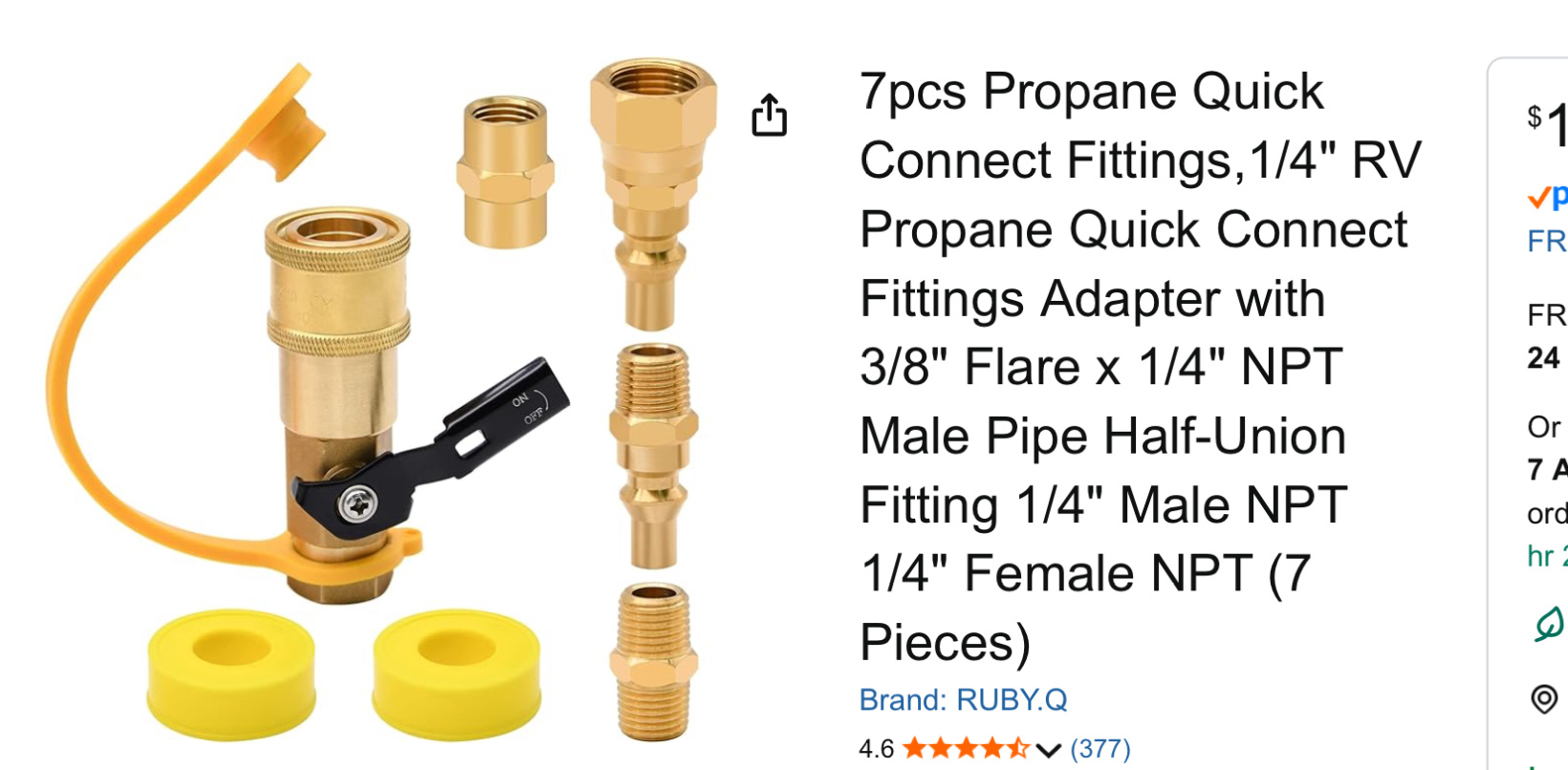

    hot_rod Member Posts: 27,415
    edited June 2025
    this with a quick connector and rubber hose to the 3/4 line. I don’t know of any quick connector that goes into the tank POL that is a specific thread and connection. After the tank reg shown here you can adapt to an LP approved hose
    Is this what you are asking? Leave the POL fitting in the tank, quick coupler for the reg into the POL. Or a rubber LP hose from the POL quick coupler to1st reg.
    I would not hang the reg off that soft copper tube, the reg needs some support.
    This is a soft POL, with the O-ring missing. The O rings do go bad after time, but they seal better than the "hard" brass to brass POL. A hand wheel works on the "soft" o-ring POL, not the hard brass ones, those generally need a wrench.
    These are readily available parts, get the couplers that are LP listed, these are standard air compressor fittings.
