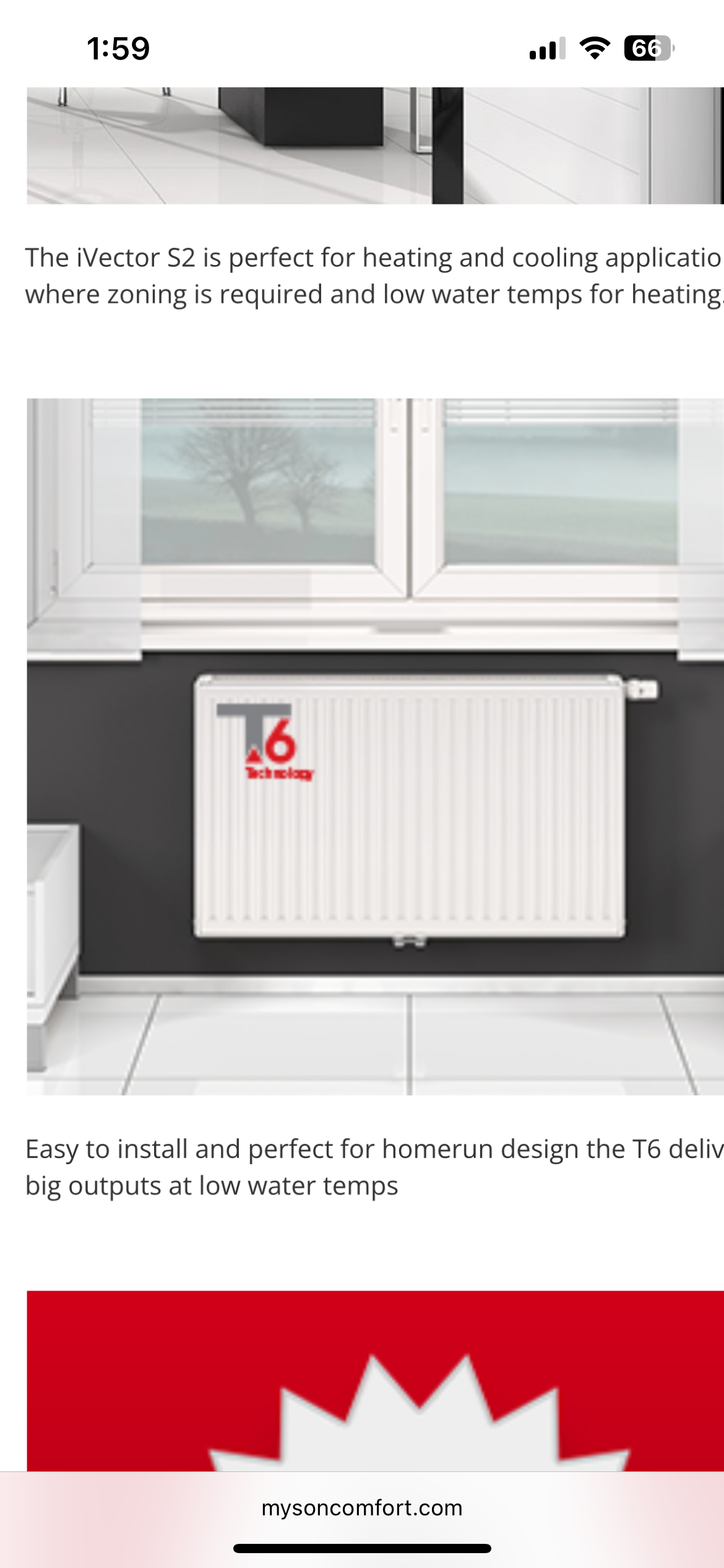

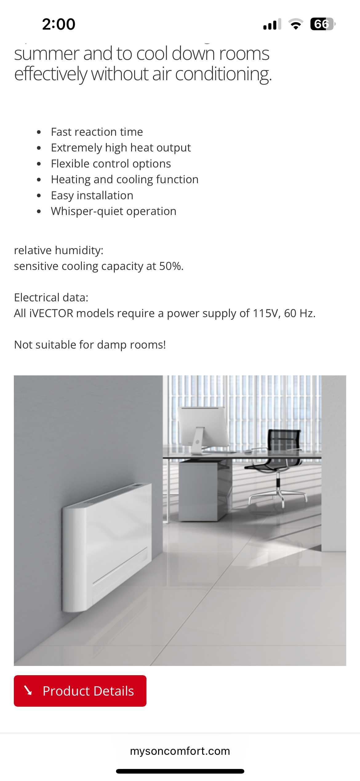

    hot_rod Posts: 28,704
    Myson is a popular brand. Some installers like the two connections in the center, a cleaner look.
    They also have an I-Vector for cooling
