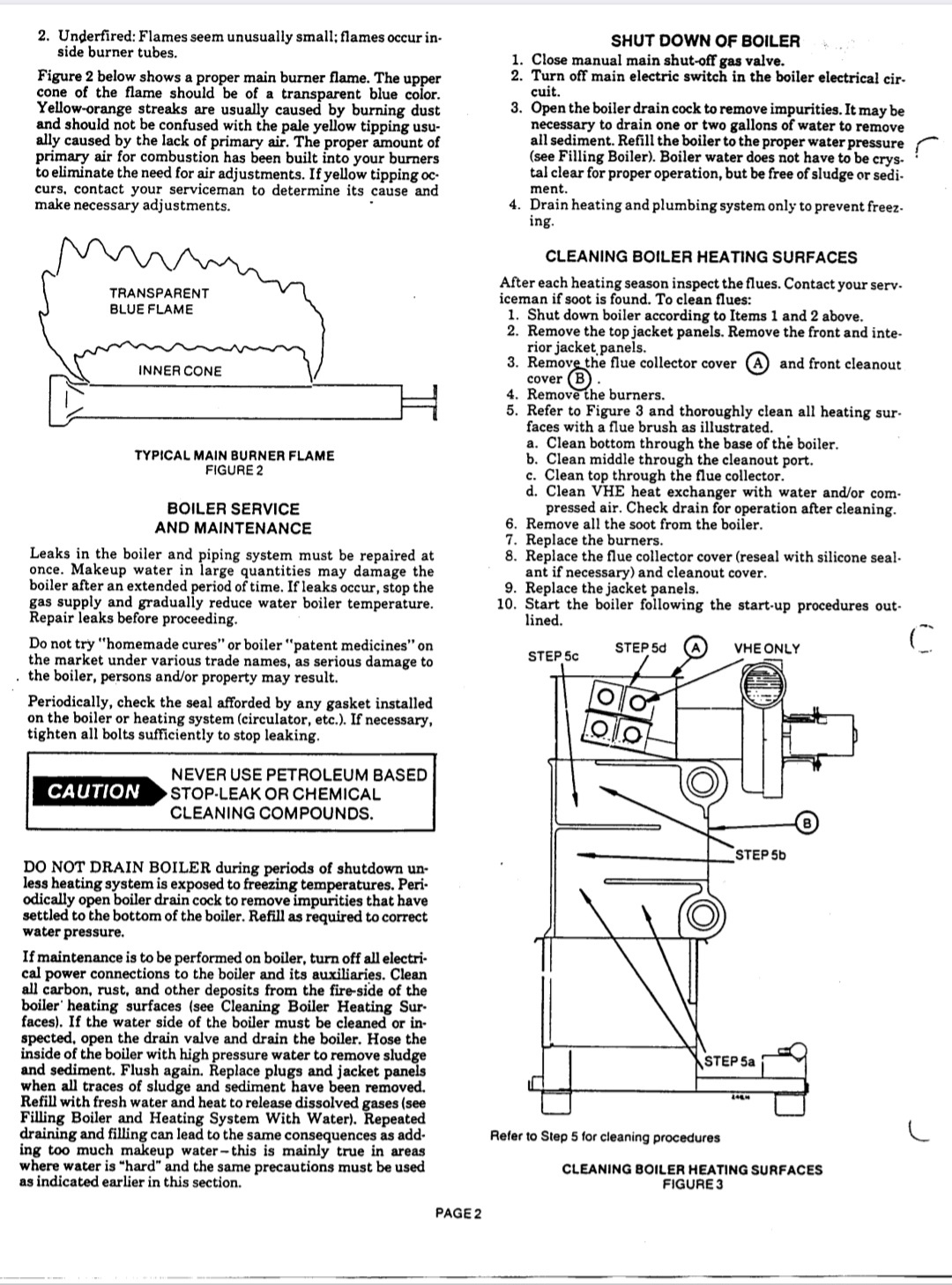

    I wouldn't think boiler temperature has anything to do with "Flame out of some tubes". Are you saying not all burner tubes light the first time? Then it needs service. When was the last time it was serviced? Is there a combustion report around?
    From the Homeowner Information Manual.
    It isn't boiler temperature but flue temp, the vent is drafting better when it isn't cold but there is some root cause that needs to be figured out.
