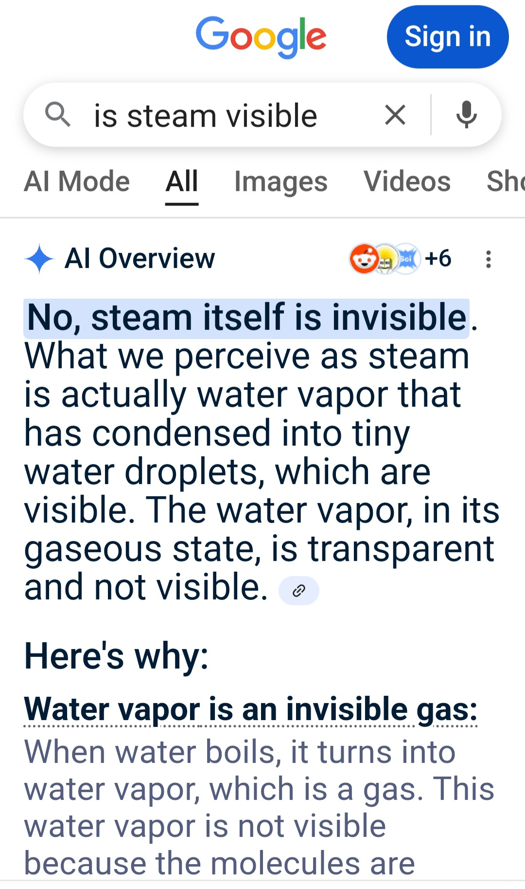

    I would ask the client to restate his complaint. Then ask why is it so important to see the steam. Is he not getting the same results other than visually? Then ask if he trusts Google's AI thing.
    His money back for the boiler (if you can return it), and he'll pay the labor for removal, right?
    Intplm.
    i don't trust google's ai thing… really annoying, i have to scroll past it every single time to get to the real results.
    what do you mean? the grammar of that post is correct. the science not so much.
