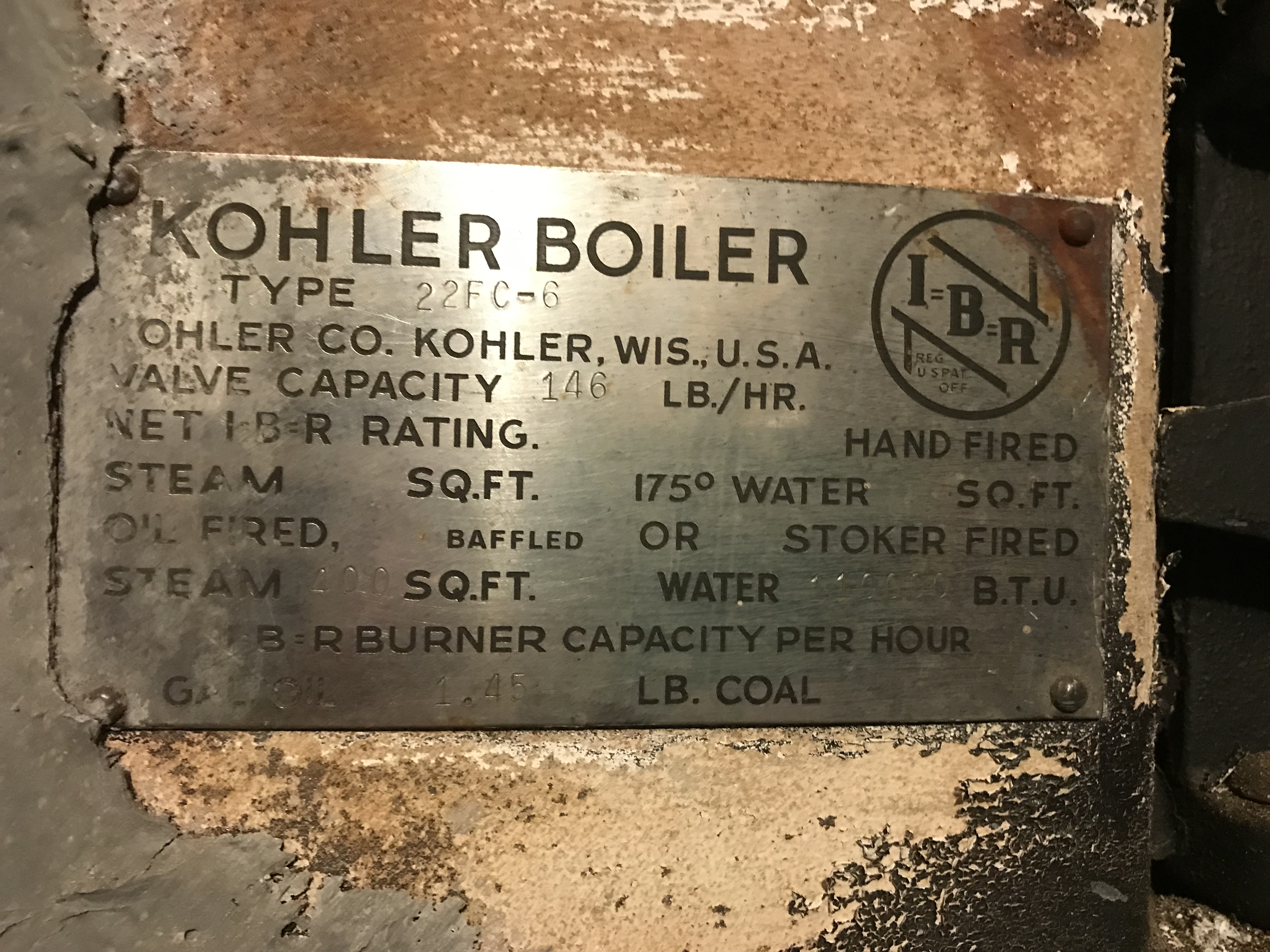

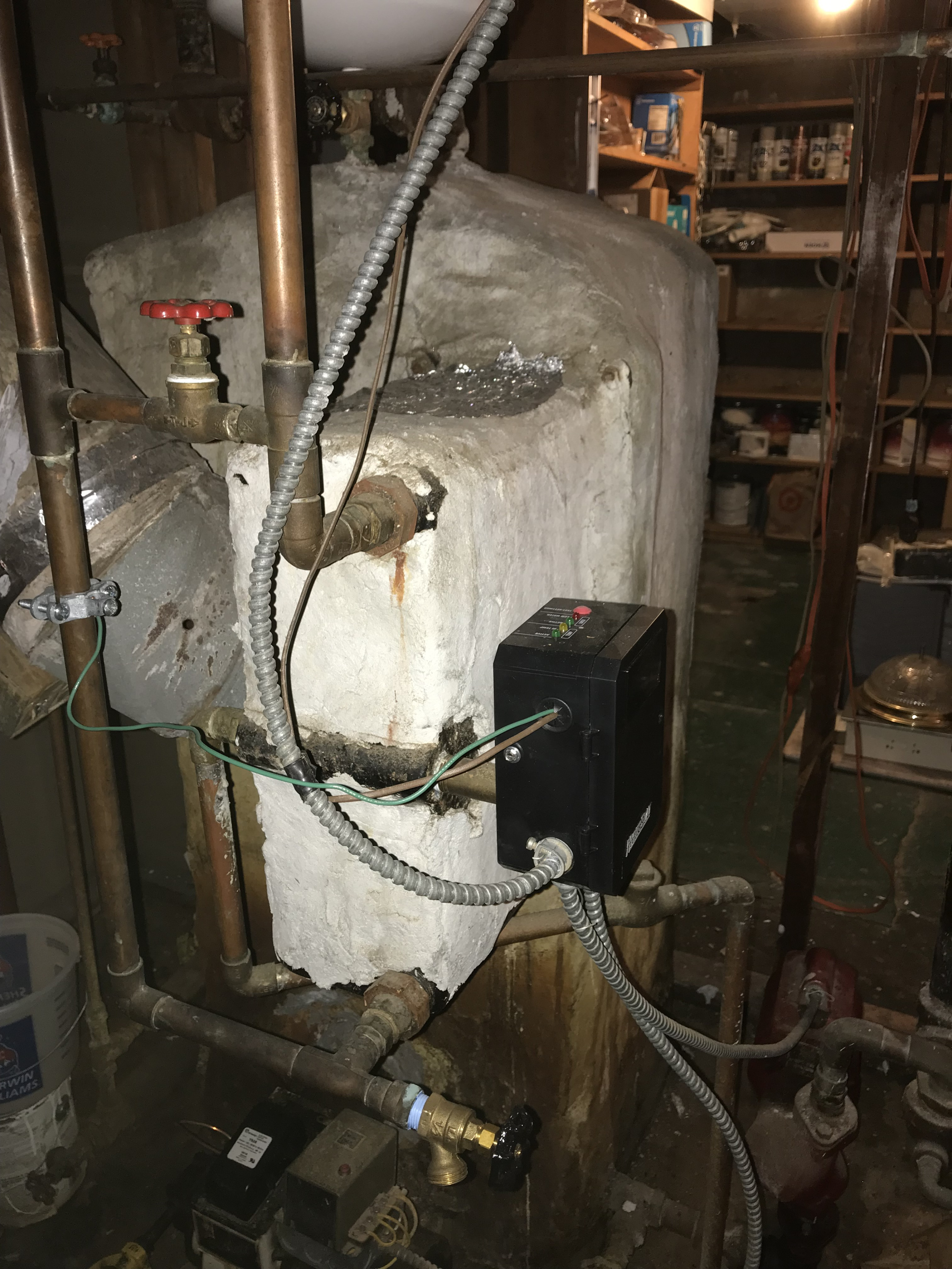

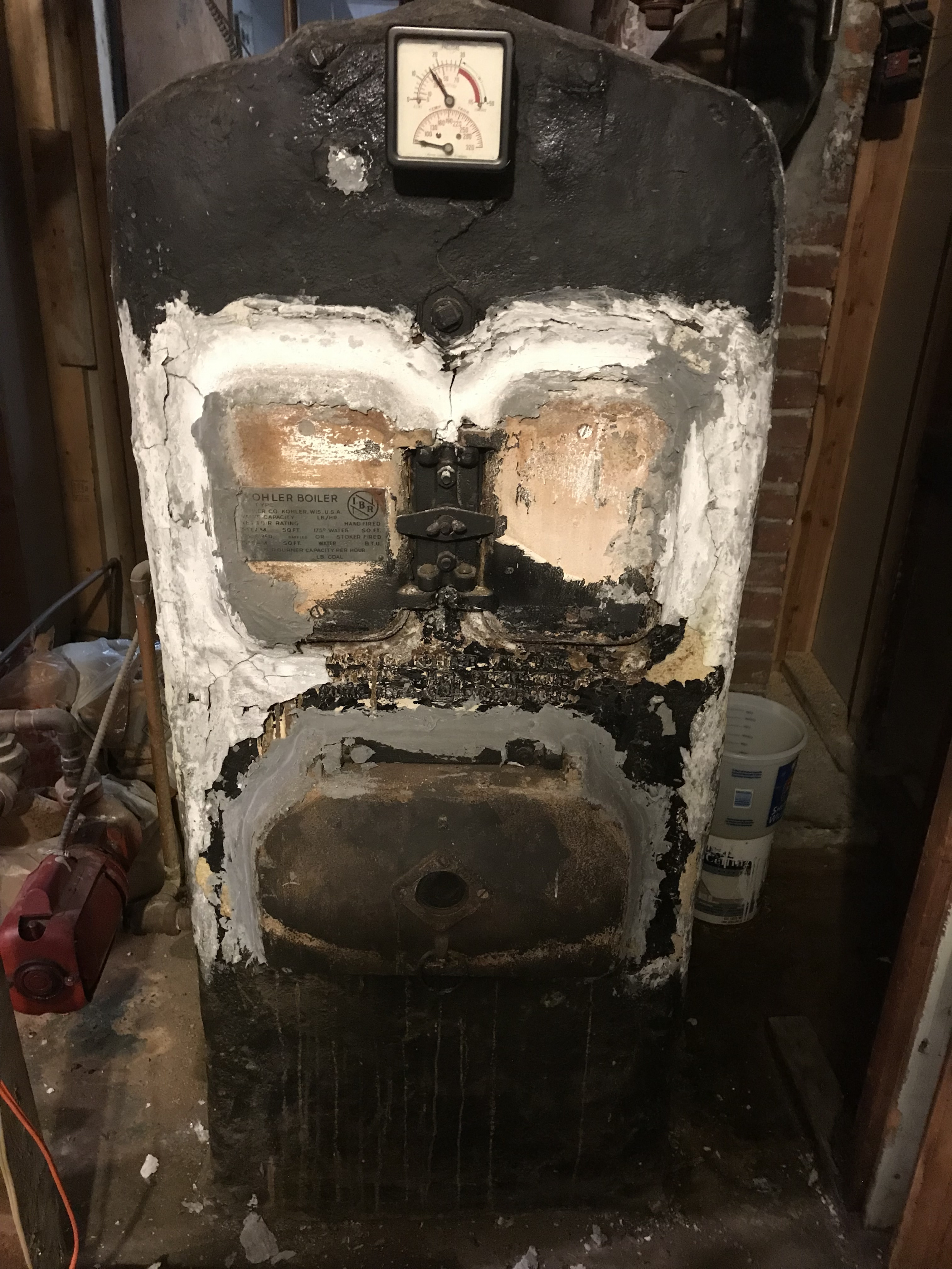

    Current oil boiler is very old, pls see 3 pics attached: Back, Front, and MFGR label. Not known when it was converted from coal and steam to oil and water. Had an old mechanical aquastat, high setting was 185F, when circulator started the water pipes shook violently. New aquastat installed, circulator oiled (?), hi setting was eventually lowered to 165F, pipe shacking almost stopped, now radiators never get very hot, but on cold days the boiler works almost nonstop, when it overheats, lets out a drip of water for which occasion I keep a bucket under the valve. Being mindful of its age and hi oil price, my (single) thermostat is set to 62-64F in winter. I’d prefer 70-72F after conversion.

    I never knew Kohler made boilers.

    That is old. I haven't seen a Kohler boiler in almost forever. What town are you in? Check the contractor link. There's plenty of good HVAC companies on the Island.
    Is that asbestos?
    The Hydrostat looks like a Rockstar next to the rest of it.
    Is there an outside entrance to the basement? Otherwise it's probably gotta be split to get it up the stairs. Thats going to be a messy one. Get all your good stuff away from the area and pathway.
