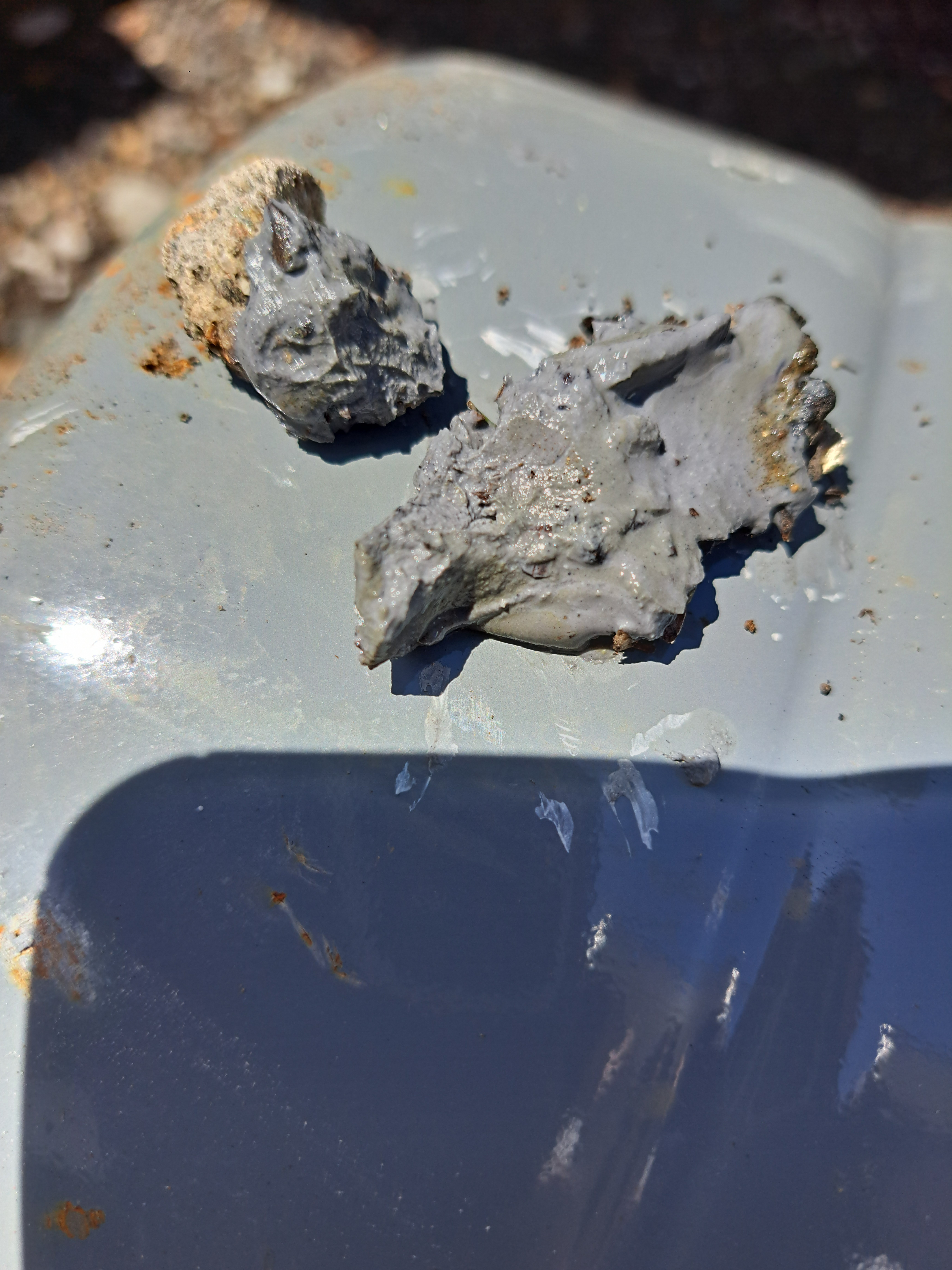

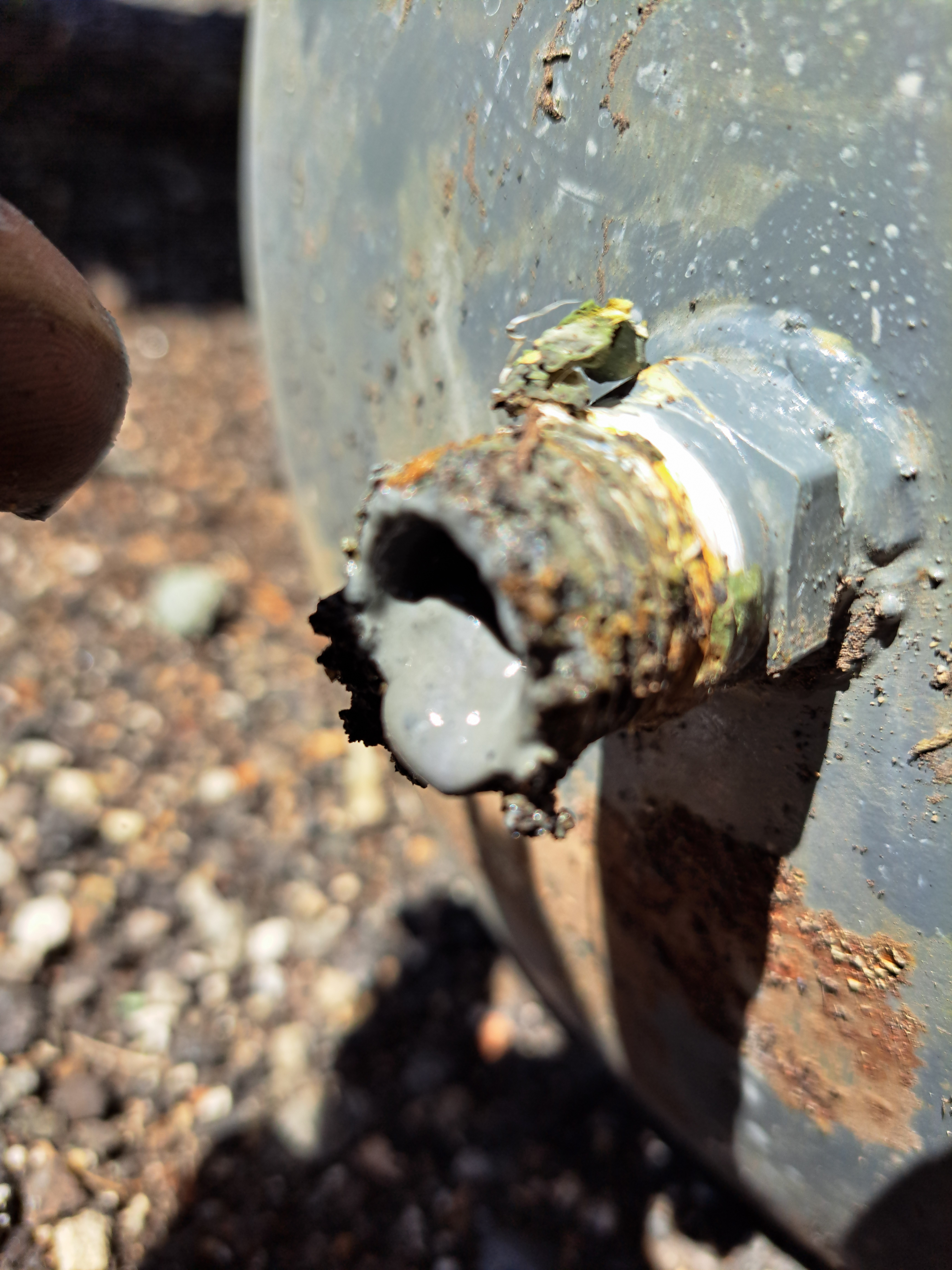

Expansion tank has this junk in it. There is anti-freeze in the system, makes me think of boiler seal. Never seen this collect in the Extrol before. Reminds me of old,stale anti-sieze. Disreguard the small particles/stones.

    Could be the flexible, silicone cast iron boiler coming apart? 😉
    It's tough to know what is in the sludge, what was the ph of the glycol?
    It is a mixture of all the metals in the system probably if the fluid has become aggressive.
    Regardless the system needs a good clean and flush with a hydronic system cleaner.

    Draw some off the bottom of the boiler and I do not get any of this junk. That is where stuff likes to settle, figure I would find something but nothing there but no.
    Nothing with a purge either but lives inside the Extrol. Time cut it open..

    aluminum can make stuff like that if there is aluminum in the system. maybe the bladder is degrading and that is it and the dye in the glycol?
    looks like the old pre teflon type pipe dope.

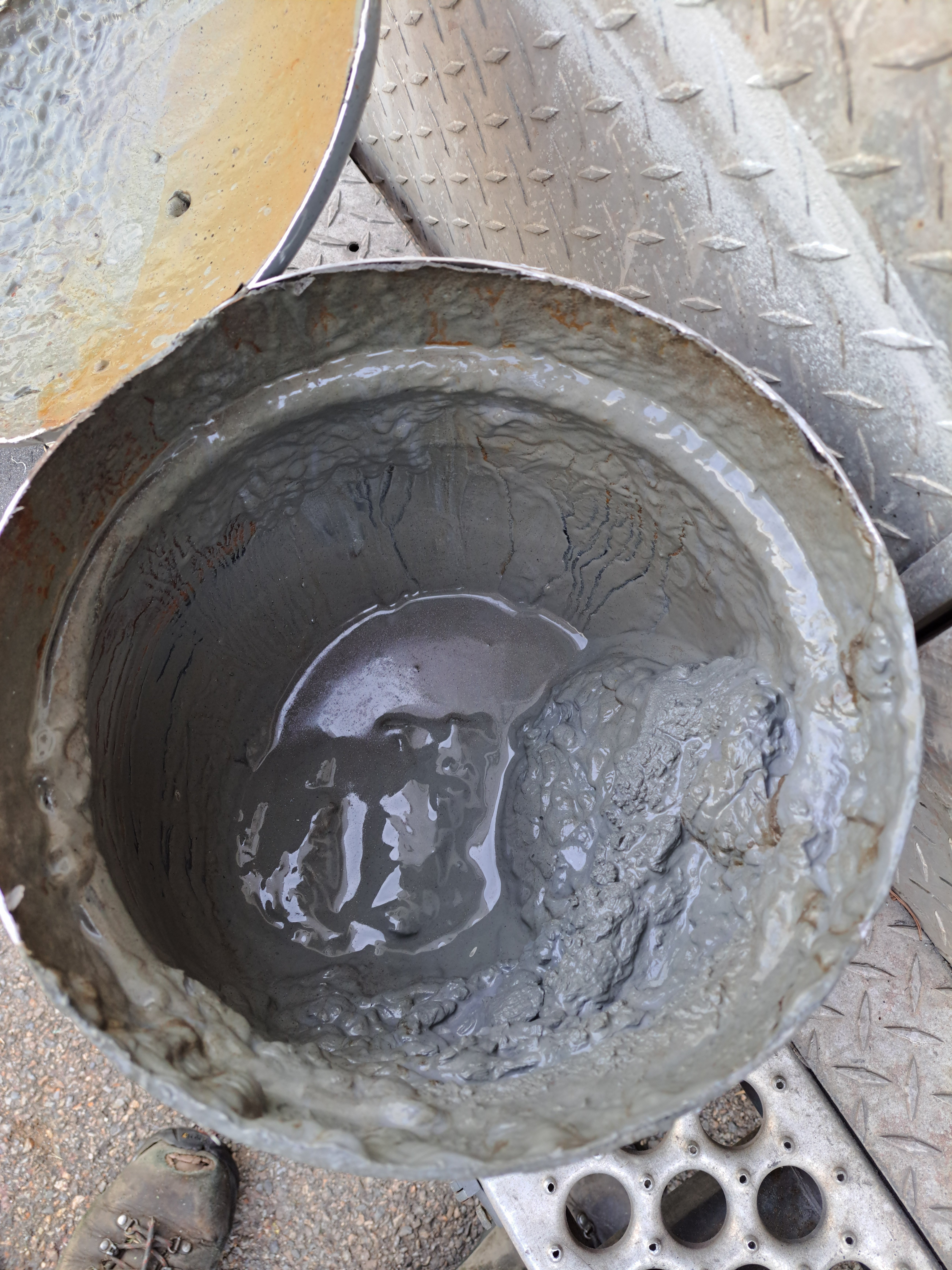

    Boiler water is clear. Bladder is still in the tank with no degradation, completely collapsed.
    Check out the pic, that is inside the tank. Leaning towards some sort of growth, Bacterial,fungal?
    No corrosion at pipe joints, air eliminator, checks and so on.
    With that much junk if floating through system the air handlers would have been plugged. No complaints on that end.
    Antifreeze related 100%

    automotive glycol? It contains silicates that can form a sludge?
    Does it smell, iron bacteria smells like rotten eggs.
    Most automotive glycol in the us contains an additive that smells like dead fish too.

    Smells like antifreeze that is in the system.
    Can see how it could be pumped in and reside in the extrol.
    Has consistancy of hydraulic cement

    I certainly agree that it is from the antifreeze. Just out of curiosity what kind of boiler is this? Is it piped with the circulator(s) pumping away from the air separator and expansion tank? Are the air handlers piped with PEX?
    Glycol/Antifreeze is really nasty stuff when it's not maintained religiously.

    Buderus 115-4, Copper, Sched-40 Spirovent. Wirsbo 1'' hepex about 4'
    **NO ONYX
    Expansion tank on bottom of spirovent. Pulled head and element, Zero junk on element
