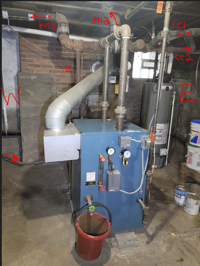

Hi everyone,
I moved into a Rochester, NY 2600sqft 1910 home in Fall ’21 with a ’96 Burnham IN-7 feeding a single pipe steam heat system. It has been my first experience with steam and the first few weeks with it were frankly awful. After coming across this forum and reading “So you got steam heat…” and “TLAOSH Revisited,” I added main line vents (“Big Mouths”), insulated the mains, lowered the p-trol to 0.5psi in/1.5psi out, properly pitched the radiators and fully opened the valves, repaired/replaced/fine-tuned radiator vents, etc. and since then it has been mostly quiet, all the radiators heat evenly, and I have grown deeply attached to the system and its comfort - coming home every evening during our long cold winters feels like getting hugged by warmth. Sadly, this winter, I noticed needing to progressively add a lot more water to the boiler (used to require once weekly) and eventually found the source: several sizeable holes in the boiler above the water line. I want to stick with steam and replace the boiler, but expertise in western (or "upstate" if you're from the big city) NY appears limited.
Question #1 - I have a total radiator EDR of 424 (most are ornate column radiators) so the 210k BTU in Burnham IN-7 (rated for 542 sq feet) is oversized. I was told in several estimates to just stick with ~200k BTU because I don't have symptoms of being oversized (only ever cycles on pressure on a cold start or if it needs to satisfy a t-stat more than 2 degrees lower than target), but it seems like a ~175k (~454 sq ft) would be more reasonably sized? It’s currently vented horizontally through an exterior chimney (the flue is a mess) at ground level into a Field Controls power vent that, like the boiler, dates back to '96 and is quite loud. Thoughts on replacing with a Burnham SteamMax STMX175N-RH-PA, using the same ducting & power vent (would clean or replace) configuration?
Question #2 – I don’t understand my piping very well. Attaching pictures; ignore the ineffectual prior homeowner duct taped insulation (replaced with fiberglass).

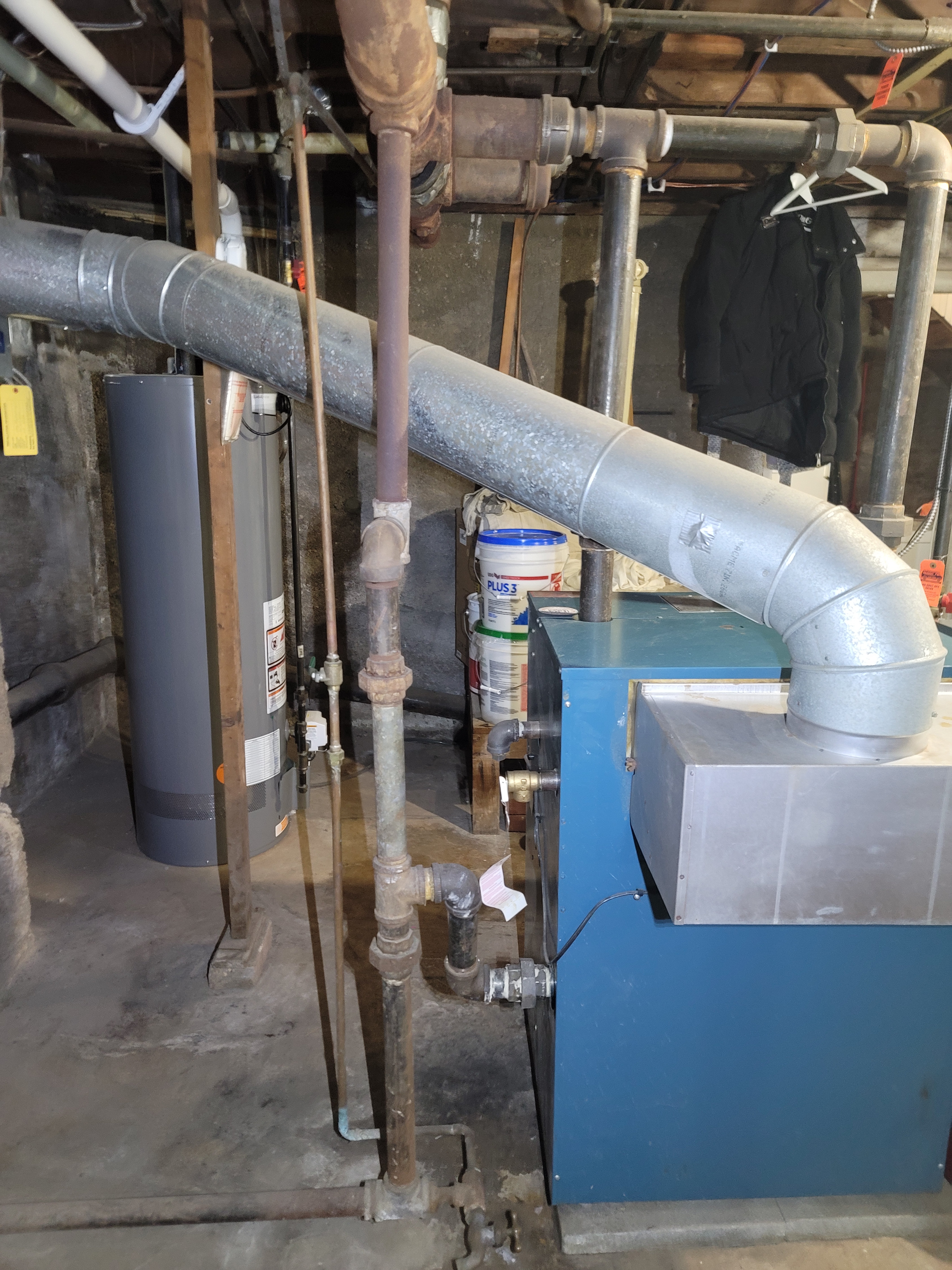

There are two 32” high 2” boiler risers going into a 3” header which feeds a parallel 2.5” straight short 24’ main line #1 (M1, 4 rads), and a parallel 2.5” D-shaped long 53’ main line #2 (M2, 6 rads) which reduces to 2” halfway. There is a capped nipple coming off a tee that I presume was from an old hookup. The equalizer (E) is 1.5". The east end of the header splits into two countercurrent 1.5” lines each feeding one riser/radiator (CC1 is a 2nd floor bedroom, CC2 is the 1st floor kitchen). Both parallel mains end into a 1-1/4” dry return and I put the main line vents on antlers coming off the only port I could find at the very end. I’ve noticed the last riser on main line #2 gets steam by filling backwards from main line #1 travelling through the dry return (the long main takes twice as long as the short one to fill), but I haven’t noticed any hammering or other issues from it.
Is this near-boiler piping correct-ish? I don't seem to have any symptoms of wet steam, but I understand "it seems to work OK so reuse it" is often incorrect. I can’t seem to find any examples of a header quite like mine with two parallel mains and a counterflow main. The estimates I’ve gotten have recommended reusing the header and otherwise using the same near-boiler piping configuration for the STMX175.
Any comments/concerns re: the other piping, like the seemingly odd way to the two parallel mains come together, and how main #2 backfills?
Thanks very much for your help and for the helpful community you’ve built; it has been an invaluable resources for a budding/amateur steam aficionado like myself. Please don't hesitate to point out any errors in my understanding (I'm a physician so my day job is little help, except that servicing a century old steam system feels eerily similar to caring for a cranky centenarian patient).

    The near boiler piping is very wrong. it might happen to work ok now but it should be done correctly with the new boiler.
    The header should be in the order of:
    risers from boiler
    risers from header to mains
    equalizer
    The header and risers from boiler size should be at minimum the size specified in the manual
    Each main should connect separately to the header. If a main is counterflow it needs a drip down to below the water line before it connects to the header. each drip needs to have its own return connection below the water line.
    The header shouldn't reduce in size on the horizontal so it doesn't trap water.
    Run away from anyone that says to put in a boiler bigger than the connected edr. The nameplate edr has an extra 30% pickup factor subtracted from it so it is probably oversized a bit even if it matches the nameplate. Do not use anyone that suggests you should go bigger than the connected edr beyond what is the closest size.
    If you have a main that is filling from a return, you have to figure out why that is possible, most likely returns from different mains that are connected above the water line. The returns from different mains must connect together below the water line. The most common reason for this is that a connection that was below the water line became above the water line when a boiler with a lower water line was installed. Also possible that whoever installed that boiler didn't understand why returns at the boiler needed to drop below the water line before connecting. The steam from the other main will come in to the main at the vent and close it, preventing the main from venting properly. It will eventually vent through the radiators but it will be slow to heat.
    Your near boiler piping looks like they just hooked up whatever was closest wherever they could and didn't know what they are doing.

    If it was me I'd replace the boiler myself, others on this site have, and I believe they are glad they did. It seems your contractors only want to do a mediocre job. Probably the hardest part is getting the new boiler into the basement. Although it actually seems that the hardest part is for some contractors to do a good installation job.
    If you prefer to not do the work yourself, I guess keep getting estimates until you get one you like without a lot of coaching. Has any contractor measured the radiators ?
    I'd match the boiler (Square Feet) to the EDR. (Assuming the EDR survey is accurate) As an example, my boiler could run for hours (if needed) and the pressure never gets to 2 Inches of water column (0.072 PSIG). It is slightly undersized, yet heats the house just fine. No extra pressure during a recovery from a setback.
    Your near boiler piping is not correct. So it should be corrected, a new boiler install is the perfect time to get it done.
    I would not reward Burnham with another purchase. Maybe 29 years is good run for a Burnham. I believe my old boiler is over 50.
    The drips at the end of the mains should be individual pipes until well under the boiler's water line then connected into the wet return, to isolate each main from the other.
    Since you are using Big Mouths, run the longer main with minimal or no vent restriction, a custom orifice can be easily made from a pipe plug and added the threaded vent of the Big Mouth on the shorter main. This way the steam gets to the end of each main at about the same time.
    I'd probably get the chimney repaired / relined for quiet boiler operation and maybe change the orientation of the boiler to minimize the flew pipe length.

    Looks like they tapped into a pre existing header.

    These pictures were from soon after moving in in 2021 when I was even more green than I am now. I had just recently removed the pre-existing too small/non-functioning Dole vents and replaced them with overly long antlers (since the only available tap was so close to the end) including a strainer before the big mouth vents.
  • bengigliotti
    bengigliotti Member Posts: 9
    Is it as simple as dropping the horizontal connection between the two mains to be below the water line? If so, I can easily do that myself.

    Yes, BUT, not just below the WL. Drop them to the level of the wet return and then go back to the boiler.

    I think I would bring the drip from the Right hand main in the picture over (heading left) next to the drip of the Left hand Main then both over to the wall to the Left of the electrical panel (up high) then both down the wall to the wet return pipe level. The existing horizontal wet return is extended around the corner under the the electrical panel and the vertical PVC pipe, then connected to the two drips. So as @JUGHNE mentioned the electrical service panel and its access is not blocked. The 45 degree sloping part has been removed.
    Additionally install valve(s) so you can flush out the wet return.

    I'd 45 the one to the right to the left and down separately with the return to the left. The end of the main itself appears to be in the working space of the panelboard, it has to be clear 30 in wide, 36 in out, and 6.5' from the floor or to the top of the equipment, whichever is greater.
