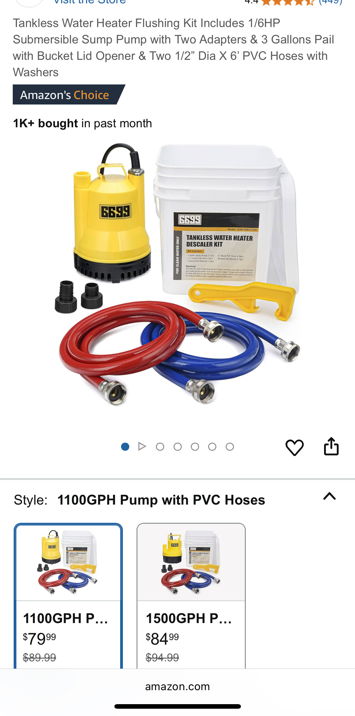

what size transfer pump to flush and clean a hydronic loop with a 2 gallon fire tube heat exchanger and total length of 280 feet with the largest loop being 100 feet. it is 3/4 inch PEX.

    hard to say without doing a lot of calculation but any of the small transfer pumps will probably work.
    hot_rod Posts: 28,705
    a small 1/2 hr transfer even a small sump pump will flow that
    If it is just an ocassional use get a small plastic sump pump pump.
    If you have a scaling concern get a tankless water heater kit, pump, cleaner, hoses, and bucket, around 80 bucks online

    1/2 horse power 25 gpm pump would be
    V=((.408/d sqrd)*gpm )= 22 fps .
    diameter of 3/4 pex is .681
    22 feet per second is good?
