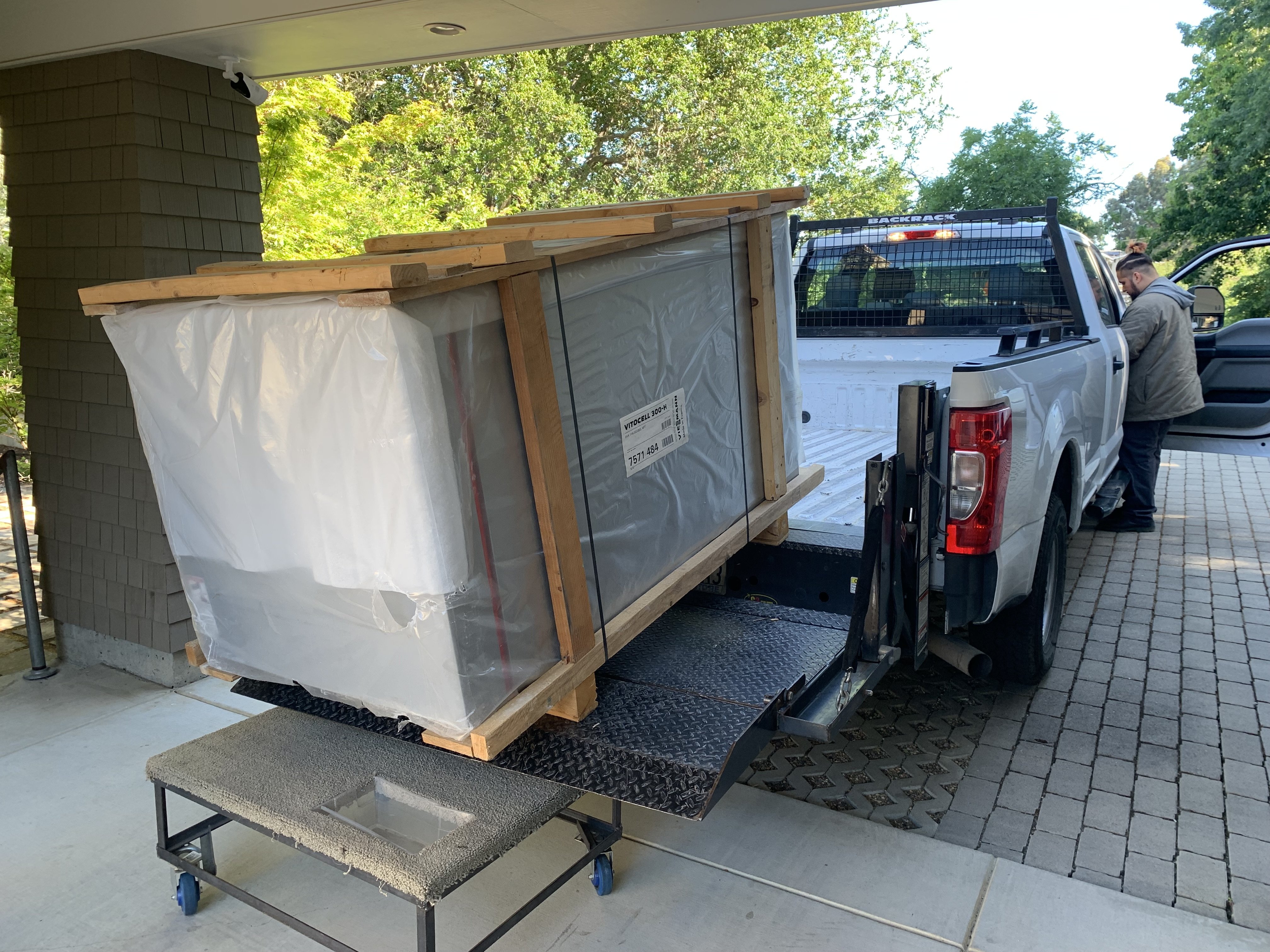

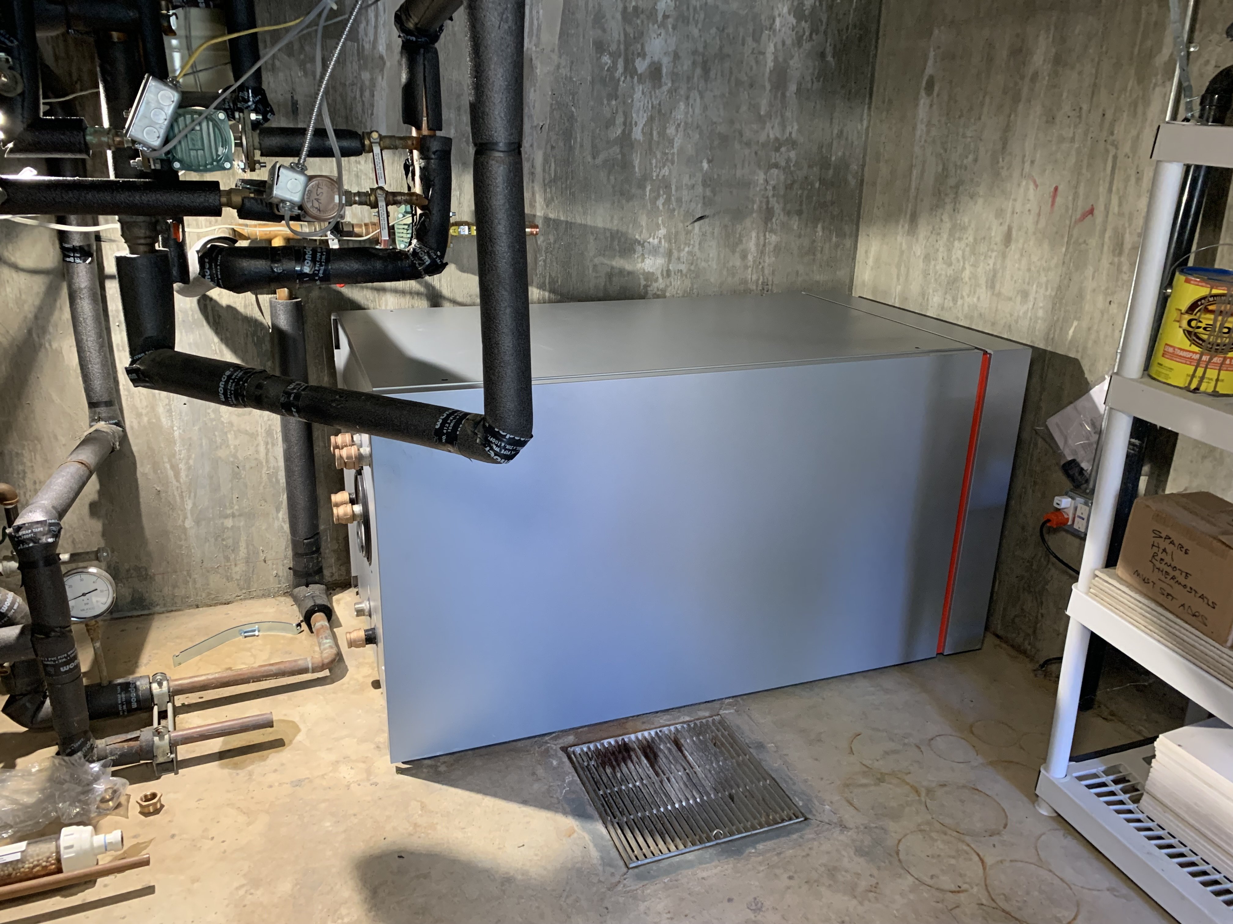

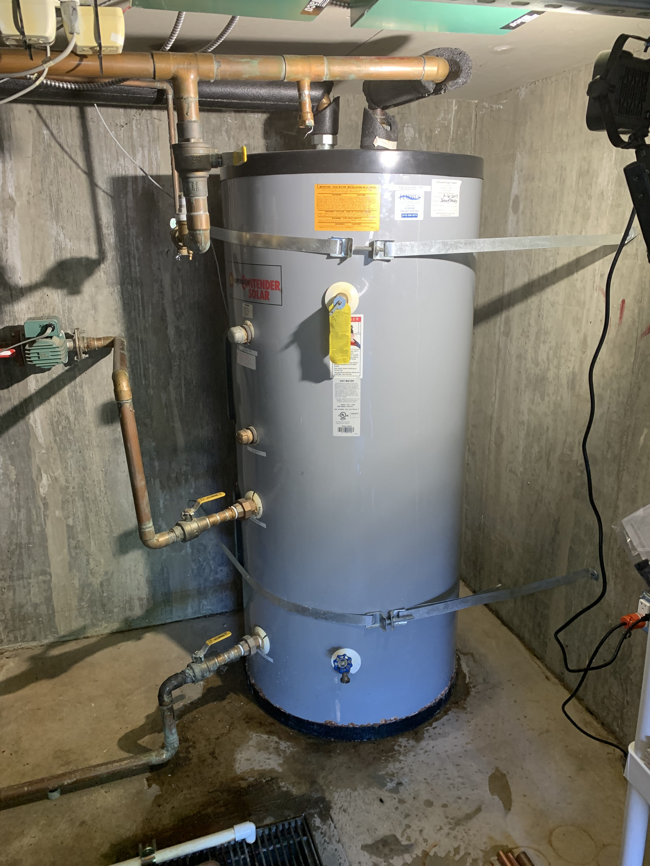

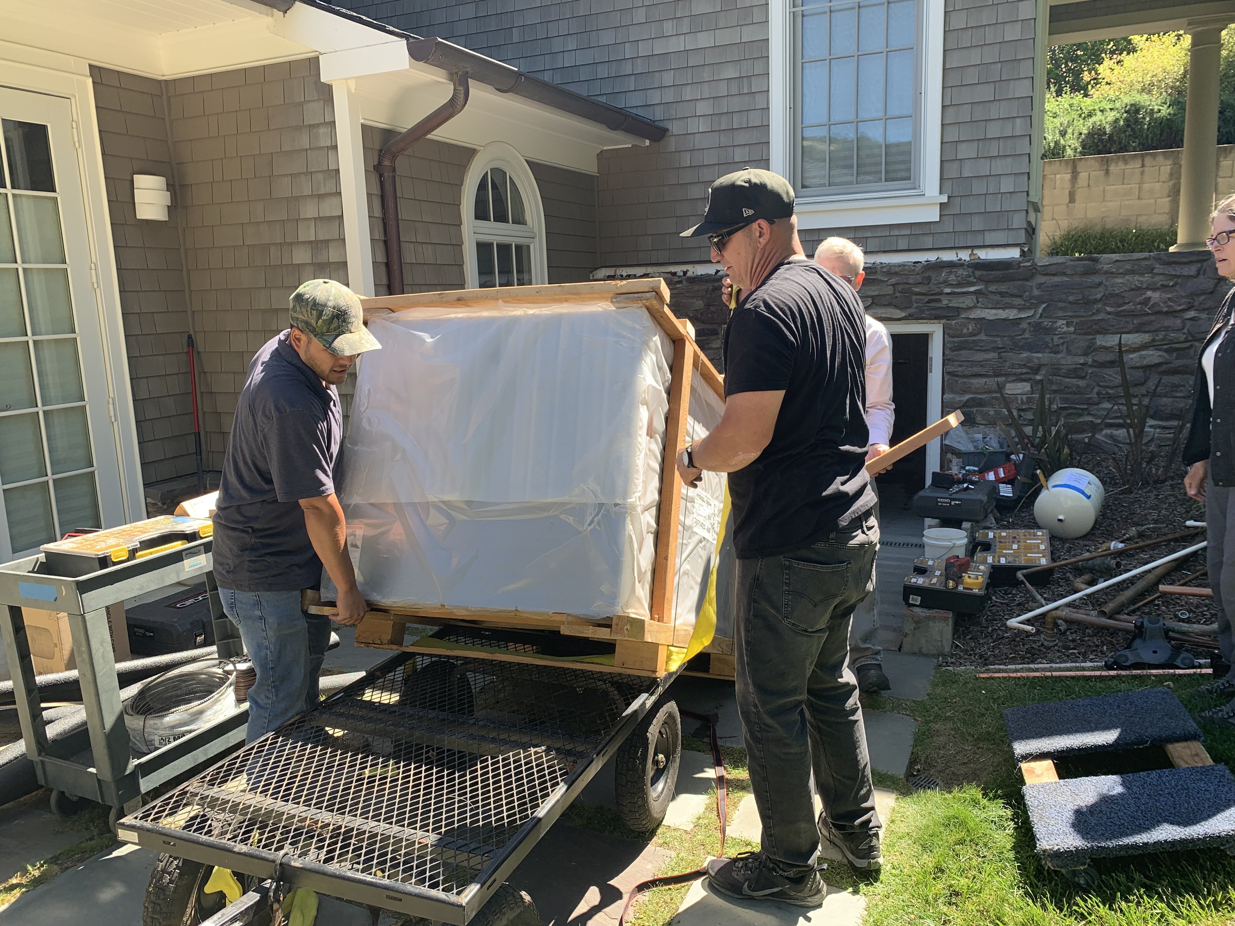

One of my regular customers had a 119 gallon Superstor indirect that started leaking. We replaced it today.
Both heaters weighed 500# and it was a job getting them in and out of the mechanical room.
It should be the last water heater the owner has to buy.

    @EBEBRATT-Ed There is a thermometer at the end with a display as well as a large cleanout manhole. Neither will ever get used.
    All the piping and aquastat connections are on the business end.

    That is a nice waterheater…Why a Horizontal tank vs. a vertical tank ?
    edited May 2025
    Have you ever ordered a V. 119-gallon vertical tank? It comes two pieces; the tank and the enclosure and is a PITA to put together.
    We also had the room for a horizontal and it’s the perfect height for serving cocktails.

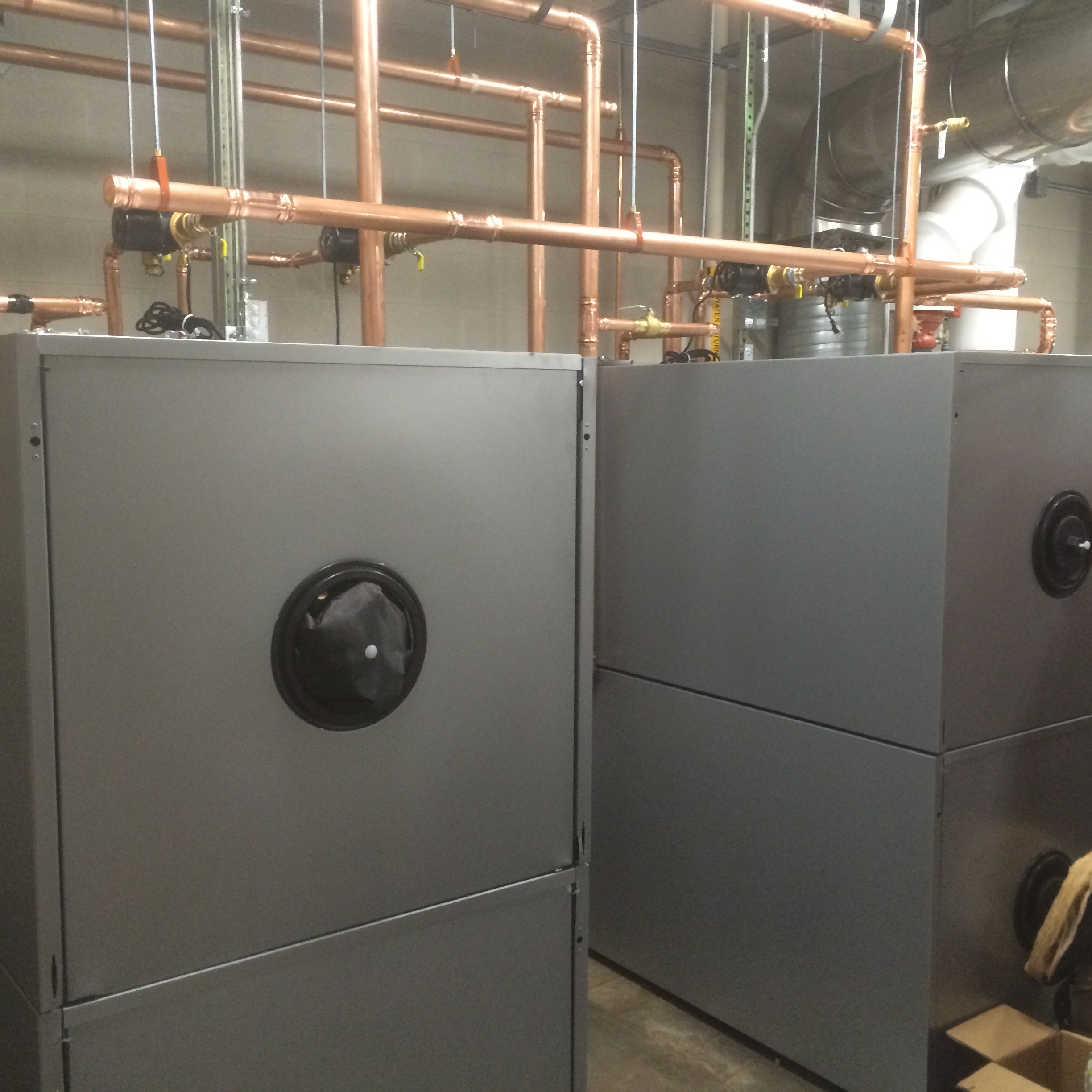

    I think the job I did we had 4 of them and we stacked then 2 high
    Thought I had more pics of the job guess not
  • Very pretty. I'd say 2-3 days with two plumbers?
    Must've had a large, floor-mounted x-tank.

    some of the Viessmann boilers matched the horizontal tanks for stacking, the Biferral for example

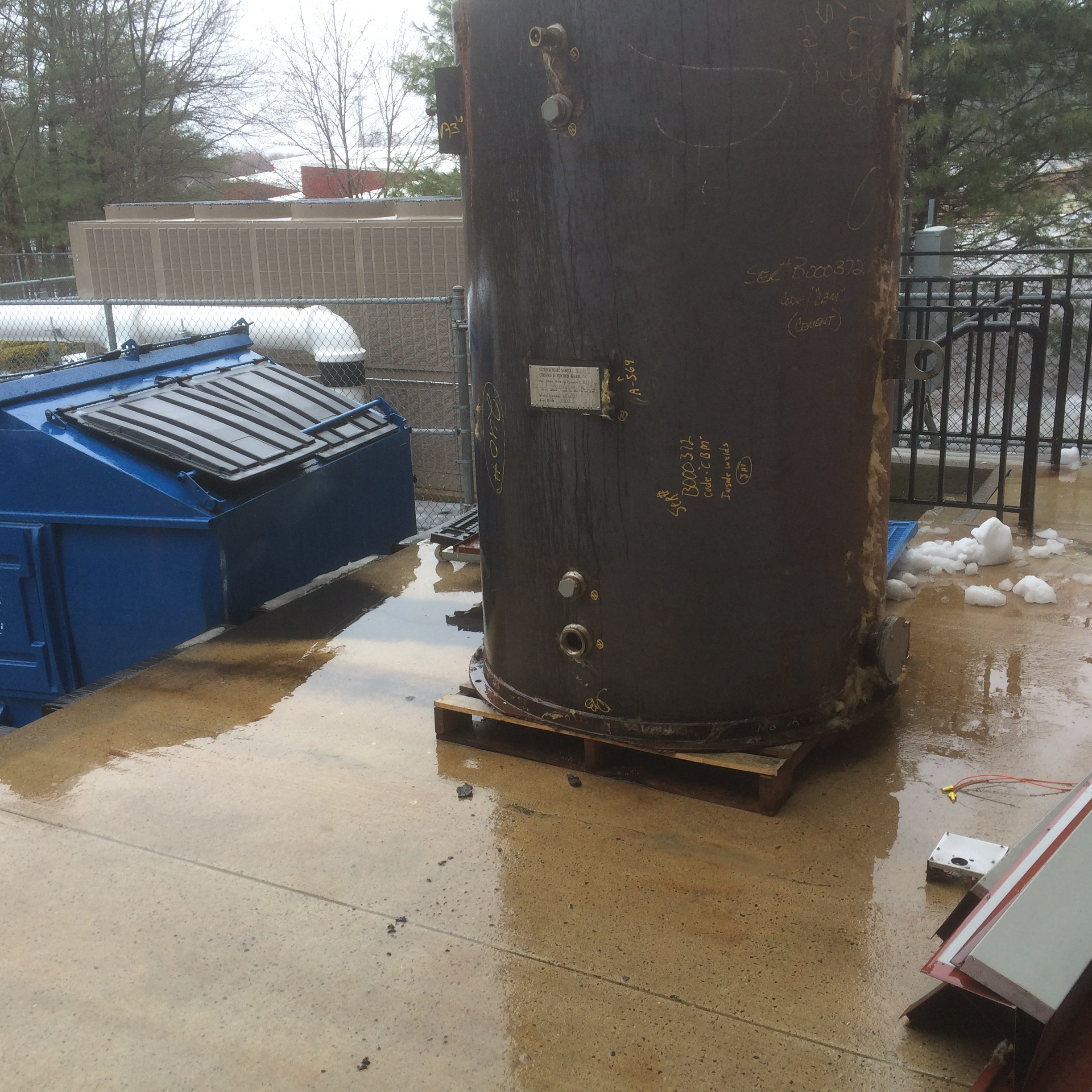

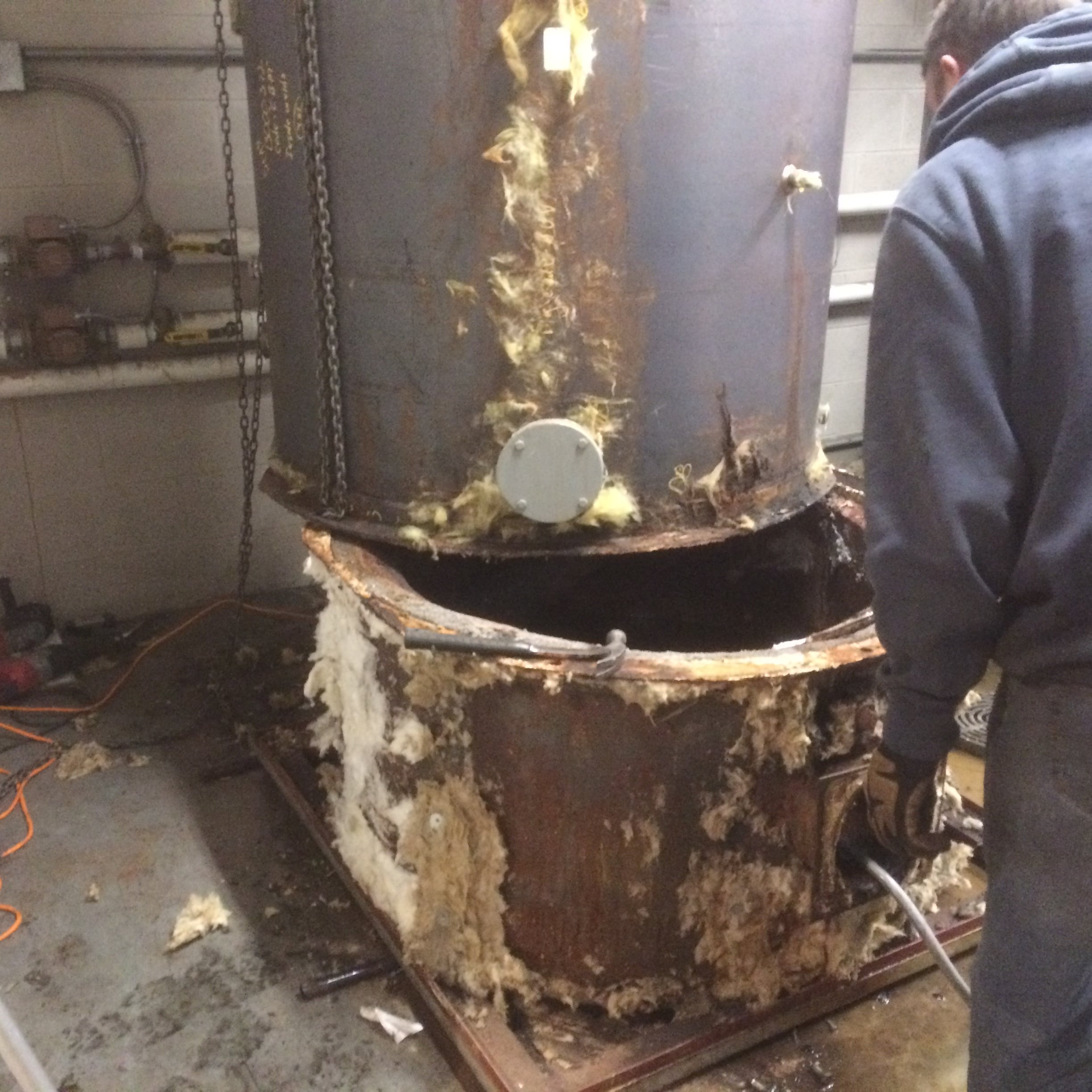

    We removed two oil fired HW heaters that failed. It was strange because the old heaters were about 16 years old and 1 failed. They only needed one so we valved off the bad one and they were ok for about a month when the other one failed.
    I had help getting the old ones out and the new ones in the boiler room and did the install by myself after that. We were lucky we had something overhead to hook a chain fall to. When had to lift the boiler off the combustion chamber base and it barely fit through the door in the vertical position. We didn't know how it was going to be until we got the jacket ripped off it to have a look.
    I had nightmares about trying to lay the thing down or worse cutting it up so we lucked out. And there were two of the old ones although the pic only shows one.
