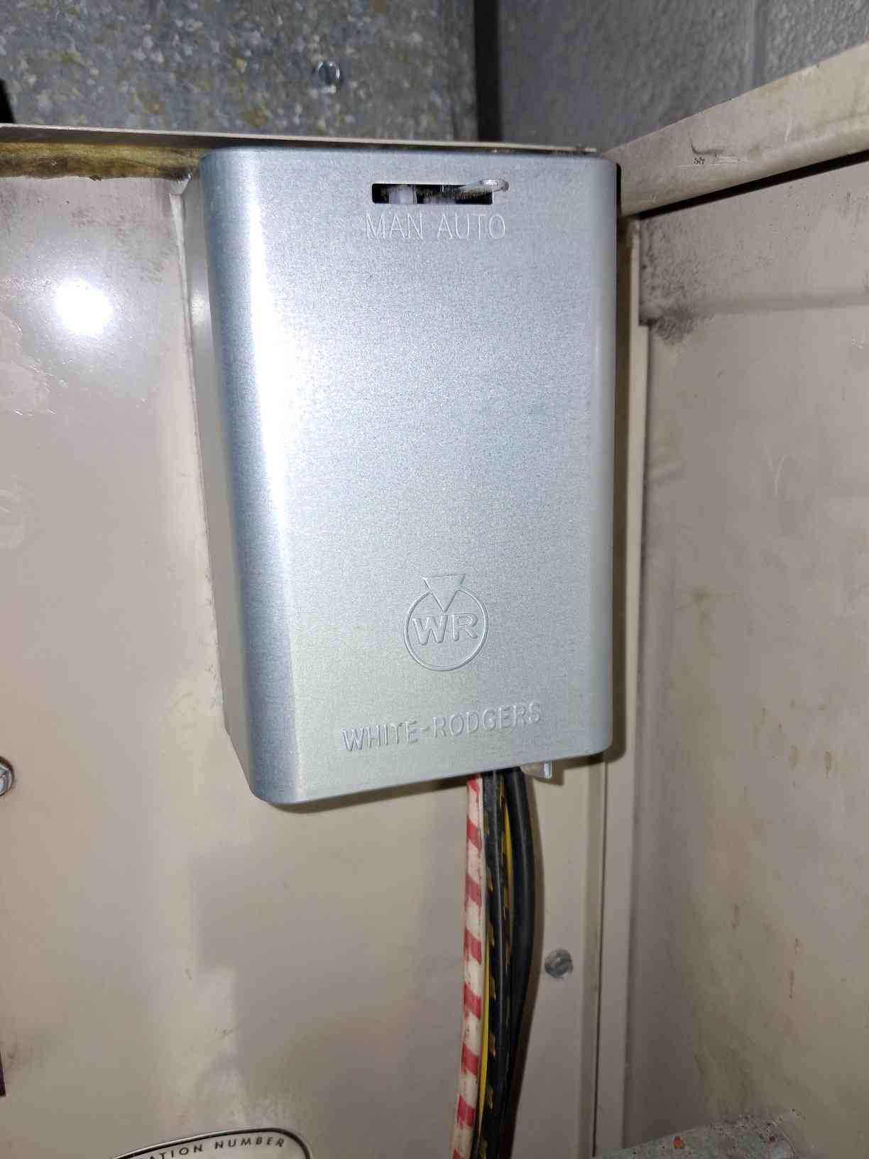

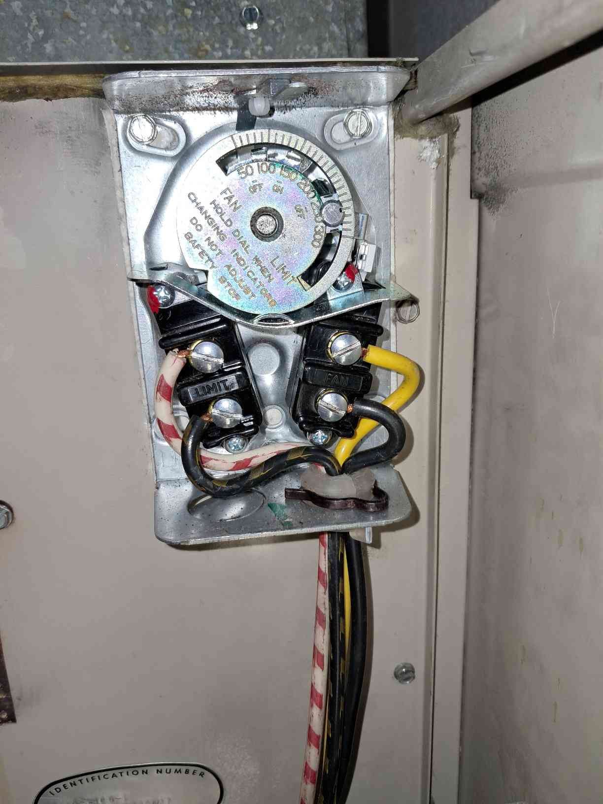

After almost 50 years my original White-Rodgers fan control wore out. Unlike the original, the replacement control had a MANUAL/AUTO control lever. I had the first replacement in about a year and several times it would switch to MAN by itself. So, I bought another one and it has done the same thing twice since I installed it in March. Is this a common problem with these units? Is there a way to fix this?

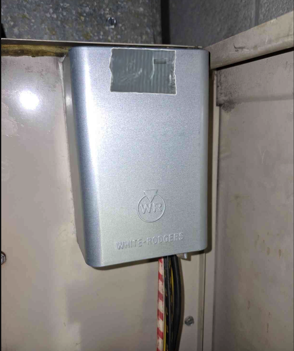

Lever actually moves off the detent by itself. Need to come up with a way to hold it in the AUTO position. Emailed Emerson, but they did not reply.

@chzuck can you post a couple of pictures with the cover on and off?

I have been running with the cover off. I will leave it on and see if that helps it to stay in AUTO.
might have to take that plastic rivet out and put a washer under the head to make it tighter or replace it with a screw and nylock nut so you can adjust the tension. is it always in auto if you remove the lever altogether? definitely a manufacturing tolerance or untested design change thing.
Take some duct tape and cut a slot in it and tape it over the lever. Its a hack.
Or do the same with a piece of sheet metal and put a short screw to hold it in place
I like it!
No the lever is needed to hold it in AUTO.
