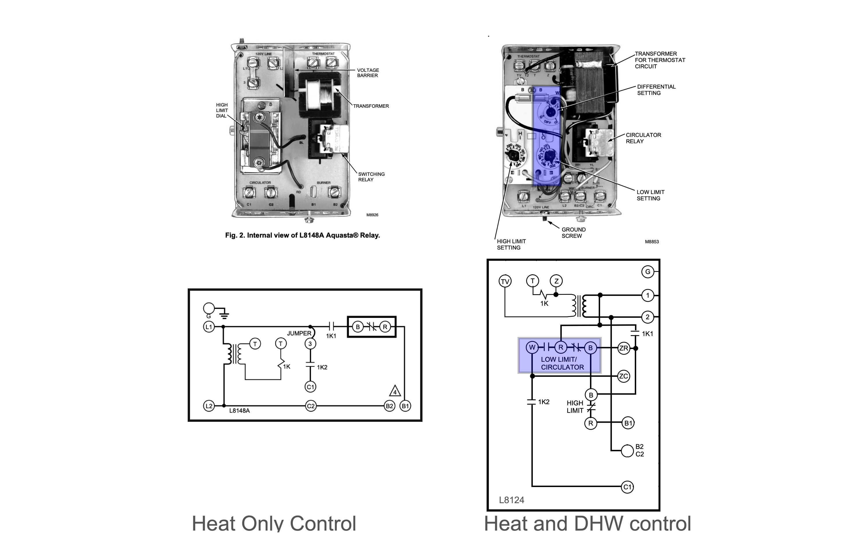

Since the original discussion comes from someone that is an expert on Steam systems for both space heating and brewing, I assume that this will relate to steam systems. For the most part an oversized steam heating system does not have a low limit control per se. There may be two high limits on one boiler. One of those limits will be called the operating control that is designed to keep the boiler within the most efficient operating pressure range. The second limit is set at a higher pressure and will only open in the event of a failure of the operating limit to open (also known as Cut Out) when the desired pressure is reached. Those high limits often have a manual reset that requires human intervention to get the burner back up and running.
At the point when human intervention is required, the human boiler operator should investigate the reason the operation limit failed to keep the boiler pressure from activating the High limit. So your term of Low Limit is incorrectly used in this case.
When referring to a water boiler that also has a Domestic Hot Water DHW) coil the term Low Limit means that part of the control system that stops the boiler temperature from reaching the high limit setting. The low limit will maintain a boiler temperature that will be sufficient to provide DHW, say around 160°. Only when there is a call for heat will the Low limit get bypassed by the relay that operates the circulator in order to make the boiler water hotter than that needed for DHW and allow the boiler temperature to go as high as the High limit which may be set as high as 200° or more. You don't want to waste fuel by maintaining the High Limit temperature all summer when the low limit temperature is good enough for DHW, but you may want to get 200° water for the radiators in the winter. So that is the reason for a low limit and a high limit.
So if you are referring to the lower set limit known as the operator on any steam or hot water boiler, making the differential greater will increase boiler run time. That is because it takes less burner run time to make any quantity of water increase in temperature only 10° or raise the pressure 8 ounces of steam pressure, while it takes more burner run time to make that same amount of water increase 25° in temperature or increase in steam pressure of 1.5 PSI. That is common sense. What you name the particular control that the differential setting is on, has bearing on how the control operates. What you call a particular control only makes a difference in communication to other tradesmen as to what you are referring to. So calling an operating control a Low Limit may be confusing to someone because the term Low Limit usually refers to something different that what I believe you are referring to.
I hope I have made myself as clear as mud on this subject
EDIT
Pictures are better at explaining stuff. This represents a Hot water boiler control system that will operate both the Burner and the Circulator pump
Only one of the controls here has a Low Limit. It is indicated by the shaded Blue area. The control on the left has no Low Limit because this boiler has no DHW tankless coil in the boiler, so no need for a low limit to maintain boiler temperature for DHW. Only the control on the left has a Low Limit with an adjustable differential from 10° to 25°. Adjusting this Low Limit to a 25° differential will have no effect on the burner short cycling during a call for heat. That is because the call for heat will bypass the Low Limit and only the high limit will keep the burner from operating above the high limit temperature. The oversized burner/boiler will have no change in operation by adjusting the Low Limit. I can go into more detail if you believe that you can make a burner stop short cycling during a call for heat by adjusting this differential.
I hope this answers any questions about the operation of a Low Limit.

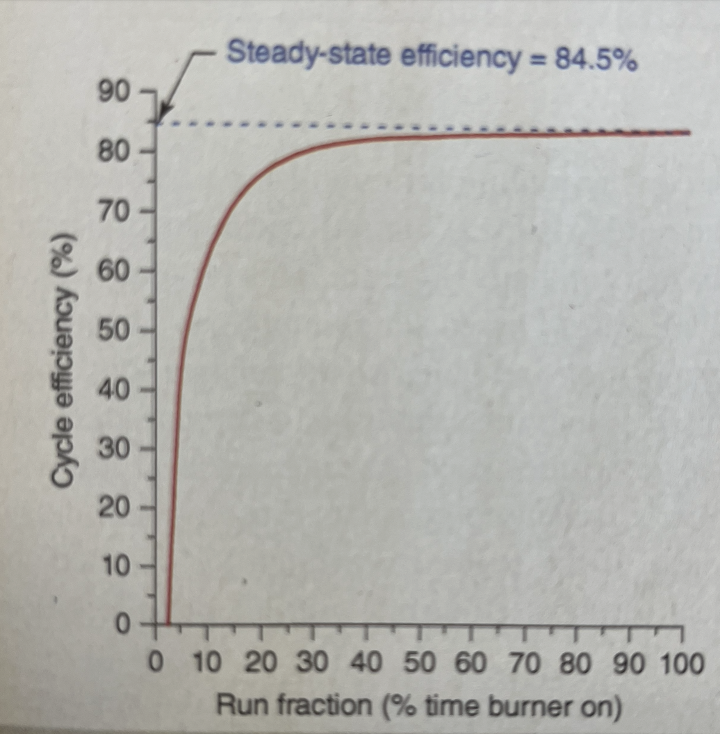

The Run Fraction tells more of the story.
If a boiler runs for 2 minutes, followed by a 10 minute off, then 2÷12= 0.166 or 16%
Use this chart to determine efficiency.
16% on bottom axis, runs up to under 70% Cycle Efficiency.
Commonly you will hear a minimum 10 minute run to dry out the combustion chamber and flue. Followed by a 20 minute off gets you into the 80% range.
10÷30= .333 or 33%
A perfectly sized boiler would run 24/7 on design days to give you the best efficiency, Steady-state Efficiency.
With a large buffer you would run steady-state while charging, then the boiler gets the best efficiency, when it is not running at all :) for the period of time the buffer depletes.
Pipe the buffer "direct to load" then the boiler does a % of heating and a % of buffer recovering. If the load is large, maybe coming out of setback, all the boiler output goes to the load.
