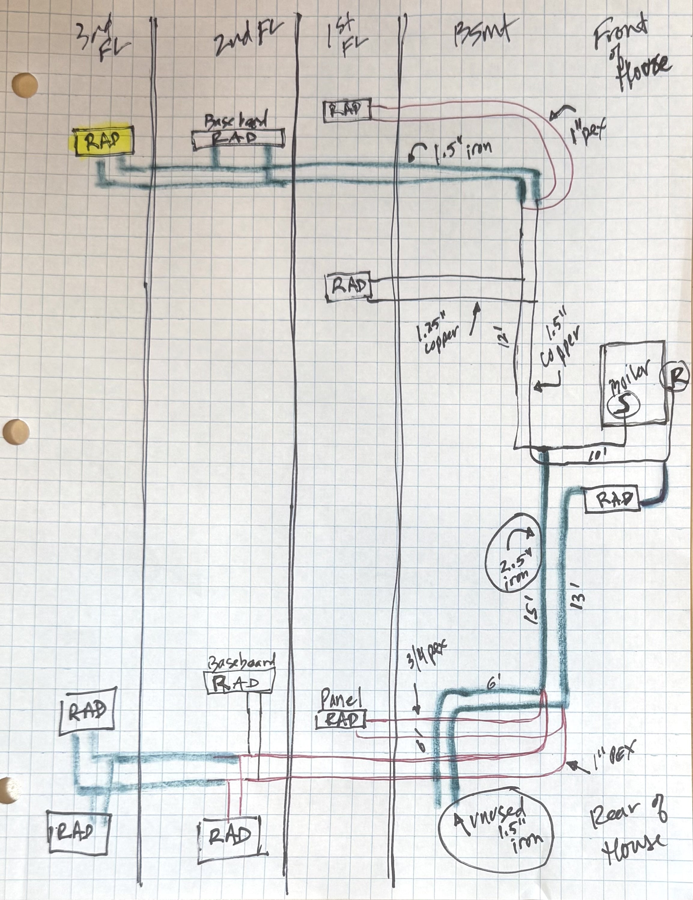

Hi all. Hoping to get feedback on a couple issues regarding my two pipe hydronic heating system. Note that it has a pump/circulator and all of the radiators are old school cast iron, except two sections of newer cast iron baseboard radiators, as indicated in the attached diagram
First issue is that I'd like to move/replace two sections of the the original 2.5" iron pipe to get more headroom in my basement. In my diagram, I've circled where these pipes are. It's a 15' supply section and a 13' return section. Both connect to the boiler via 1.5" copper. My question is whether I can replace these sections with 1.5" (or smaller?) copper.
At the same time, I'd remove two sections of unused 1.5" iron (also circled) connected to the 2.5" lines (radiator was removed at some point).
My other issue is that the 3rd floor radiator highlighted in yellow in the diagram is almost impossible to get filled. The system is at the recommended pressure, but when I bleed this one radiator it eventually gets to the point where it's pushing out little to no air, with no water release. When the system is on, I can hear some sloshing in the radiator, confirming that it's not filled. Any thoughts on what might be causing this?

    What size is your boiler? Did you run a heat load calc? If itn is a pumped system, you may not need 1-1/2" pipe.
    1" copper pipe for example can move 8 gpm or more, so 80,000 btu/hr minimum.
    The higherst point in the system? The top of the uppermost radiator, what is that distance form the expansion tank?
    The dimension X .433. Then add 5 psi to that.
    Example top radiator 18' above the boiler 18 X .433 =7.75 + 5 = 12.7
    So 12- 15 psi should be adequate.
    With large diameter pipe you need a lot of flow to purge air out, you may need to bypass the fill valve, or connect a hose to you water supply to get a good flush and purge

    Thanks all. Some more info: it's a Weil-McLain CGI-5. The highest point in the system is about 30' above the expansion tank. I've been running the system at about 18psi (I used a separate gauge to confirm the built-in gauge is accurate).
    The W-M website indicates that for a size 5 boiler 1" supply/return piping is sufficient. So I guess that's that answer to the pipe size question - I'll be okay replacing the 2.5" iron sections with 1" copper?
    Regarding the problem radiator, it sounds like I should try purging by pushing water through the system or using purge valves at the radiator. I can try those solutions when I get ready to restart the system.

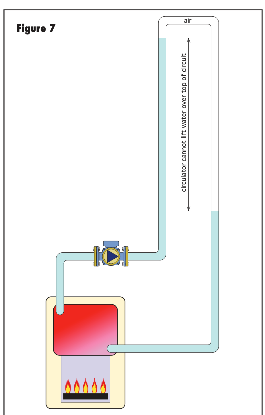

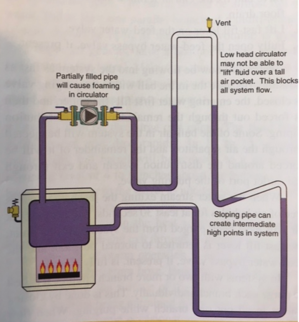

    An example of what happens to dynamic pressure ( pump spinning) in a system with either low fill, or a circ develop in high pressure differential.
    So in some cases the upper portion of the system could be running at negative pressure. The second slide shows a system with low fill pressure 5 static, notice - pressure starting just past 1/2 way around the loop.
    These are just examples, you would plot your exact piping path to determine where you could go sub-atmospheric. Or gauge a few locations.
    Any auto air vents at that location would allow air in, instead of out!
    A gauge at that highest radiator should read at less 5 psi static. And ideally not drop, maybe increase when the circ runs. Pumping Away allows that to happen.
