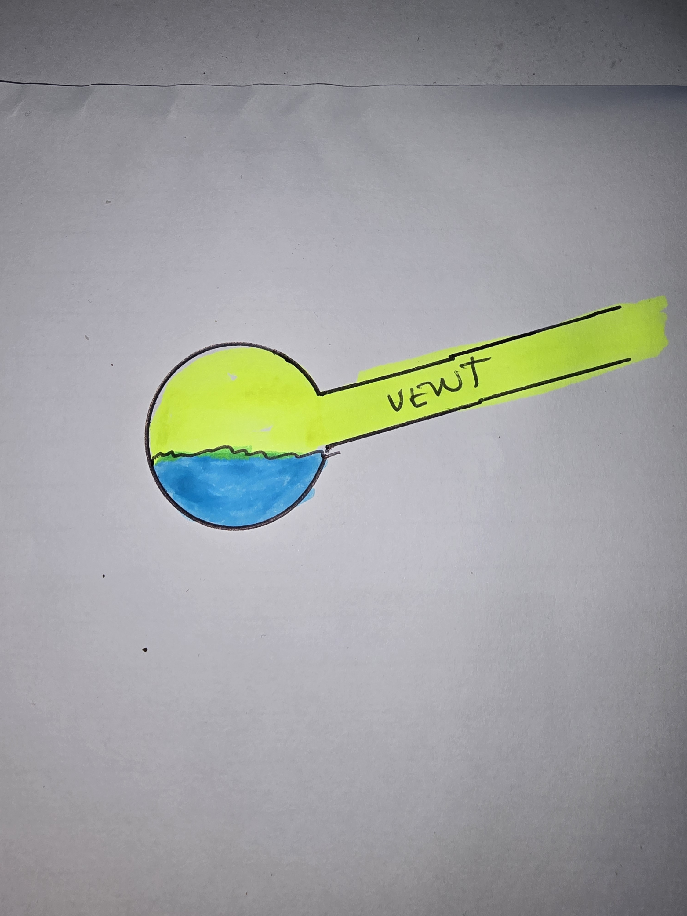

I am having a midlife crises concerning venting and circuit venting floor drains.
I have always assumed: If the floor drain is in the middle of a room the vent can be connected (at a 45 deg or more above center) and then piped horizontally (below the floor) over to the wall where it can go up vertically. Same with circuit vent for multiple floor drains.
It has been recently pointed out that the dry vent needs to go up 6” above flood level which would put it coming up in the middle of the floor.
Any helpful input?
I can sketch this if it would be helpful.

  • The 6 Inches above flood level is the height for connecting into another vent. So, trap vent does not become a drain when the drain becomes plugged.

    in big open rooms , brew pubs, warehouses, etc you can have a combination waste/ vent system designed by an engineer
    The one system I did had 3” drain lines reduces to 2” traps so there was air space in the piping for venting
    It was in a brew pub with no inside walks to vent up

    @Chuck_17 The above drawing that @hot_rod posts above is an excellent example of traps vented as floor drains.
    I'm guessing you are thinking about the term "six inches above flood level rim." That requirement can be established when the trench is dug deep enough to accommodate that measurement. What does the code book say in your area?
  • Chuck_17
    Chuck_17 Posts: 148
    NY State which is basically the 2019 IPC.
    The drawing above looks like a typical circuit vented.
    The code for Comb Waste and Vent says vent vertically 6" above flood level before horizonal offset. (flood level for floor drains is the floor I assume) Does that mean no horizonatl offset to the wall, or a horizontal offset that other fixture vents may be connected to?

    Its where those vents connect in to a branch vent, vent stack or stack vent. The "tie in" needs to be 6" Above Flood Level Rim of the tallest fixtures in that room. As long as you maintain minimum pitch back toward the drain it serves, and respect the sizing charts, you can run quite far before coming up in to a wall or chase. Mad Dog

    Chuck...all codes that I am familiar with no longer require that a vent take off be at a 45 degree or great which is ideal. As long as the connection is skewed up greater than 95 degrees from the center of the drain, it is acceptable. Mad Dog
