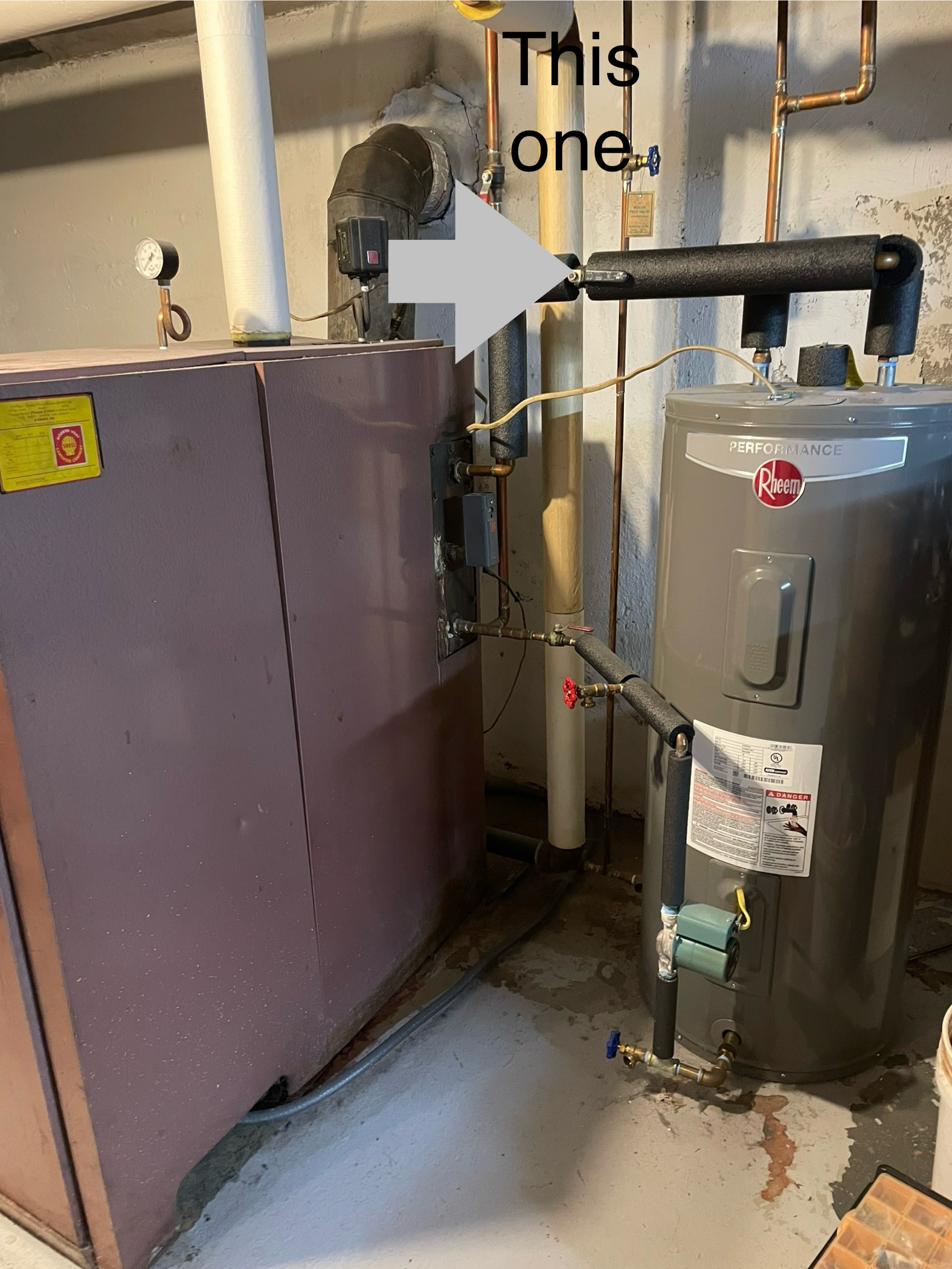

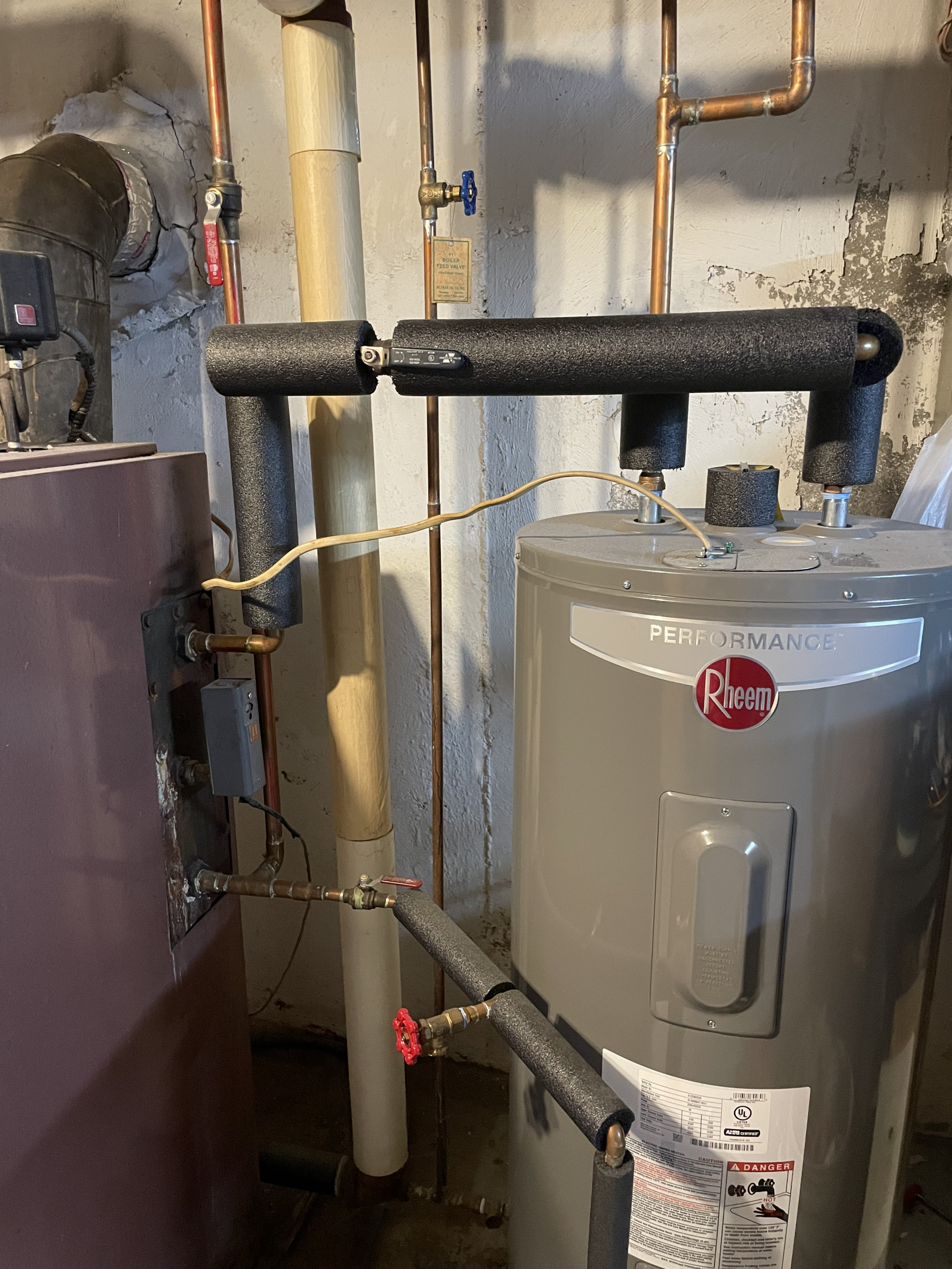

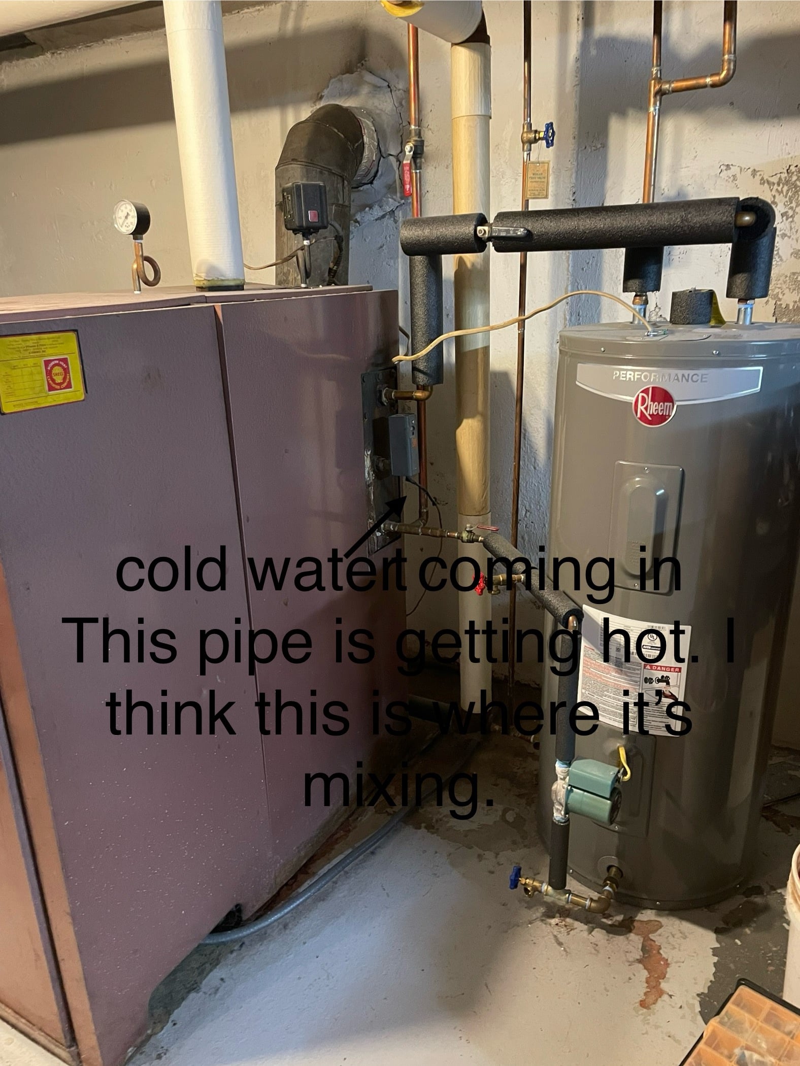

the hot water tank in the photo is being used for storage only. The coil in the boiler still works, and produces plenty of hot water. All of a sudden, out of nowhere, the cold water is mixing with the hot water. I am getting hot water from all of the cold water taps
in the house.The current set up has been like that for many years. I have been told on numerous occasions that the pump is in the wrong place. I have been told it should be on the top somewhere.
so, looking at the photos. Can anyone tell what is wrong and why I am getting mixing with the Hot Water into the cold taps.
73 year old one pipe system with original American standard boiler, oil fired becket, 2 inch steel pipe main, 100 feet long, with 8 radiators above.
    edited May 2025
    Check valve missing

    yeah, nevermind, still need a check on the cold supply to the domestic hot

    You have a cross-connection somewhere. The usual suspects...
    1. Single handle mixing valves like shower bodies, Washing Machine valves.
    2. Mop Sink connections that are altered.
    3. Domestic hot water coils using a globe valve to blend.
    Yes, you also may need a check valve, but when this condition "suddenly" occurs, it's usually at the aforementioned locations. Mad Dog

    thank you for the quick reply.
    There used to be a check valve just after the pump where the red valve is located. It caused a lot of water hammer when the washer went on, so I took it off. The only other thing that has changed that I think of is that the heat is off. Anyway, I think installing a check valve at the new suggested location looks like something I could try. I like that idea because it’s way closer to where it seems like it’s mixing to me.
    that pipe coming down should be ice cold. It’s pretty much hot all the way up now. Maybe placing the check valve there might be a really good idea.
    hopefully when we run the washing machine there won’t be a lot of banging

    mattmia2 Member Posts: 17,904
    I was about to say that then looked at it more closely and i think the check is just on the bypass, the dhw system is still open to the cold water inlet through the coil.

    Nothing has been changed. This problem seems to have coincided with the thermostat, no longer calling for heat in the house. The weather has gotten warmer in New York.
    I felt the cold pipe leading into the boiler. It was hot. As a matter of fact, I continued upstream and still hot. I followed the pipe around the basement and everywhere it should’ve been cold it was hot. It finally felt cold Just before the meter where it comes in from the street.
    One thing I did notice is the pump seems to be running much more than usual. During the winter, it hardly turned on at all. But now, every time I go down into the basement that pump is on.
    so, instead of pumping the water into the coil. It seems to be pumping the water back up into the cold supply.
    Maybe the coil got clogged up. I don’t know. About the cross connection discussion. I don’t think a cross connection is possible because I haven’t done anything to the plumbing. Please let me know if I’m wrong about that. Do cross connections just happen on their own.
    here is some more info.
    The hot water in this house comes from the coil in the boiler. The pump pushes water from the tank into the coil and then back out from the coil into the tank. There is nothing heating up in the hot water heater. It is a storage tank only.

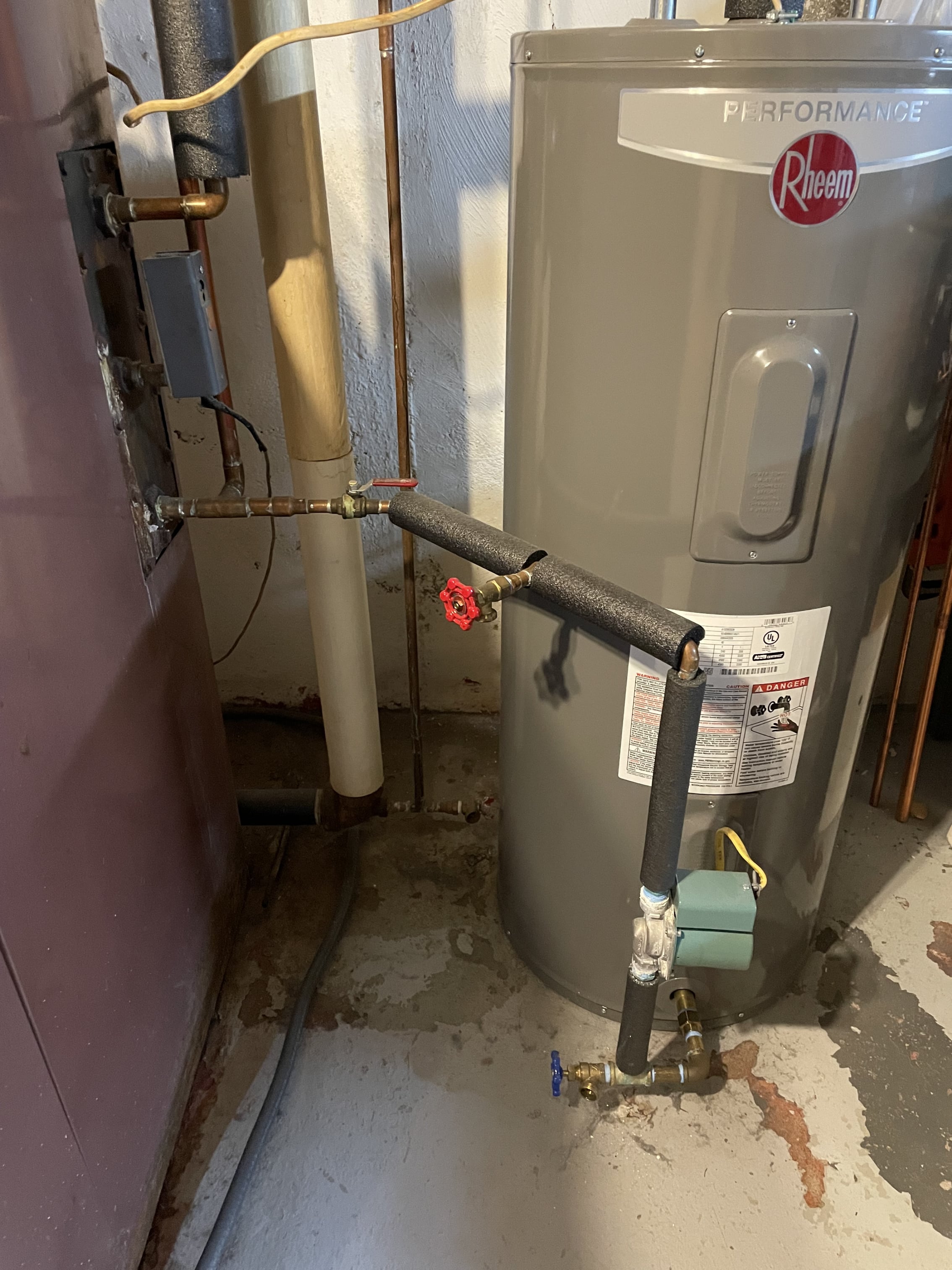

    By looking at the photos what valves would I turn to shut off the hot water. I would like to try the bypass test.
  • steam-rookie
    steam-rookie Member Posts: 137
    I am really hoping to perform the for mentioned test. By looking at the photo, would this be the correct valve to turn off the hot water?
  • Larry Weingarten
    Larry Weingarten Member Posts: 4,185
    edited May 2025
    Hi and yes, That looks like the cold supply to the tank. Also, is that romex carrying 120 or 240 volts? If so, I'd put it in conduit 😉 I'll add, just to prevent confusion, shut off the red handled ball valve on the line from the boiler for this test, and turn off power to the pump. A thought. If there is any way that drawing hot water could cause water to flow backwards from tank bottom into boiler coil, a spring check wants to go there.

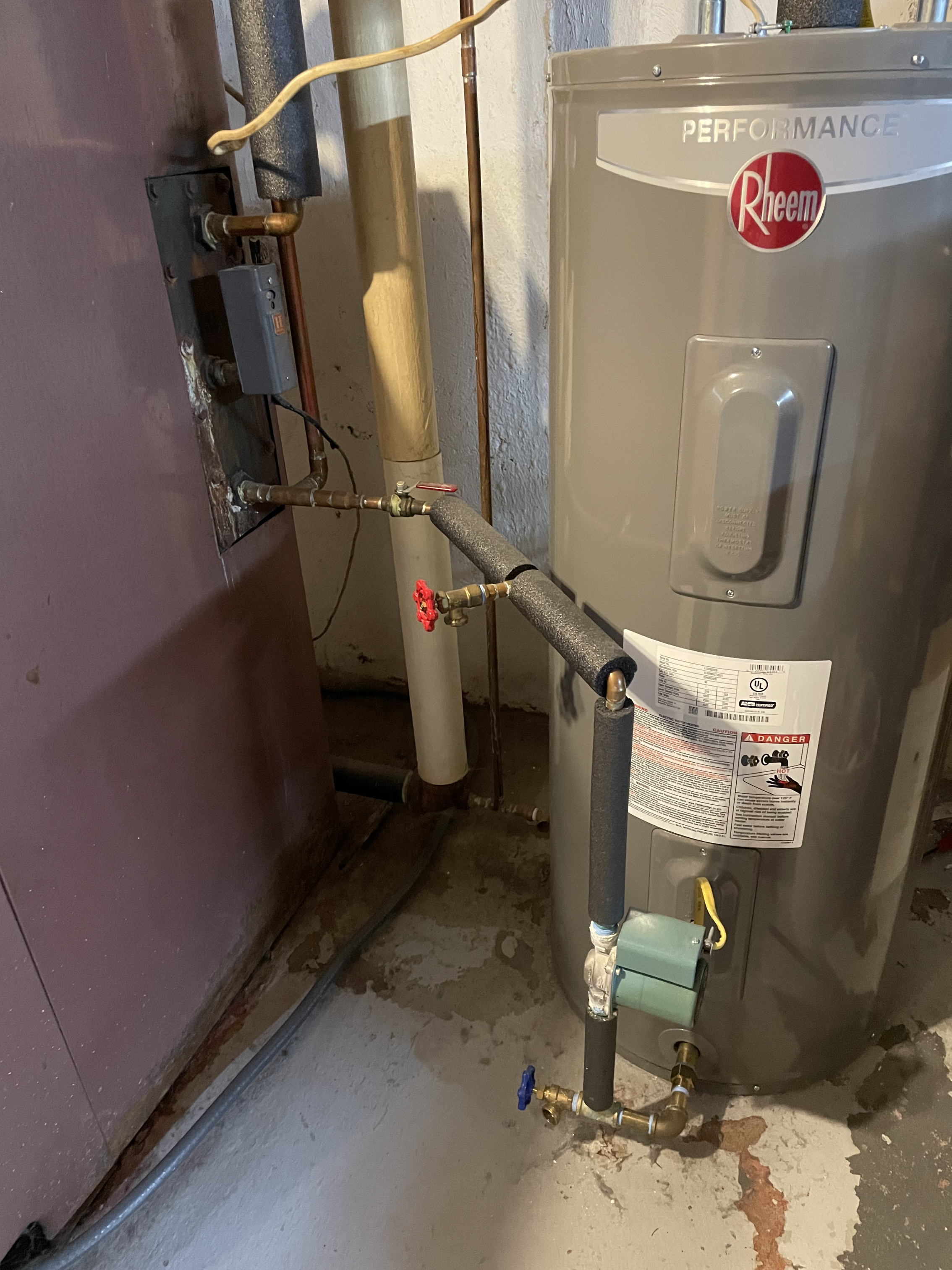

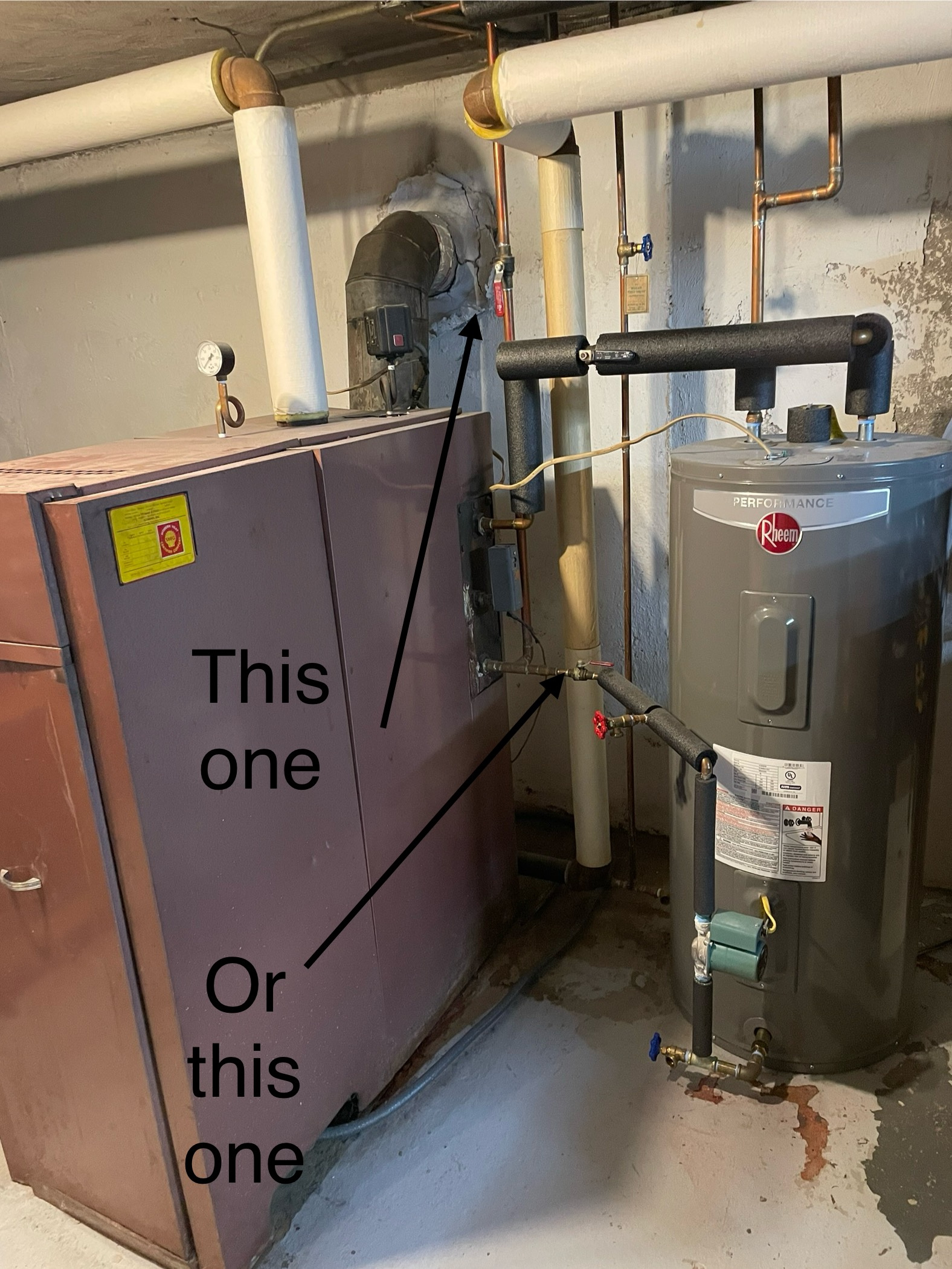

    Just to be clear, I have posted another photo for you to look at. There are two red handled ball valves. Can you look at the photo and tell me which one.
  • Larry Weingarten
    Hi @steam-rookie , It's the lower ball valve I'd close for the crossover test. 👍️
    Yours, Larry

    Larry, I will use the lower for the test. The yellow piece of Romex going to the pump is 110 volts.
    that is a stock electric water heater 50 gallons off the shelf at Home Depot.
    I disconnected the heating elements, and left the thermostats active. It has been rewired that way, so that the tank thermostats trip on the pump.
    Both pipes on the top of the water tank are hot . Everything going into the water tank and coming out it is hot . It’s just a big loop running through the coil.
    The only cold pipe is the one with the red ball valve on top. That pipe is the cold water from the street.
    i would say the on top but it wouldn't hurt to close both as long as you turn the circulator off
  • Larry Weingarten
    edited May 2025
    Hi, Perhaps a simpler approach is to close the upper red ball valve, as that should stop any cold water from getting into the DHW system. Then hook up a hose, or run water from either boiler drain valve ( by the bottom of the tank, or the valve above the pump) and see if pressure falls off quickly. If not, there's a crossover.
