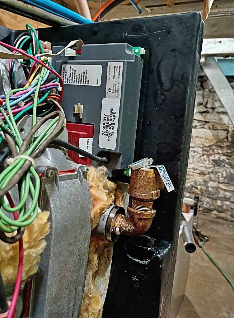

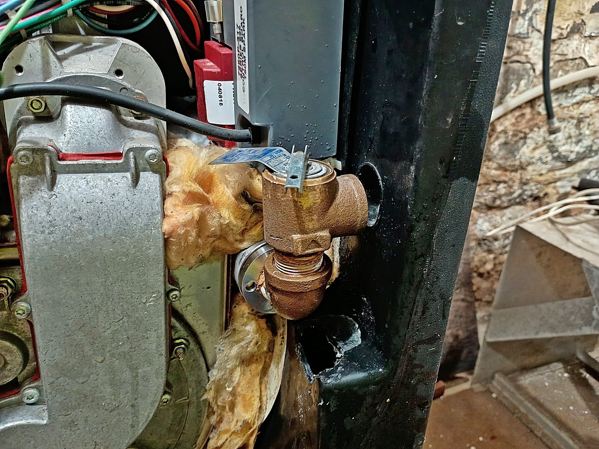

The poor thing finally had an issue. The t&p valve developed a leak at the seat.
So, today I went to the basement to attempt to remove the valve. I had been dreading it. There's not much room to get a big wrench on the valve. I had a small 6" pipe wrench that would fit, but couldn't get any leverage.
Then I thought I'd try unscrewing the elbow itself from the boiler… with just a little persuasion, it backed out~ but it wasn't just the elbow~ the stainless steel plug was unscrewing from the header it's in! That was enough to let me get at the t&p valve and remove it.

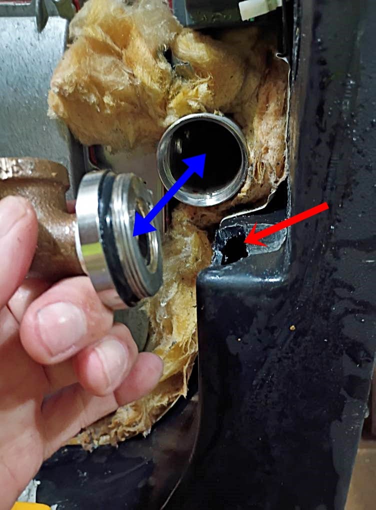

Since I'd gone that far, I went to remove the stainless plug/brass elbow combination… but the plastic boiler housing wouldn't let it rotate completely around.
Went and got a pencil/die grinder and cut out the offending plastic housing.
Unscrewed the stainless plug completely… it's got an o-ring seal.
Looked inside the manifold… slick as a whistle, no mineral buildup inside it.

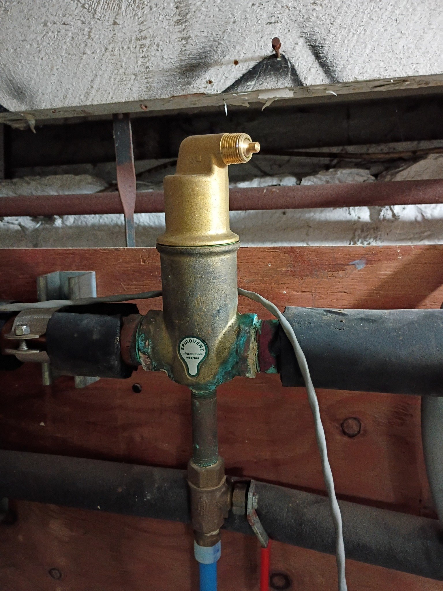

Before last heating season, I removed and replaced the working part of the Spirotherm air vent… pictured it here, as well.
    Looks like it has some more life in it.

    Clamp the street ell in a vice to remove the relief valve. Do you have an accurate pressure gauge onj the boiler? It could be going over 30 psi, from a failed expansion tank, or fill valve leaking. Does it have glycol. Looks like the Spiro vent had leaked on thje threads.
    Have you taken the burner out, that is often where the cleaning needs to take place.

    No glycol… and not sure why the corrosion on the Spirovent…I think it had something to do with the flux when I soldered the copper tubing to the fittings on the vent. Never had any water leak out of the vent…
    Valve came off easily after I got it horizontal.
