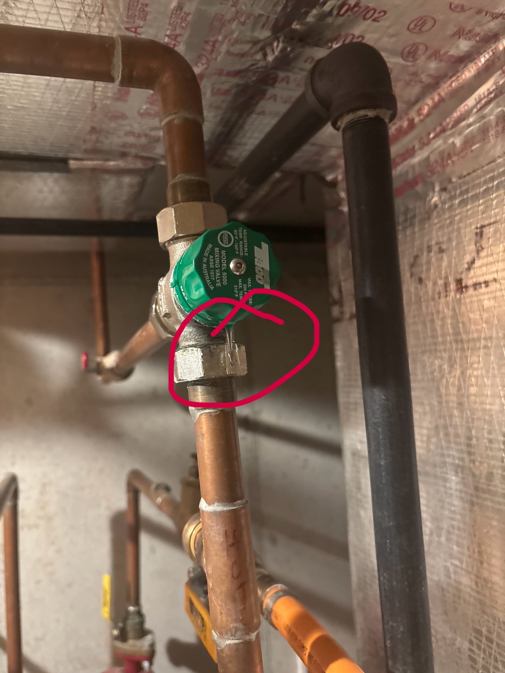

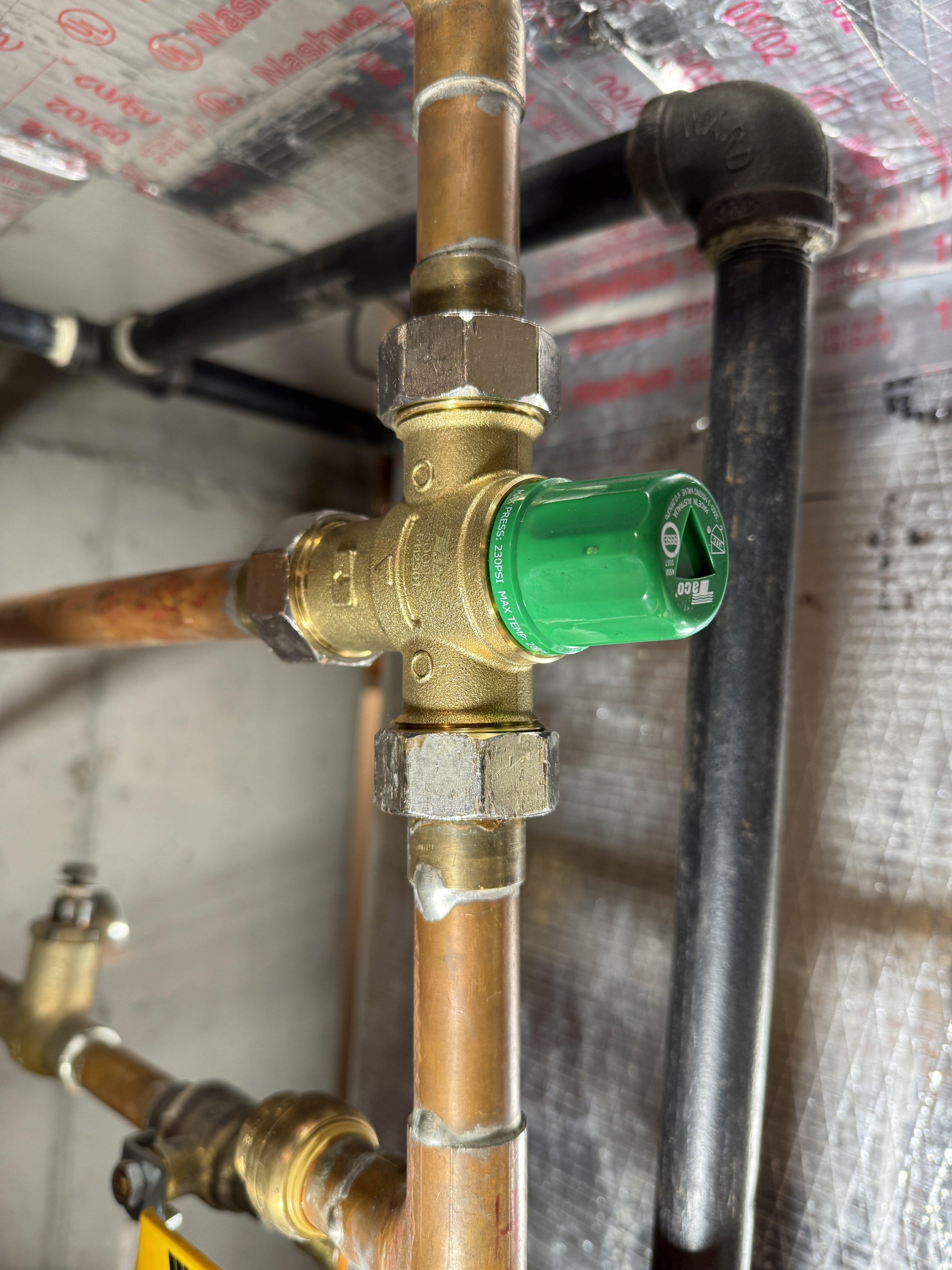

taco 5000 was leaking from adjustment valve. Swamped it out with a new customer now said hot water comes on for 3-4 minutes then goes cold. Left it sit does the exact same thing. He also has a watts 500800 recirculating pump denies any issues with that before changing taco 5000. Any ideas what’s going on here I’m stumped maybe water heater?

    @hot_rod he’s definitely an expansion tank and I checked it downstream but the thing is this was working good up until the leak over the weekend now it’s a problem

    If the water is coming out from under the knob, then the stem o-ring has failed. That is unusual, so I suspected a very high pressure condition, caused by thermal expansion.
    Cross connected would not be a cause of that, although the info on the cap looks like 230 psi? The pressure relief in the tank would discharge long before you hit that pressure.
    It is a ASSE 1017 valve, so it should not have checks in the H&C ports, as 1070 valves do.
    A wider pic may add some info to the mystery.

    thermostatic valves need the hot inlet to be 15-25 degrees hotter than the mixed outlet or the valves will hunt around like that. There is usually a minimum flow requirement also. So if you set for 120f, supply 140 to be sure. Crank down the valve or increase the hot supply temperature to check that.
    That might be a Cash valve, they show a 1 gpm minimum. Same symptom if the flow is too low, the valve will hunt around and not provide a stable outlet temperature. Open a tub valve or another couple lav valves and see if temperature stabilizes. You may need to keep the recirc moving 1 gpm to meet that minimum gpm.
