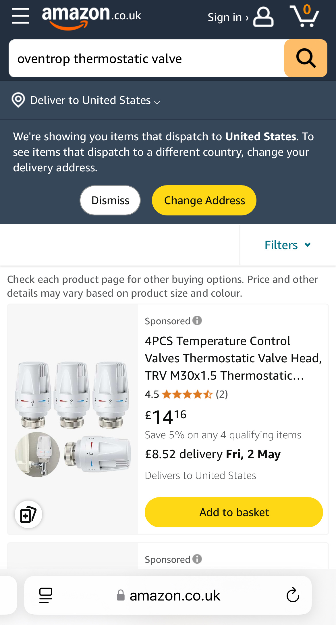

Maybe shop the Amazon UK site for Oventrop replacement parts?
