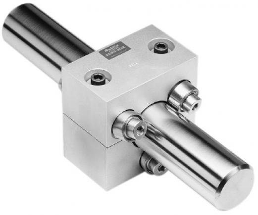

    ...... check out "rolling ring" drives on Google ..… it's an awesome and inexpensive way I'm applying the auto-tension for the loop slack take up!
    Just one drive can produce 600 lbs of pulling force! ...... all on just a non -threaded (smooth pipe tube) guide rail.
    https://www.zero-max.com/power-transmission/linear-actuators/inch-model/4110
    …… it makes "imaginary" climbing threads …. as the pipe spins.

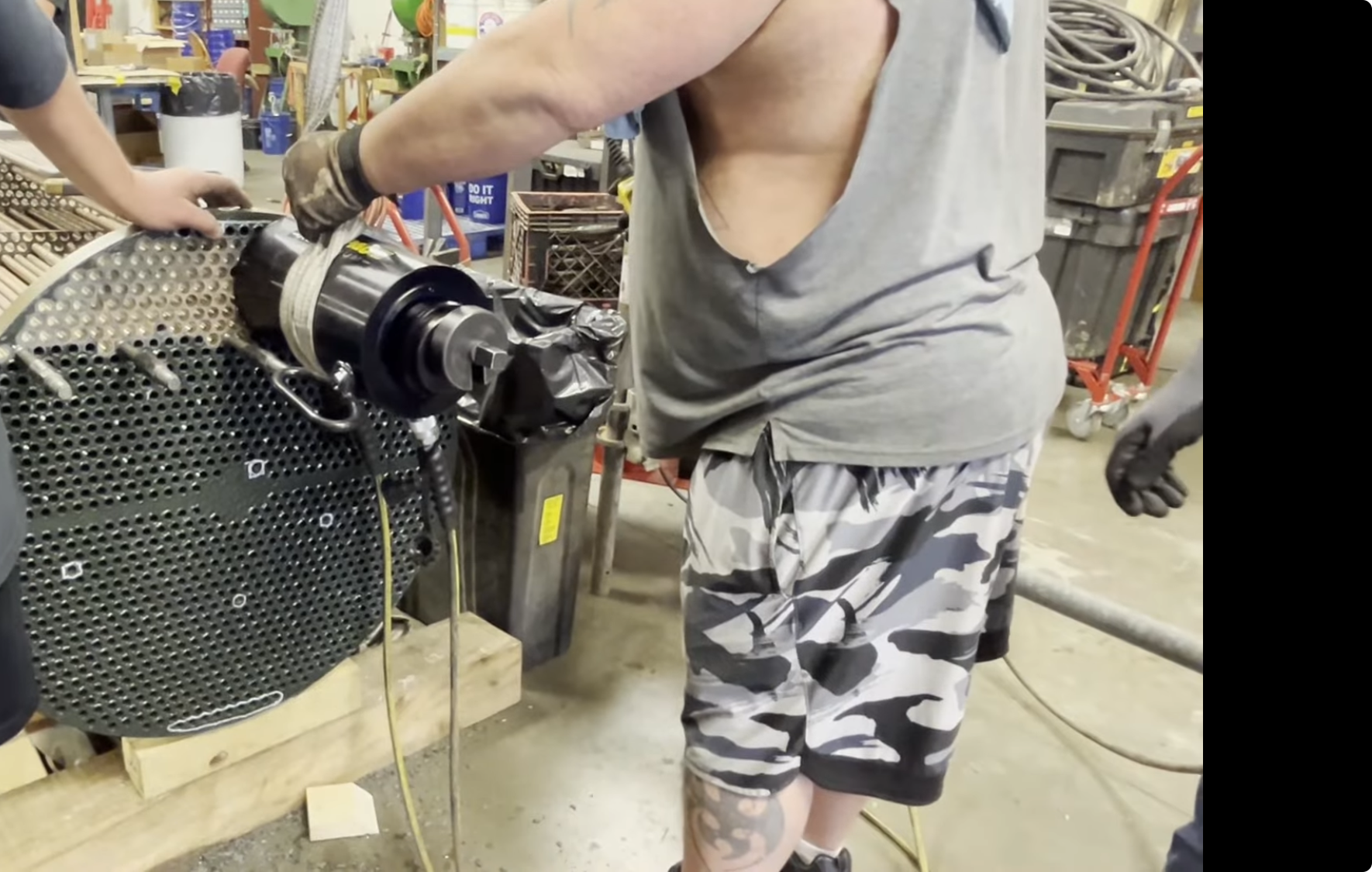

    I know your full swing into this thing but just wanted to send you this great video that actually shows a tool to cut the tubes from the inside of the pipe itself where maybe if you bust your butt cutting the flange off of one side you may be able to ream and drill out the soft copper tubes on the other side to pull them out instead of cutting through the whole tube and flange again. Maybe someone can do the reaming and drilling while you're monitoring the cutting rope. The copper is the softer and most valuable part so not sure if this is a way to kind of divide and conquer the job.
  • PeteA
    PeteA Member Posts: 271
    Not sure of your budget or time frame but I always believe in trying the right tool for the job before I go into beast mode on a project. Here's a really cool clip where a person is able to pull out the tubes using a hand tool that is designed specifically for that type of tubing pulling job.
    Here is the tool and its made in the USA so it may be available to ship depending on the size you need.
    https://tubeexpanders.com/product-category/tube-removal-tools/manual-tube-puller/manual-tube-puller-manual-tube-puller/
    Heres a video showing how a similar model works.
    Cool project whichever way you go with it. Good luck.

    That's awesome !
    .….. you do realize I have to scrap the shell and copper tubes as well?
    After slicing the flanges off ...... the copper tubes pull out with one hand!
    No tools needed!
