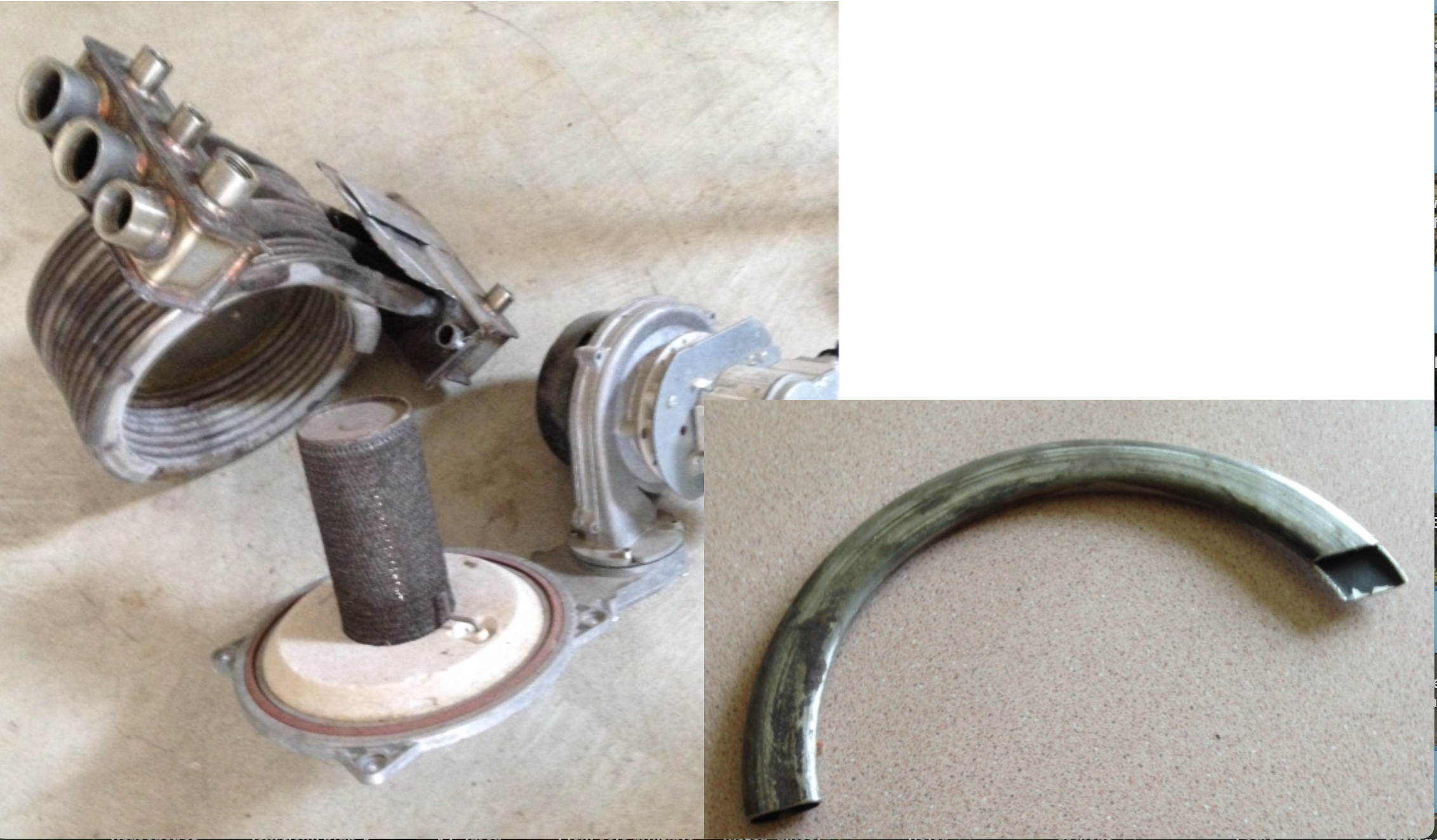

Strip away all the case, electronics, wiring and you get to the intersection of fire and water. Gas and air blend in the burner mounting passage, which is also the mounting plate for the fan and gas valve, very simple engineering. A spark starts the fire.
Properly installed and cared for this is a very durable, reliable and efficient HX design. I think easier to service compared to fire tubes, much less welding exposed to direct flame also.
This was a Knight I installed in my home many years ago. About a year into it it started throwing random low flow lock outs. I could never duplicate the issue when sitting in front of it. Checked all the typical flow obstruction issues, nothing.
Finally ripped it out, destined to be a parts boiler as I had many of this model installed for customers. I started sawing into the HX tubes on a quest for the blockage. Oddly I left that ell and nipple on the HX to clamp it into the vice, so I missed the hidden check before I started cutting.
The boiler circ was one of the early Grundfos ICFs. The first ones had a small diameter check which was not held in very well with the o-ring and plastic tabs on the side.
When I disassembled it the check had puked out of the circ and stuck in a 1" ell right at the boiler connection. It would turn to different positions in the ell, so flow would sometimes be fine.
I had filled it with good water and added Rhomar conditioner from day one.
The black you see on the tube I cut open is the film provider in the Rhomar. It looked lik a magic marker coating inside the tubes, very thin layer of color. This protects the stainless from aggressive fluids, low ph, or high chlorides in fill water without much if any heat transfer penalty.
I've been sold on boiler conditioners ever since.
