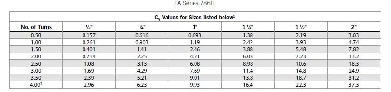

    EBEBRATT-Ed, so what is the Cv rating for the 1-1/4 circuit setter? Not great at reading graphs.
    For example the regular Victaulic 1-1/4" blanacing valve is 16.4CV which may create problems for my monoflo system especially if i use zone valves which are under ~10CV
    You guys see any problems with using a 2" balancing valve on a 1-1/4" pipe?
    2" has a very high CV, and can throttle quite a bit, i would only need to throttle maybe 10%.
    The lines are the settings on the dial so at fully open the Cv is about 13 for a 1.25" circuit setter
    I would just use a ball valve instead of spending $300 on a circuit setter and plumb it in such a way I could substitute or add a globe valve for the ball valve for one of them once I figured out which half needed to be throttled.

    That's what those lines mean haha. Ok, 13 is pretty low though.

    a Cv of 13 is about 130,000 btu at a delta t of 20f assuming 13 gpm and 1 psi drop at the valve.
