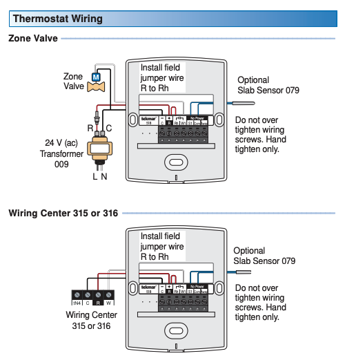

Hi all. I replaced my old Tekmar 508's with the newer 518's. Seems the pulse width modulation is causing this thermostat to kick on my in floor heating system almost non-stop (stacking). The hot water heater is cycling on and off. The 508's ran more stable but still stacked, which is funny because I got the 518 as i was hoping it would be even more stable. Unfortunately it's very much not.
The funny thing is it's almost like the 518 can't reach it's setpoint. Even with the system running almost non-stop, the feedback temperature on the display has dropped. I don't see how tho, I'm inputting a major amount of heat into the slab.
Just keeps going and going an going. T-stat was installed this morning.

Is it wired like one of these diagrams?

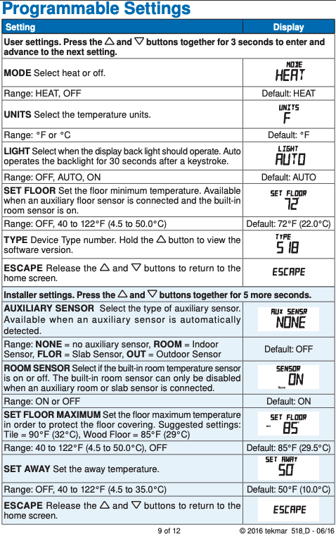

What does the screen display? It tells you what mode the stat is in.

Hi again, forgot I posted this. Yes there was a resolution. Wiring was fine. No issues there. I had it set to Air and Floor sensors. I removed the air and just ran the floor. PWM did it's thing fine after that. It kicks on twice per hour and runs for 2.5 to 4.5 mins. Slab temp setpoint is 25C and room temp above the slab is 21.5 to 22C.
