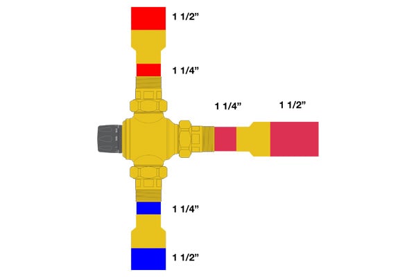

Pro Tip: Size the valve by the flow rate required, not the pipe size of the valve. Most times you can go a pipe size or two smaller with a properly sized digital because the flow path through the ball element is less restrictive than a bigger brother thermostatic. Here are a couple of examples of what that could look like:
Mixing Valve Downsizing Example 1
Mixing Valve Downsizing Example 2

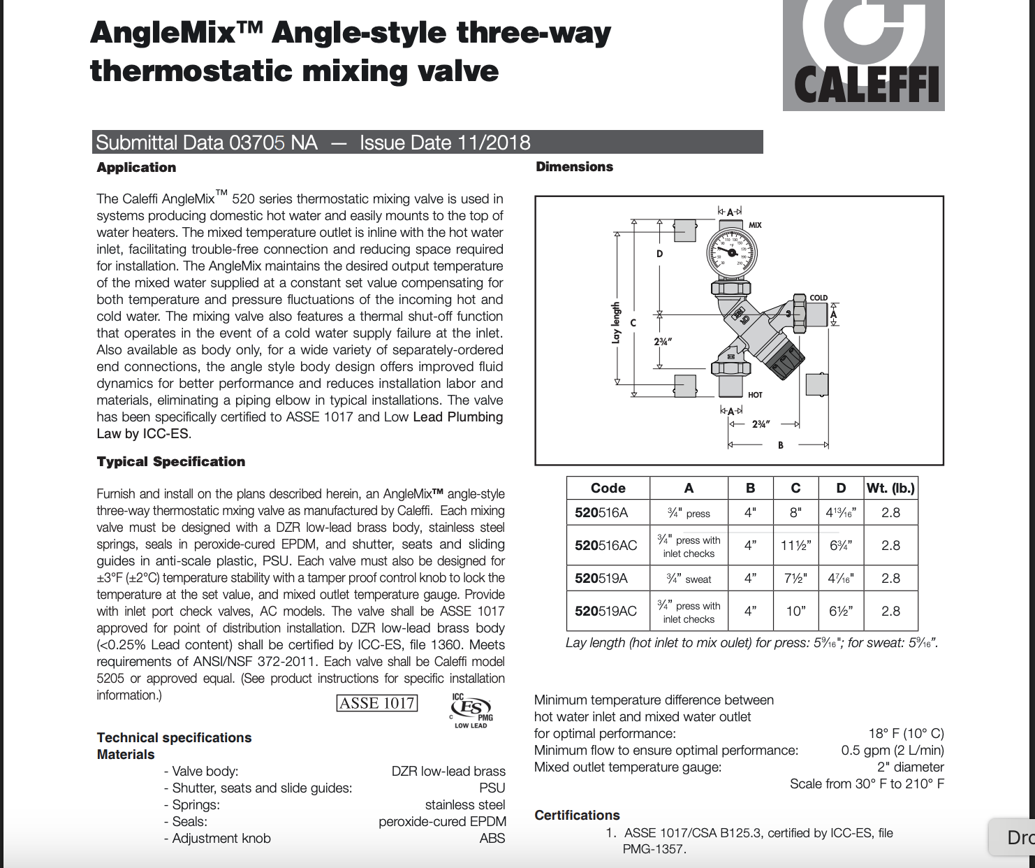

    hot_rod Posts: 28,699
    The smallest Legiomix is 3/4" it needs 2.2 gpm minimum
    The 520 AngleMix needs .5 gpm, but it is a wax cartridge type valve. I don't know of any thermostatic that works with less than .5 gpm.? There needs to be turbulent flow around that wax cartridge for it to move properly
    If you have a dhw recirc, that is another way to meet the valves minimum. Although 2.2 gpm would be a large recirc system.
    The 3/4 LegioMix with that high Cv is probably a very large multi bath home, small motel application.
    The thermostatic is a dependable valve, but needs cleaning occasionally with hard water.
