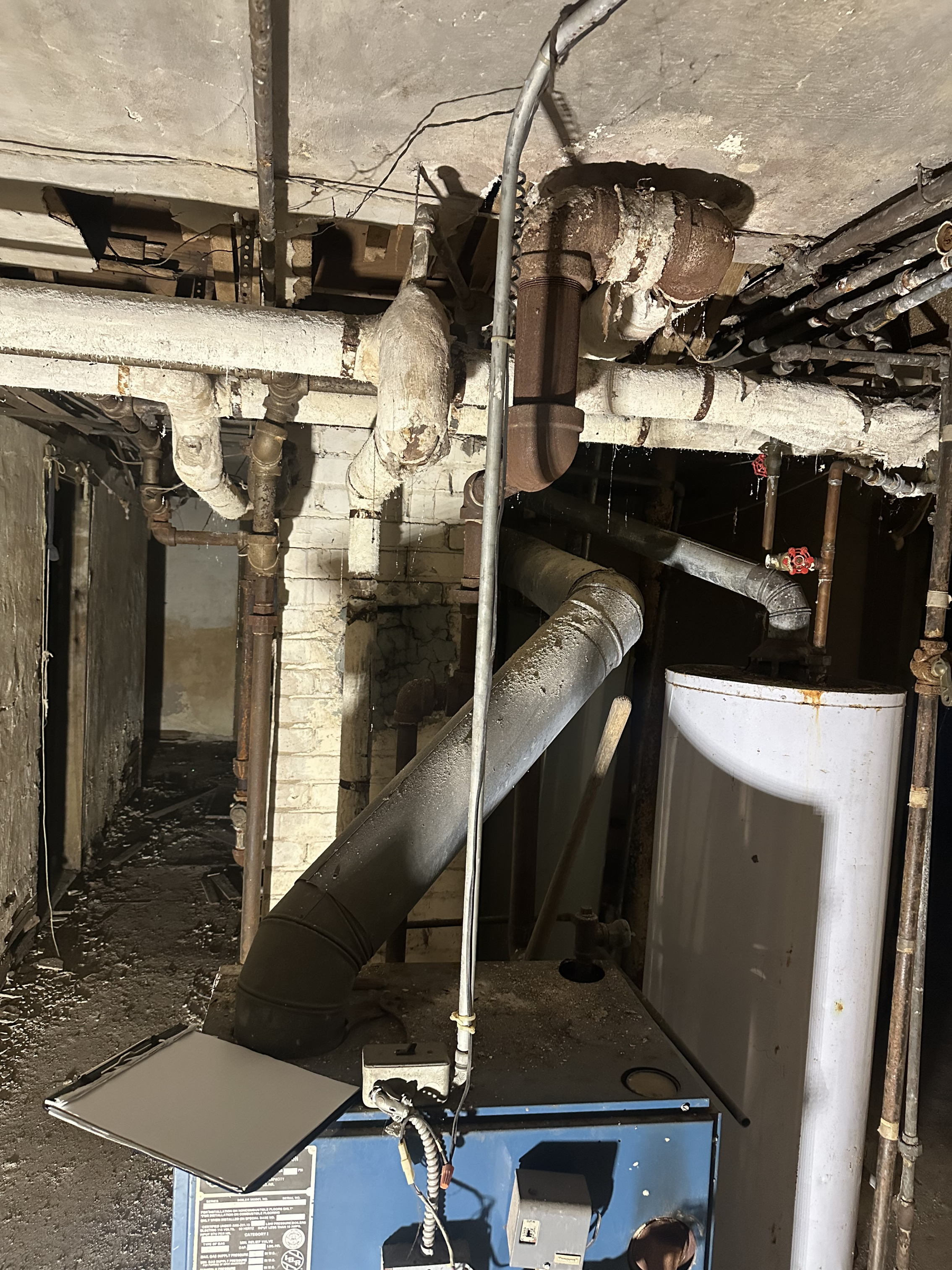

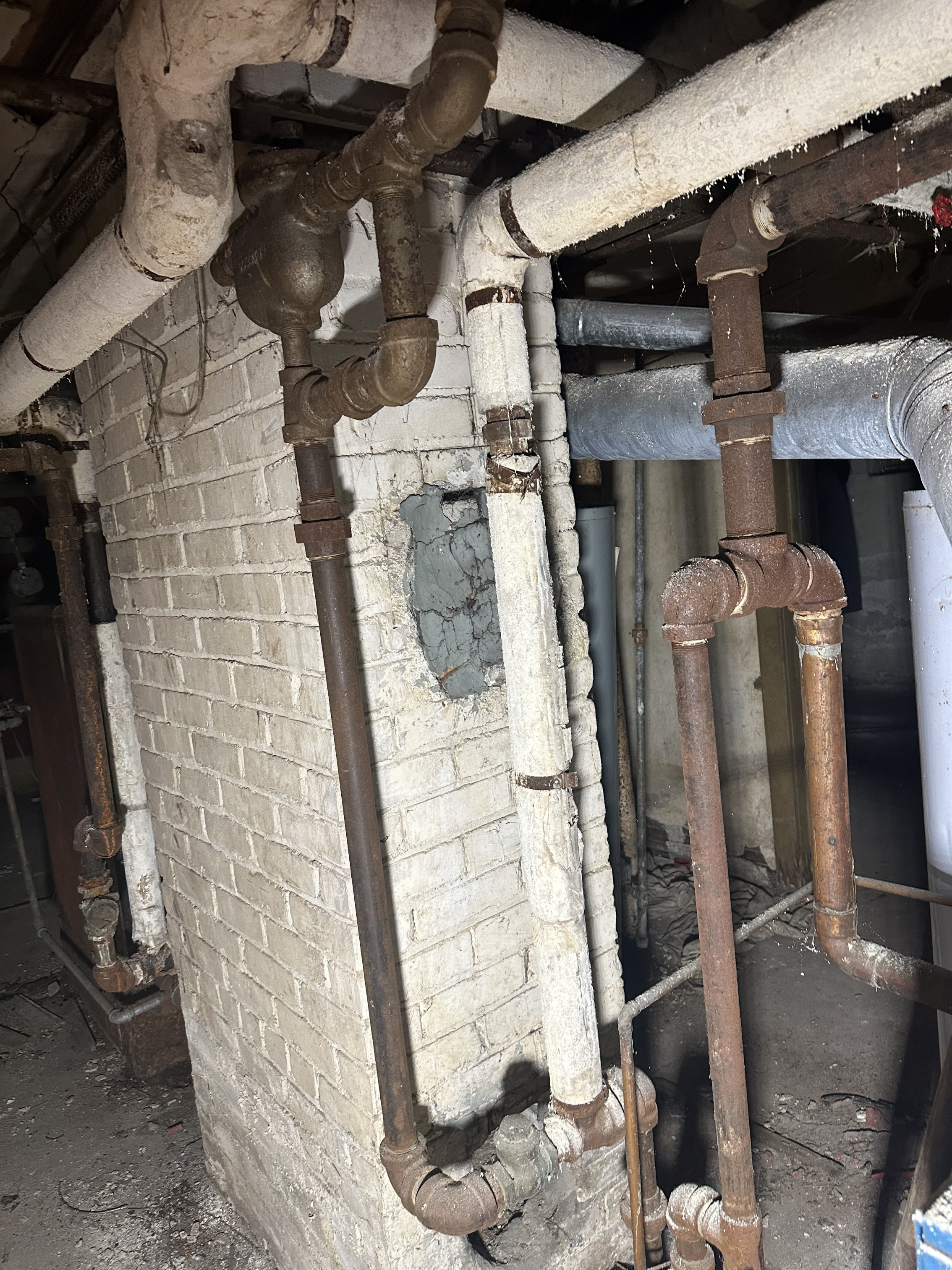

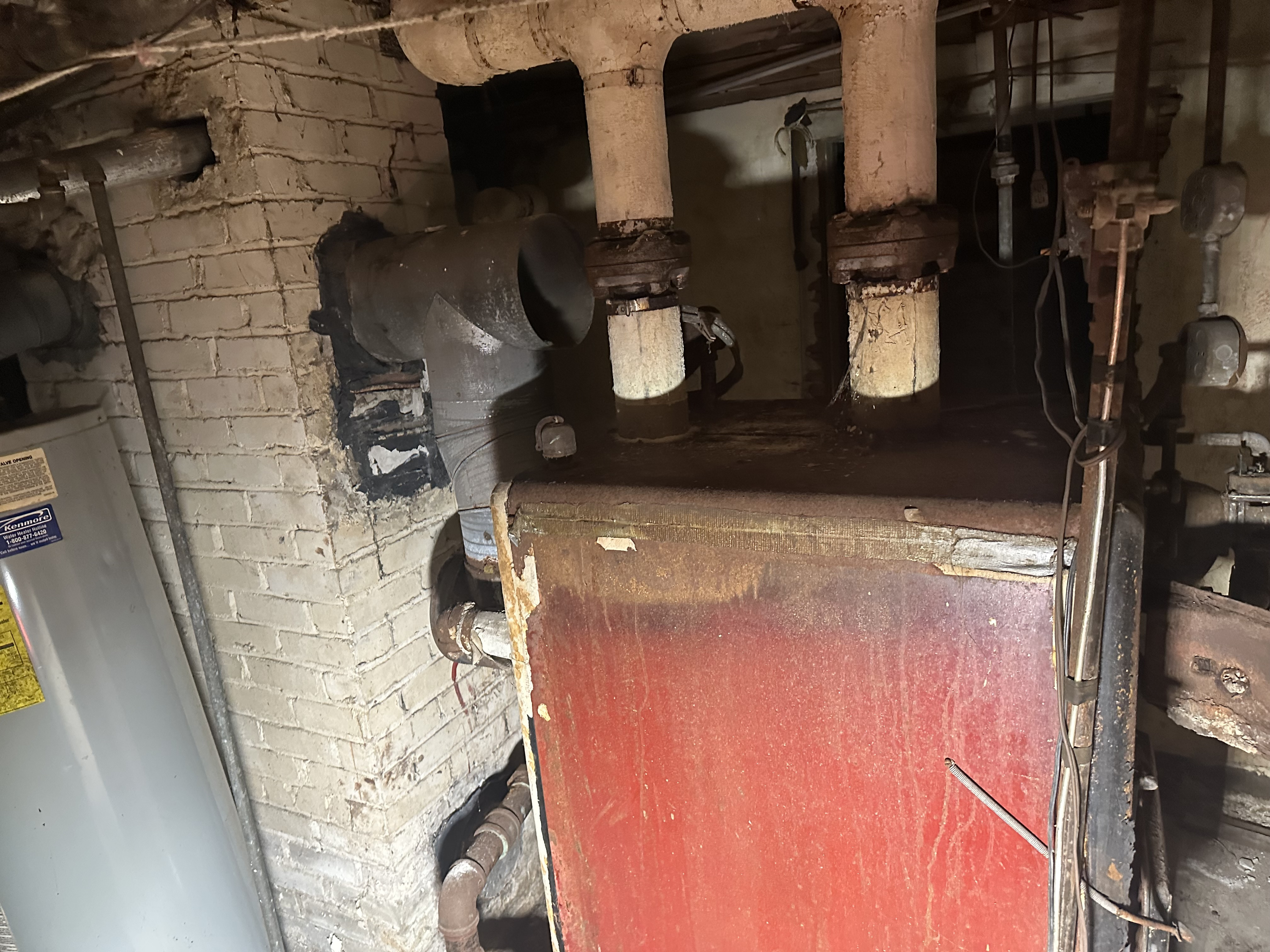

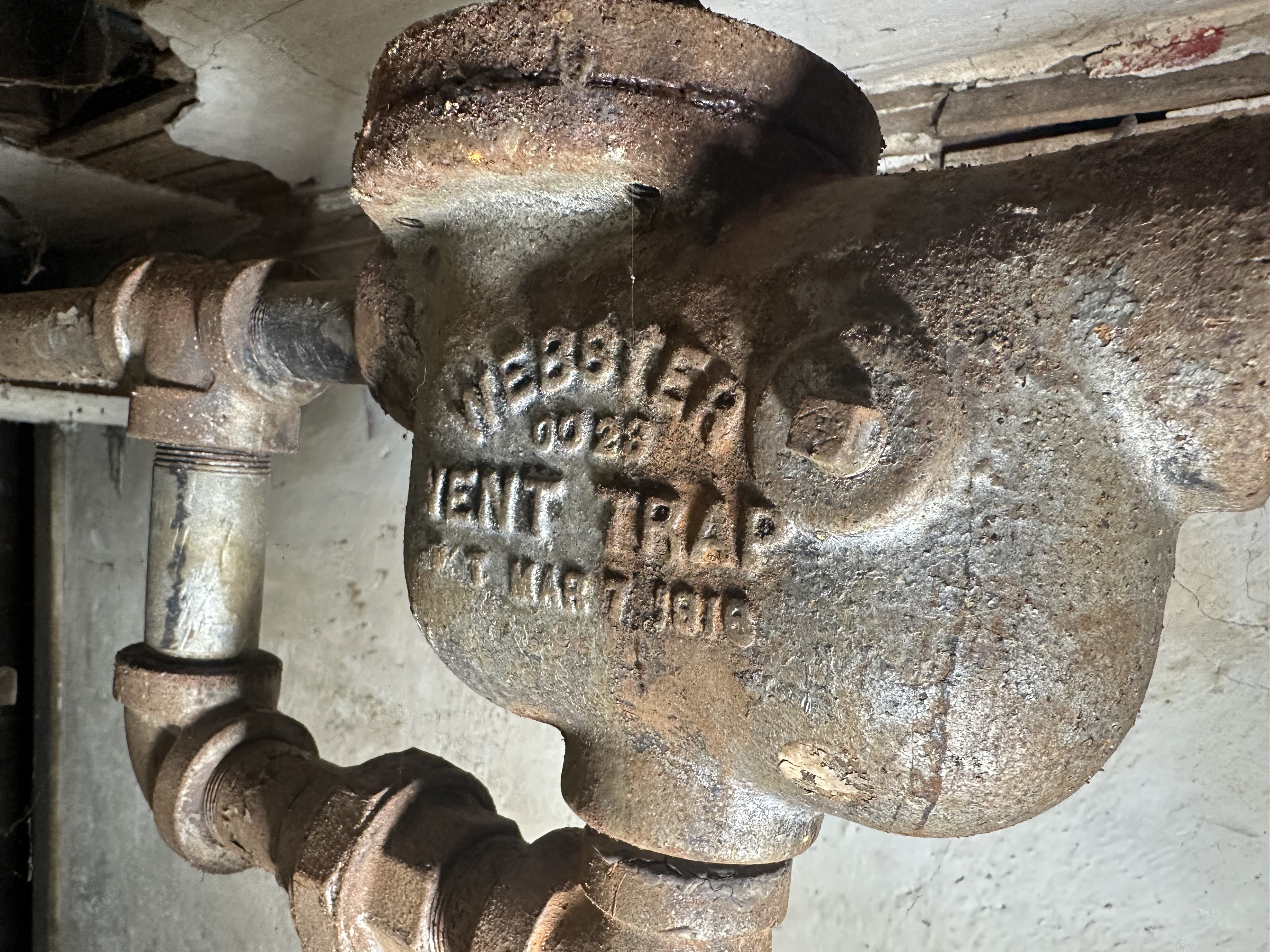

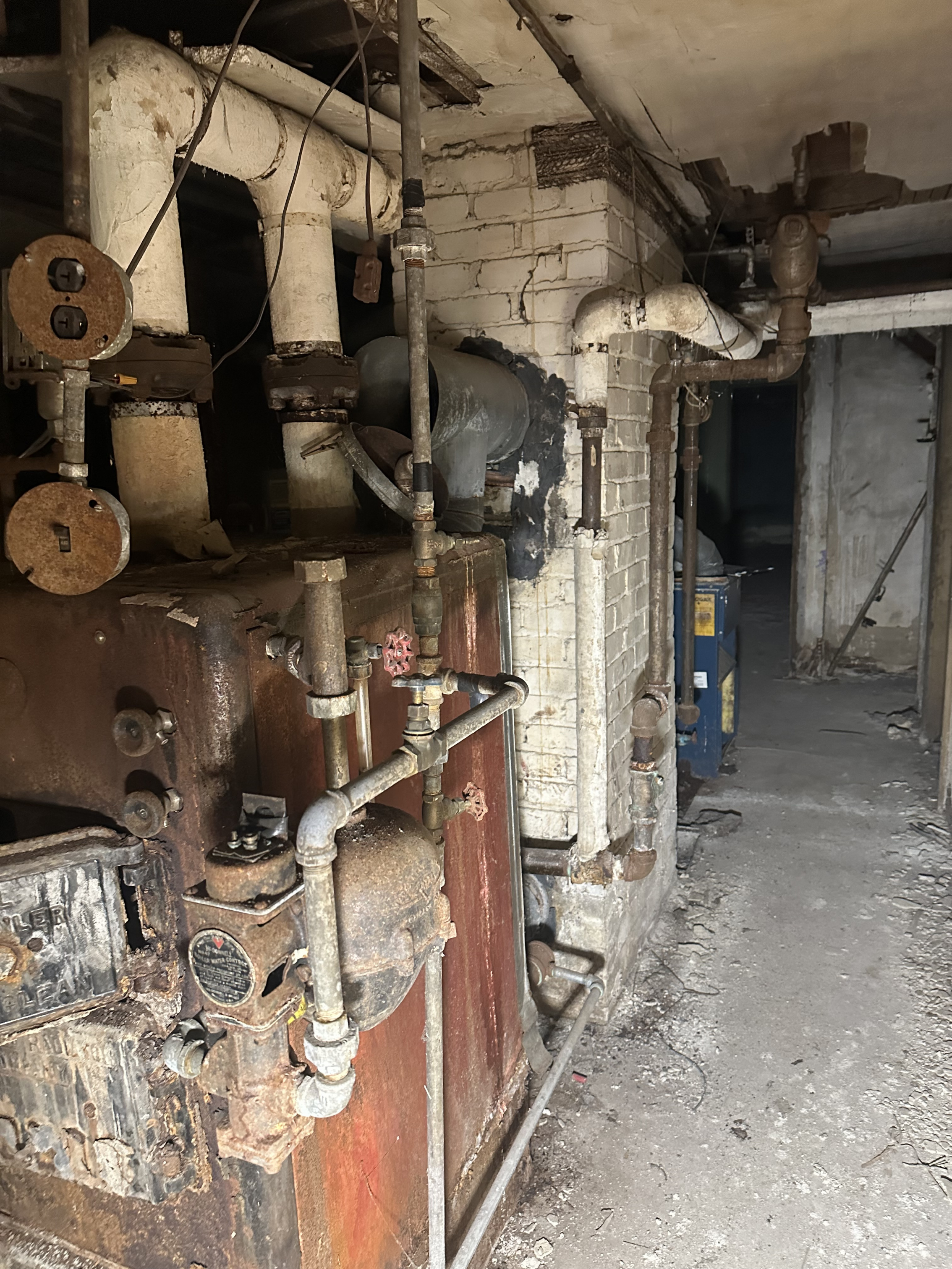

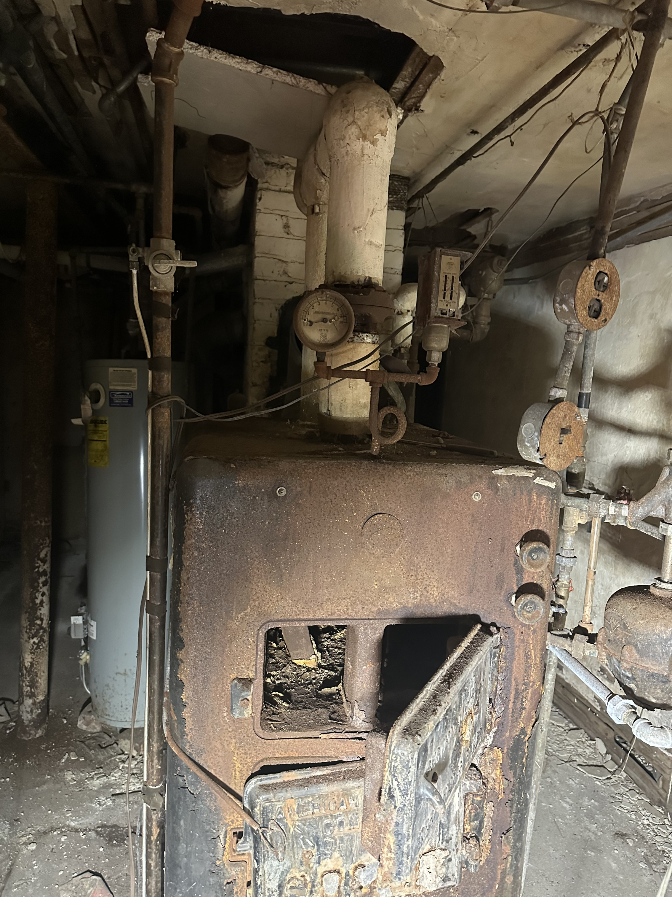

Got a call from a customer that put purchased a two flat home and they were starting to restore the home. Talked to the customer who informed me they needed new boilers and wanted to keep the steam system. Go take a look and found a cool Webster system. The boilers have seen better days to say the least, but all the radiators are surprisingly in decent shape. We are going to reevaluate the system once they get asbestos removed and the basement ceiling. This one's going to be a fun project to bring back to life.

    Very cool. Don't see a boiler return trap, must have been gas/oil a long time.
    One boiler per apartment?
    mattmia2 Member Posts: 17,756
    Are there really 2 separate, complete systems there?
    Looks like that basement has been very wet.
    The "ceiling" probably is or at one time was required fireproofing.
    Steamhead Member Posts: 18,771
    The Webster "Modulation" system didn't use a Return Trap. The "Type R" system did. Both used Vent Traps.

    Yes it was two separate living spaces. 2000 sq ft 1st floor and the same for the second. Customer is making the whole building one house. The plan is to keep the two boiler systems. They plan on doing the first floor, living there while the 2nd is being worked on. Once the ceiling comes down we can trace the pipes out to see what boiler did what floor. The 95% of the radiators have the Webster Vari valve on the steam supply. All rads have traps that need to be refreshed. Luckily it looks like the vent traps and condensate hasn't been butchered.

    If I read the boiler door correctly it is an original American Radiator Company coal fired boiler.

    That's correct it's an ARCO coal fired boiler. Most of the homes in the area had them. Converted to natural gas years ago. I've found a few that went from coal to oil to natural gas. The asbestos appears to be intact aside from the near boiler piping. The customer is getting the environmental contractor to deal with that issue. In a holding pattern for now just waiting in the que.

    I have owned houses in which the original steam systems had been completely removed and replaced with boring hot water baseboards. In your photos, the newer boiler (last image foreground) appears to be a hot water system added at a later date. Are the original radiators being used on that loop?
    It is steam trim, it has a pressuretrol although the near boiler piping looks…interesting.
