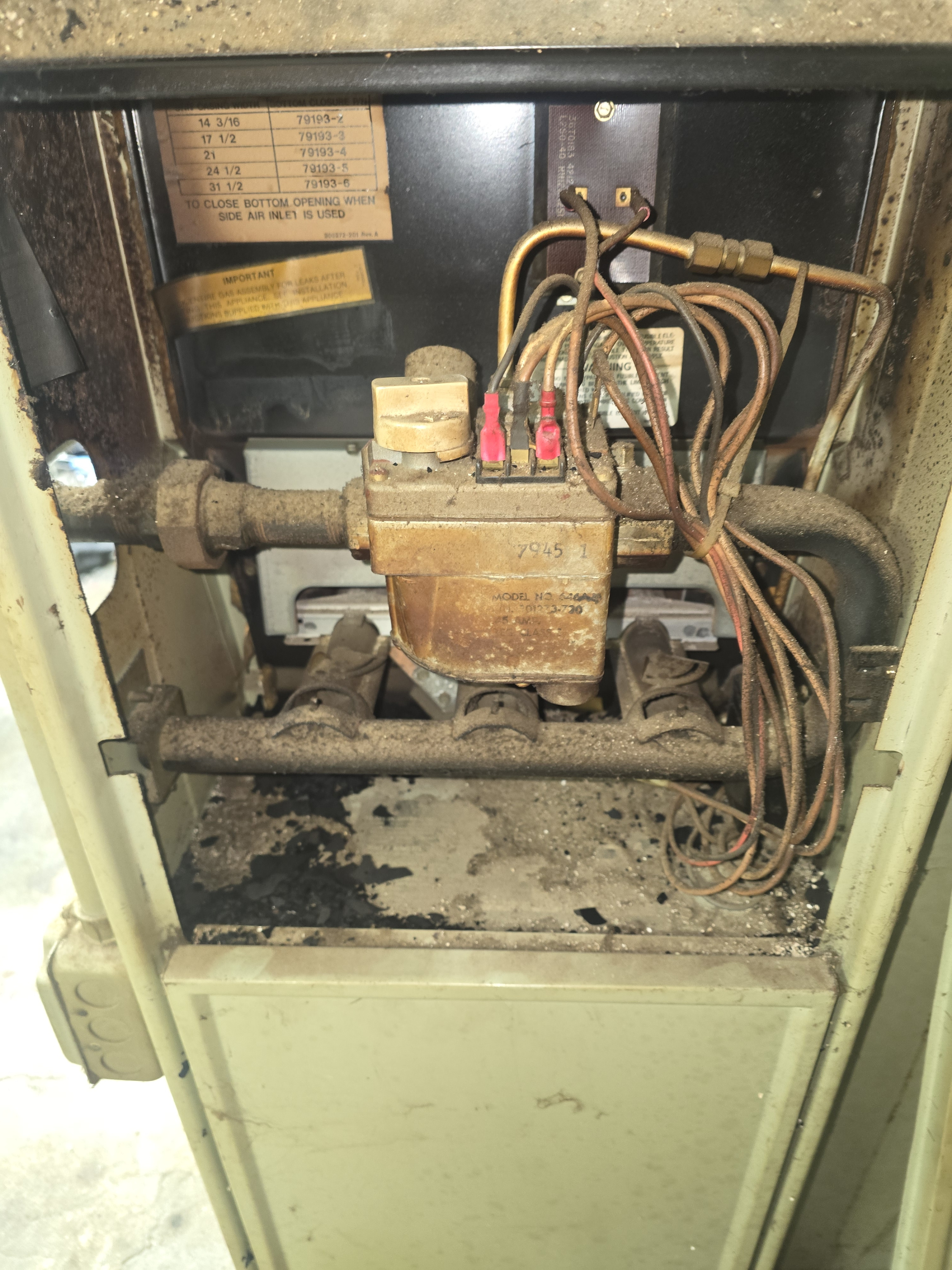

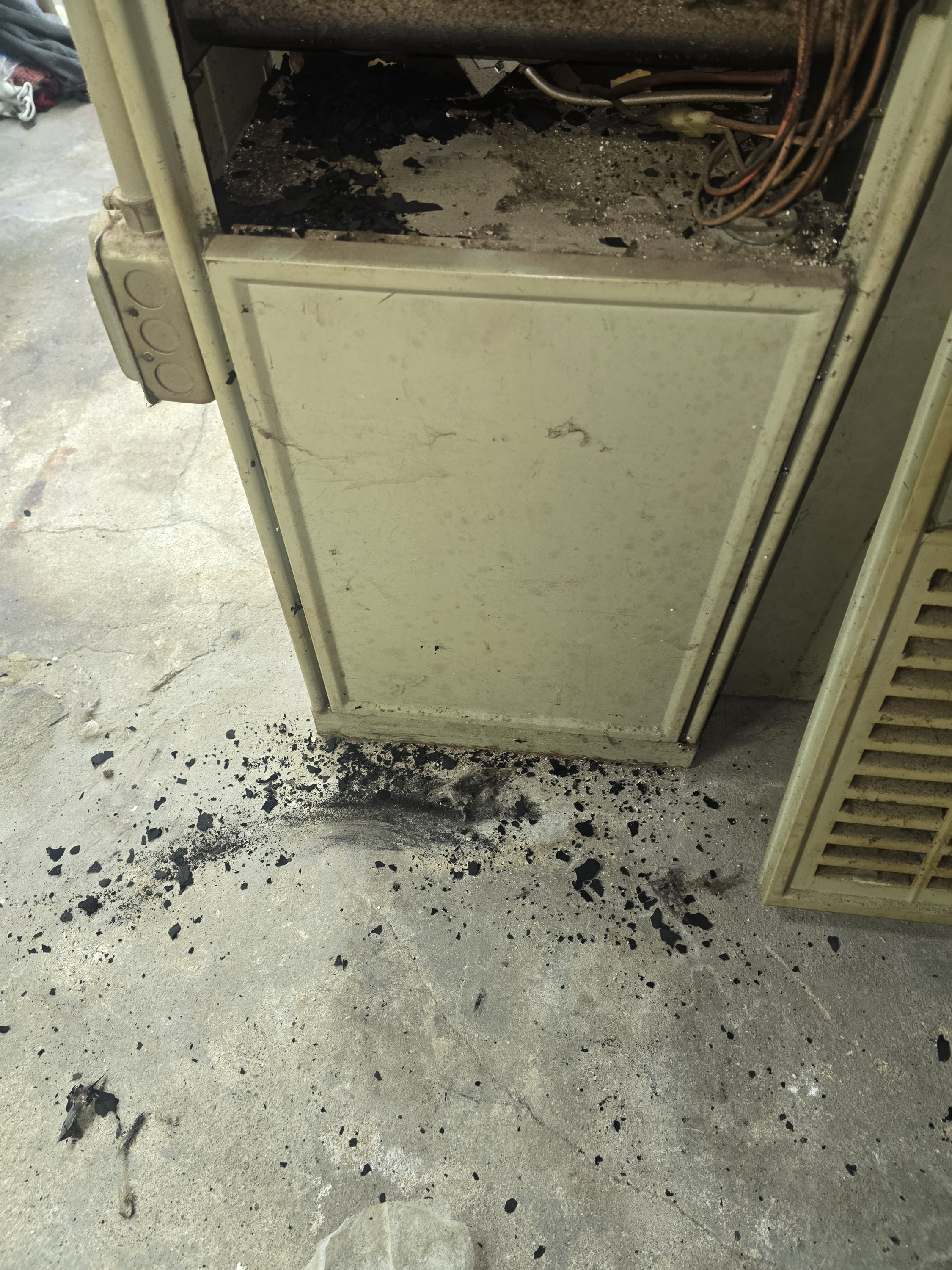

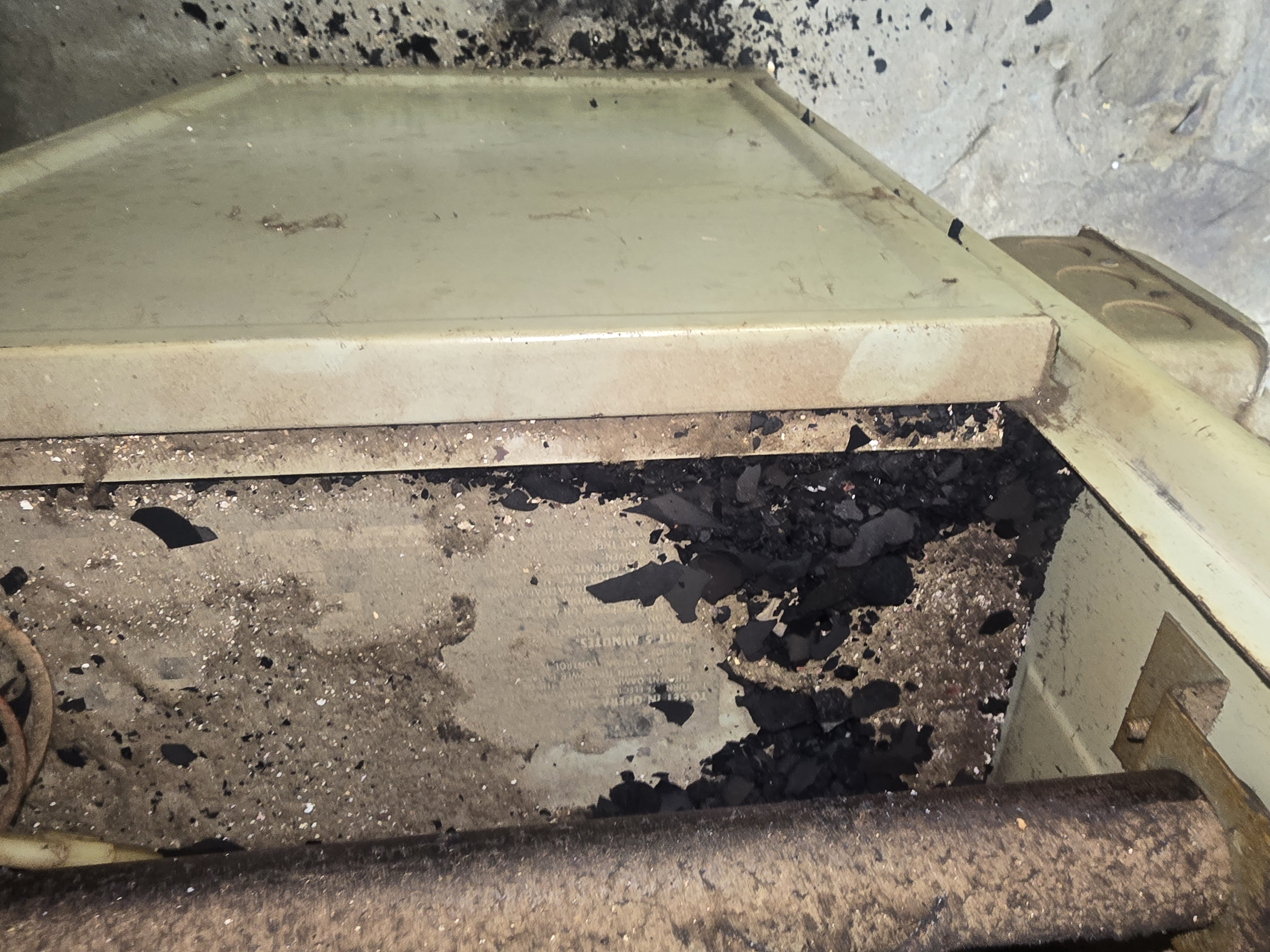

Got a No Heat call from a close, personal lifelong family friend whose Elderly sister & younger brother still live in this 1910 Ozone Park home. Our beloved old neighborhood. I practically lived in this house growing up and I remember the big old steam radiators.
At some point in the 1980s their father ripped it all out, had duct work and a gas Furnace installed. I don't think it was ever serviced. Since I don't do furnaces or ductwork, I rec'd a great local HVAC outfit, Lindenwood & AC.
The founder Richie D lived directly behind us and did all the houses on.the New Side of Howard Beach in the 1960s. They did a great job & had it replaced 2 days later. Mad Dog

    what did the hx fail and the rollout from the blower do that?

    That model furnace, the ribbon burners probably rotted out and then sooted up.
  • Mad Dog_2
    Mad Dog_2 Posts: 8,755
    Matt..I don't know because I'm not a furnace guy and I didn't do the replacement.
    When I originally went there I was working "naked" (No tools) on my way home from the Big City. When I saw this, I shut the gas cock, AND knob on gas valve to off. I shut service & Stairway switch & in no uncertain terms I told my buddy, "DO NOT RUN THIS...IT S DONE AND COULD KILL EVERYONE IN THE D—-house! I'm gonna find you a Furnace guy....."
    A few hours later he sends me a video of the unit running..."Look..Matt...it's a beautiful blue flame!!!!...I vacuumed the soot..I think we're good!!"
    Moral of the story: Dont EVER trust anyone, even a "brother" to not listen do deadly things....mad Dog
